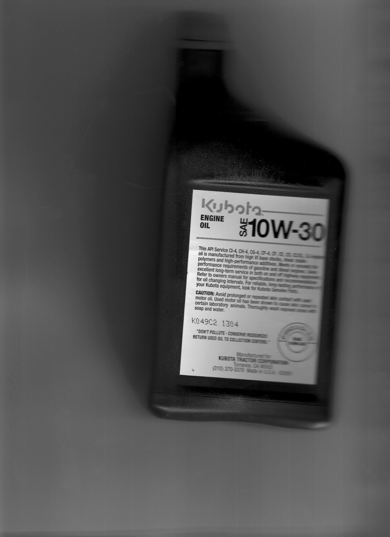

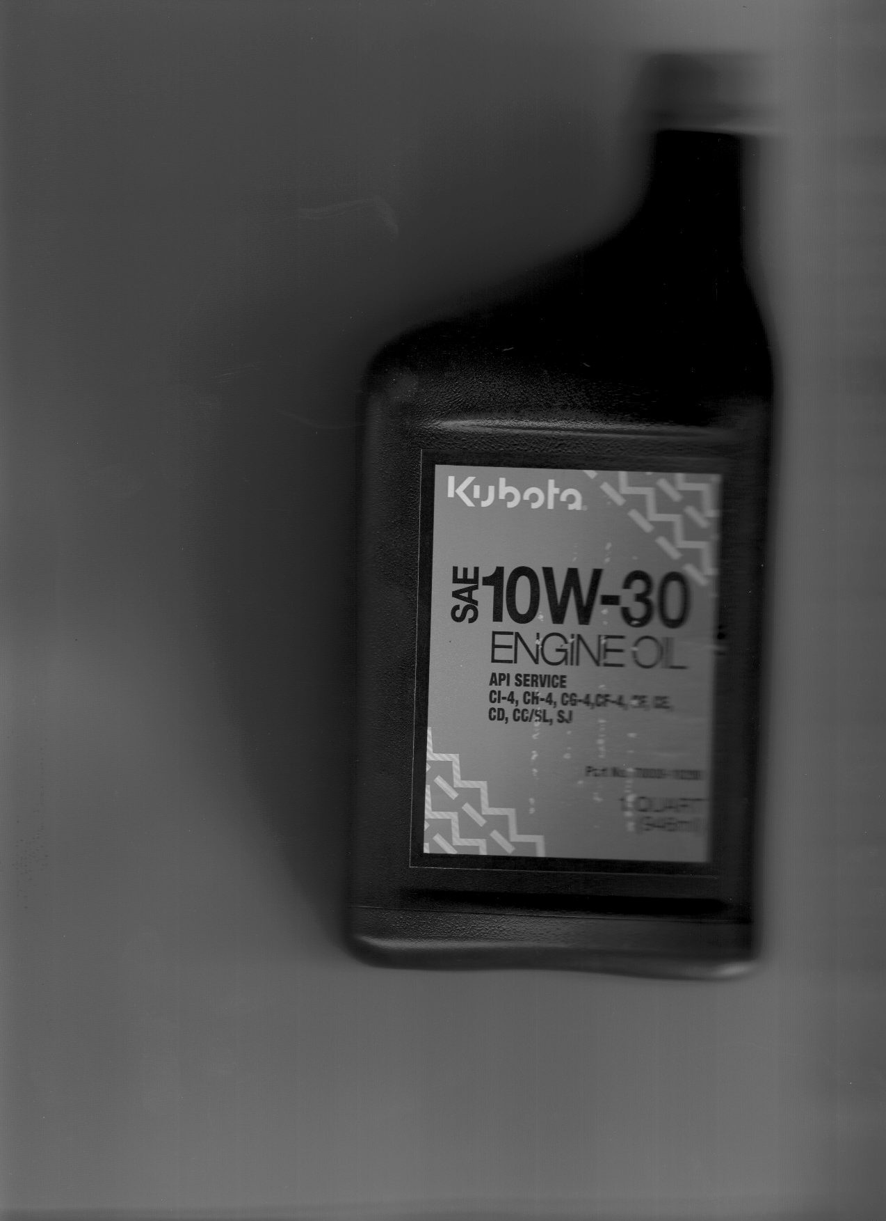

   / sc2400 oil #4
The API rating of Kubota SAE 10W-30 oil is:
CI-4, CH-4, CG-4, CF-4, CF, CE, CD, CC/SL, SJ
These were written on the front and back of the container.
