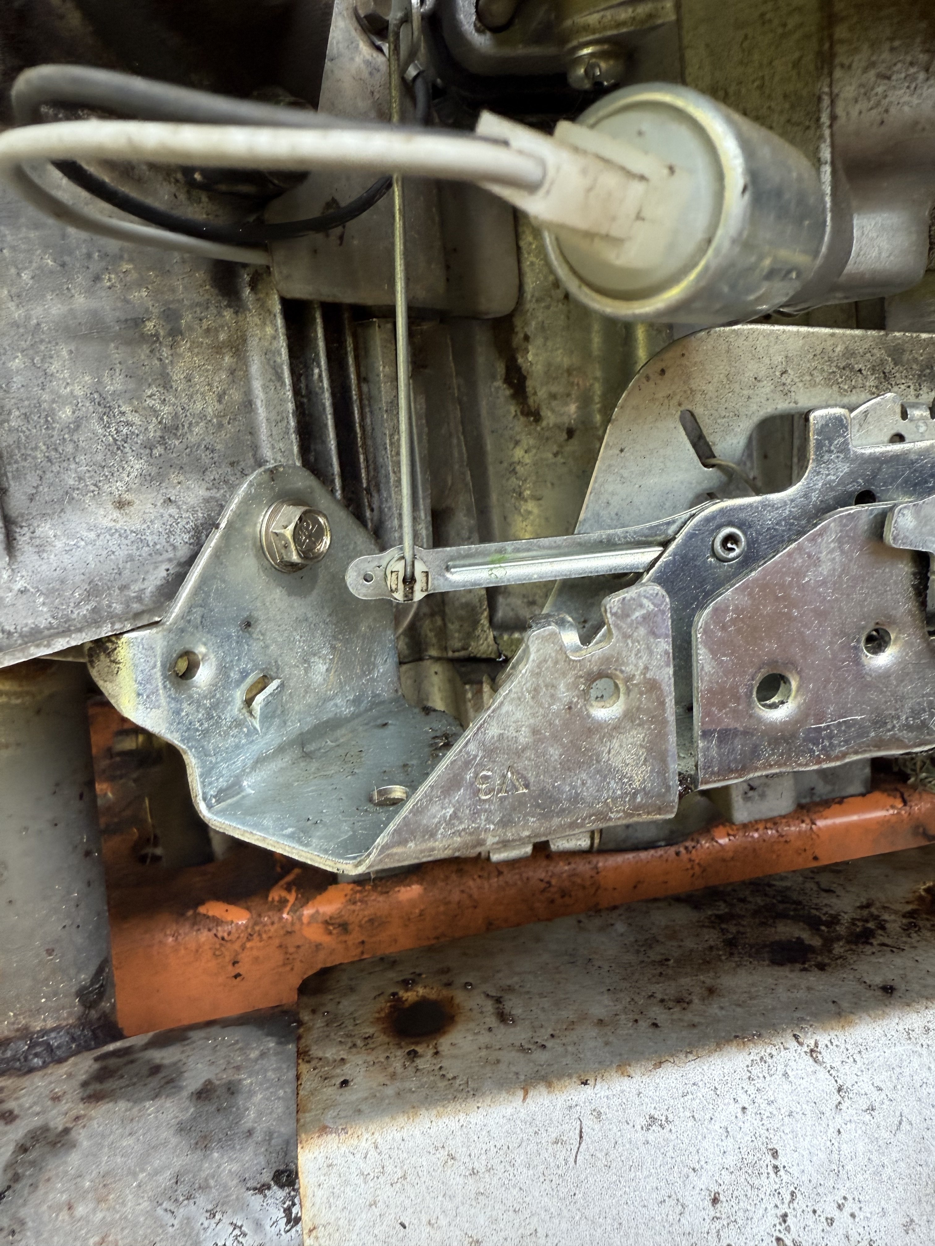

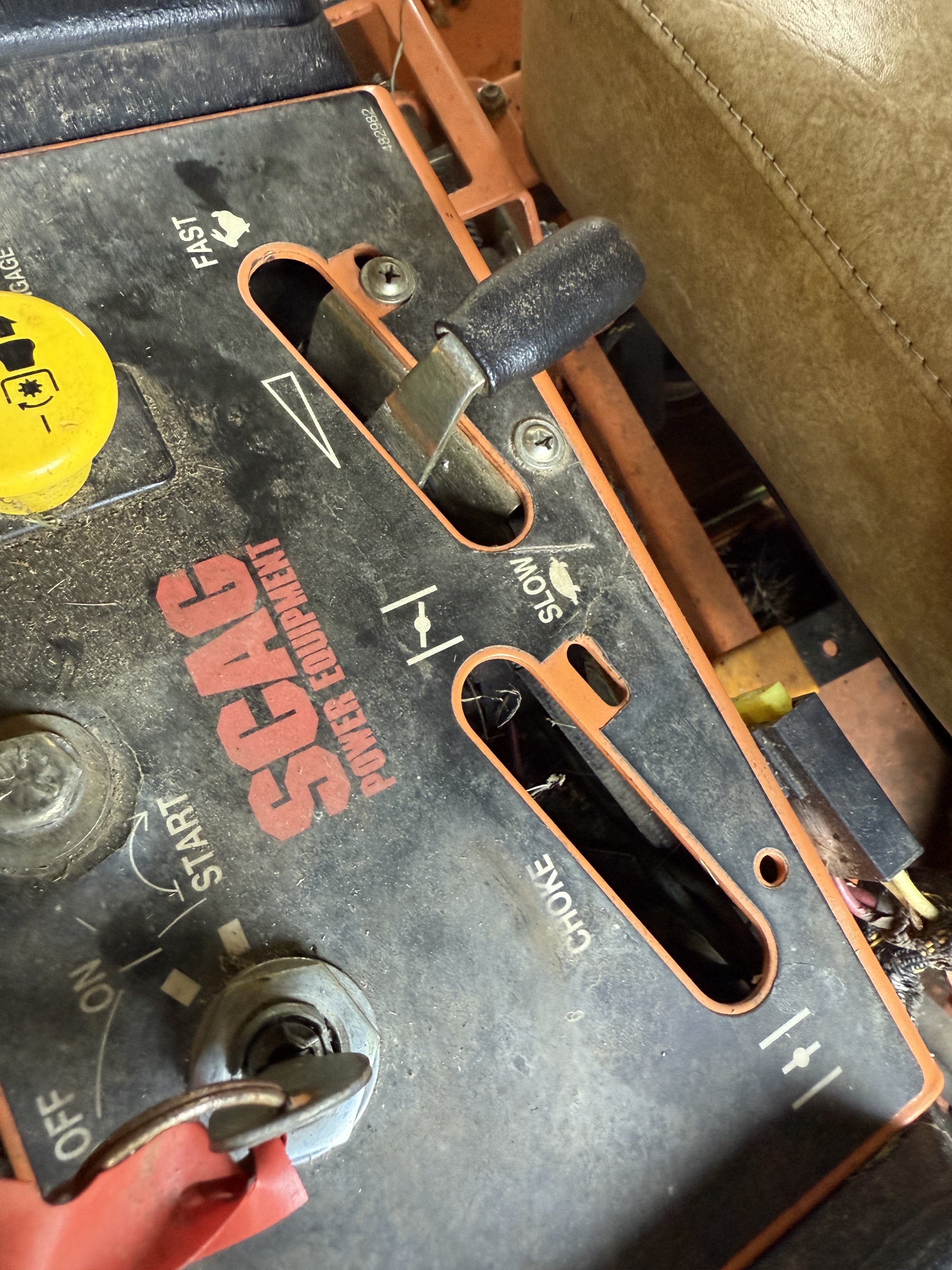

Hey guys, I will add some pictures tomorrow. Long story short. Got a free tiger cub. Has an almost brand new Briggs & Stratton 27hp professional motor on it. Really solid machine. Some how someone removed the chock lever and integrated it into the throttle lever. Why would they do this? Is it because the original engine wasn’t a B&S so there were some compatibility issues? So now all the way forward would be choked and slightly back would then be full throttle. It had new coils put on it last year. But it’s running rough. Under powered and spits like it’s choked. I’m slightly mechanically inclined and can get things done once you kind fellas point me in the right direction lol. I’m going to check the rpms tomorrow. But not sure what to do otherwise. Should I try to figure out how to get a real choke lever back in there? What kind of pictures do you guys need to be able to help? Thanks in advance.
/ Scag tiger cub running rough #2
For most of the Briggs engines, there are multiple throttle plate options. So look up your engine and see if you're able to swap it over to a throttle plate that would be more compatible with your mower controls.
That said, just stopping the throttle short of the position where it closes the choke should work as a temporary measure. The Briggs Intek on my log splitter has this type of throttle plate, and I just throttle it up to where the throttle arm touches the choke actuator, but doesn't depress it. That's easy on a log splitter, but maybe not so easy with the engine hiding behind you on a mower.

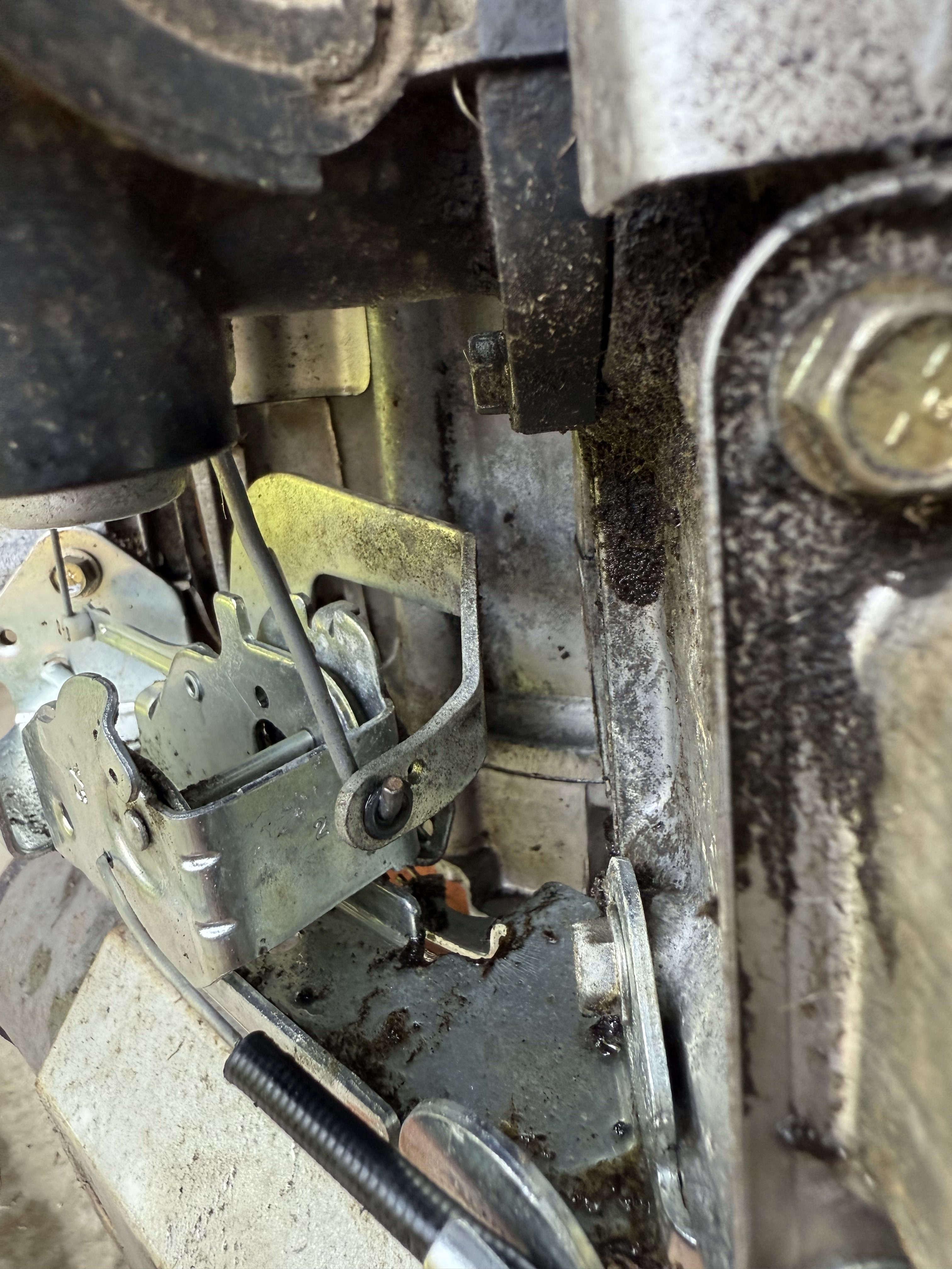

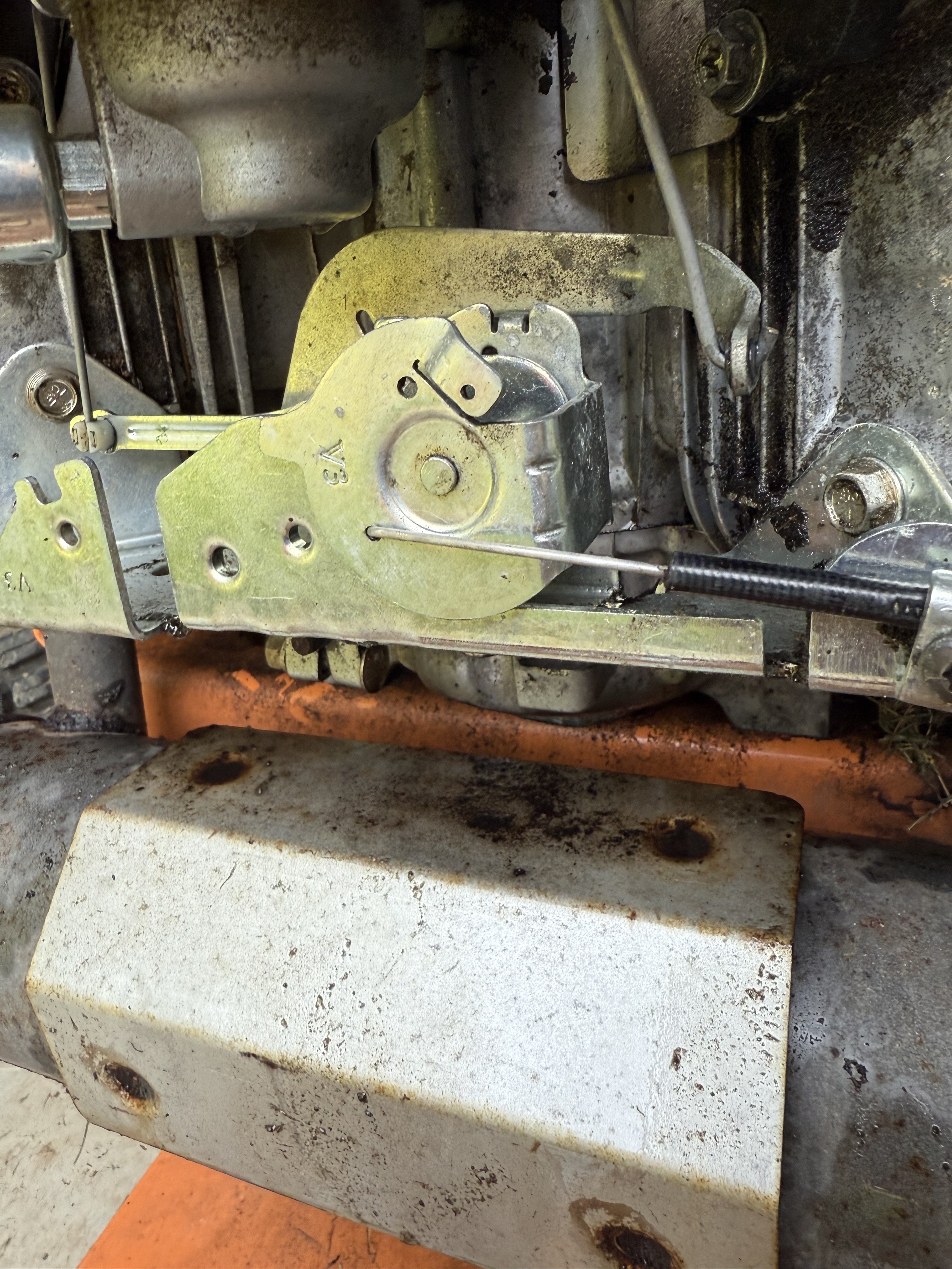

Could be the engine has some other problem, but before diving into that, it’d be good to at least identify the linkage components and what they do, so you can determine when and where in throttle movement range the choke is closing.
/ Scag tiger cub running rough #5
There might or should be adjustment on when the throttle engages the choke. You want engine at full RPM before choke is engaged. Some models had a little lip or detent so took a little extra push to go from throttle to choke.

If my memory is correct there was more than one option on how the choke and throttle were integrated. Can you see what activates the choke? That is were I would start looking to see if there is some adjustment screw in that linkage assembly to allow throttle to rev higher before activating the choke.
Otherwise possibly take some pictures of that linkage assembly and that might trigger a memory for someone.
I think some of the older models also had a metal arm that you bent slightly to adjust when choke was activated.

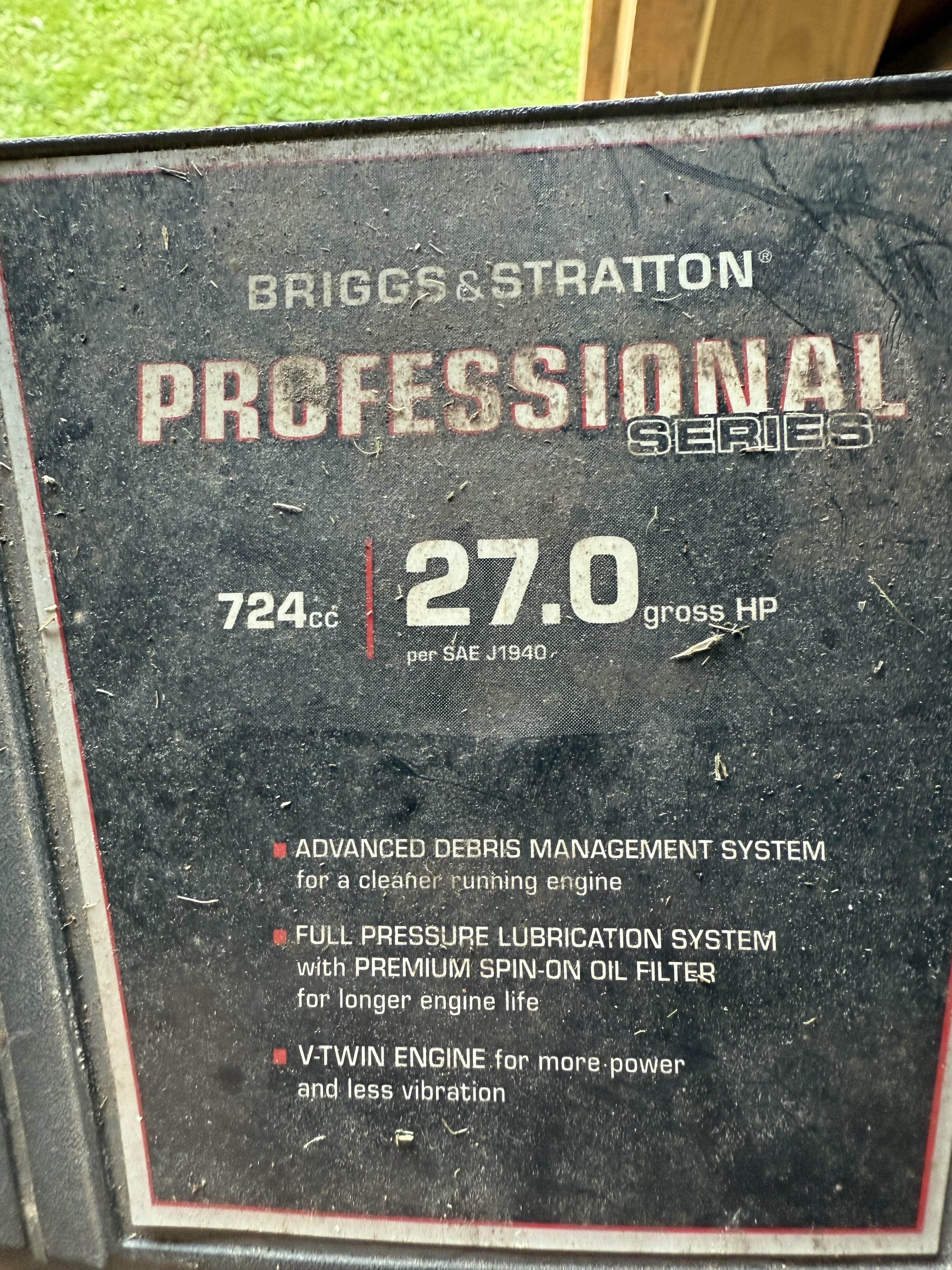

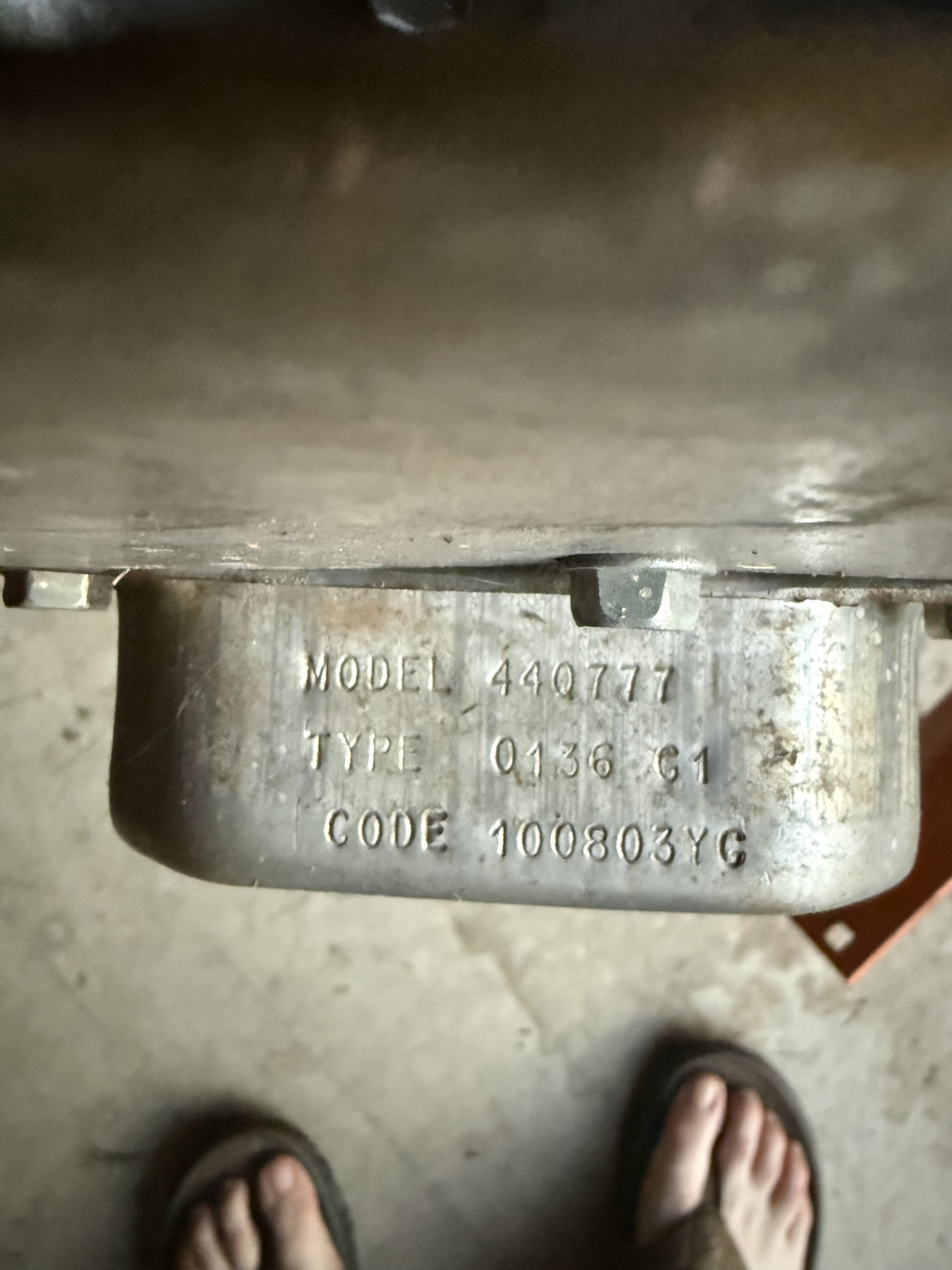

There should be a sticker on the side of the engine cowling with an actual engine model number, probably the same label containing the serial number. That's what the Brigg's experts will need to identify the spec'd RPM for that engine, as well as the throttle plate and choke options.

Sorry about that. Don’t mind my horrific looking toes 🤣
/ Scag tiger cub running rough #15
Engine model number is 44Q77-0136-G1, it's a very common model, and in fact I think OEM on some Scag models... not that I'm any Scag expert.
Damn near every site that lists that motor claims a different max RPM, but most seem to be either 3350 or 3400 RPM maximum. If this is the OEM motor for that mower, then the shop manual should have a detailed procedure on how to set low and high idle speeds. You'll need a tachometer, but you can pick them up cheap on Amazon.

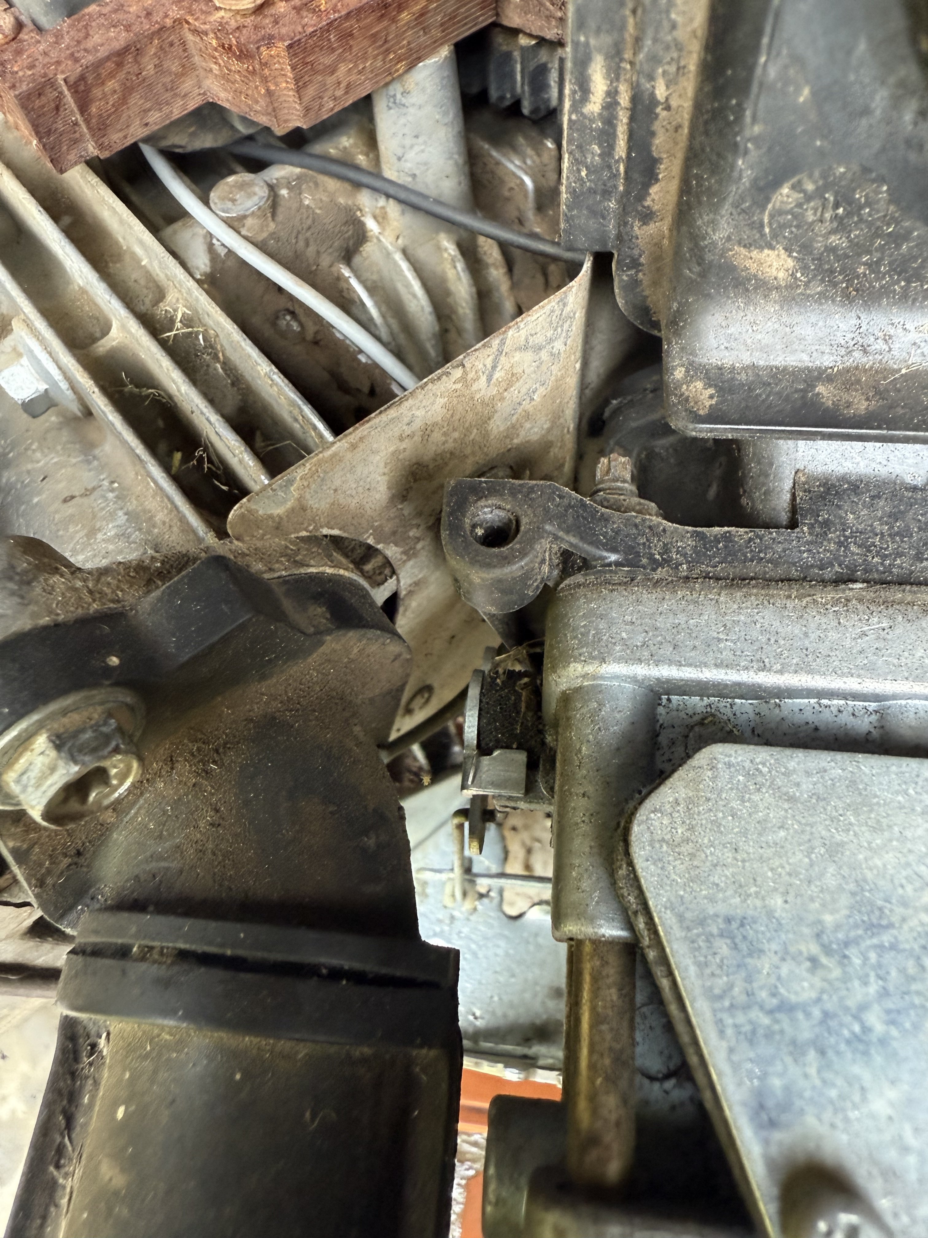

I disconnected at the carb and cranked it and it’s pushing plenty of fuel. That pulse line is in rough shape though, not a great seal at the bottom? Thoughts?
