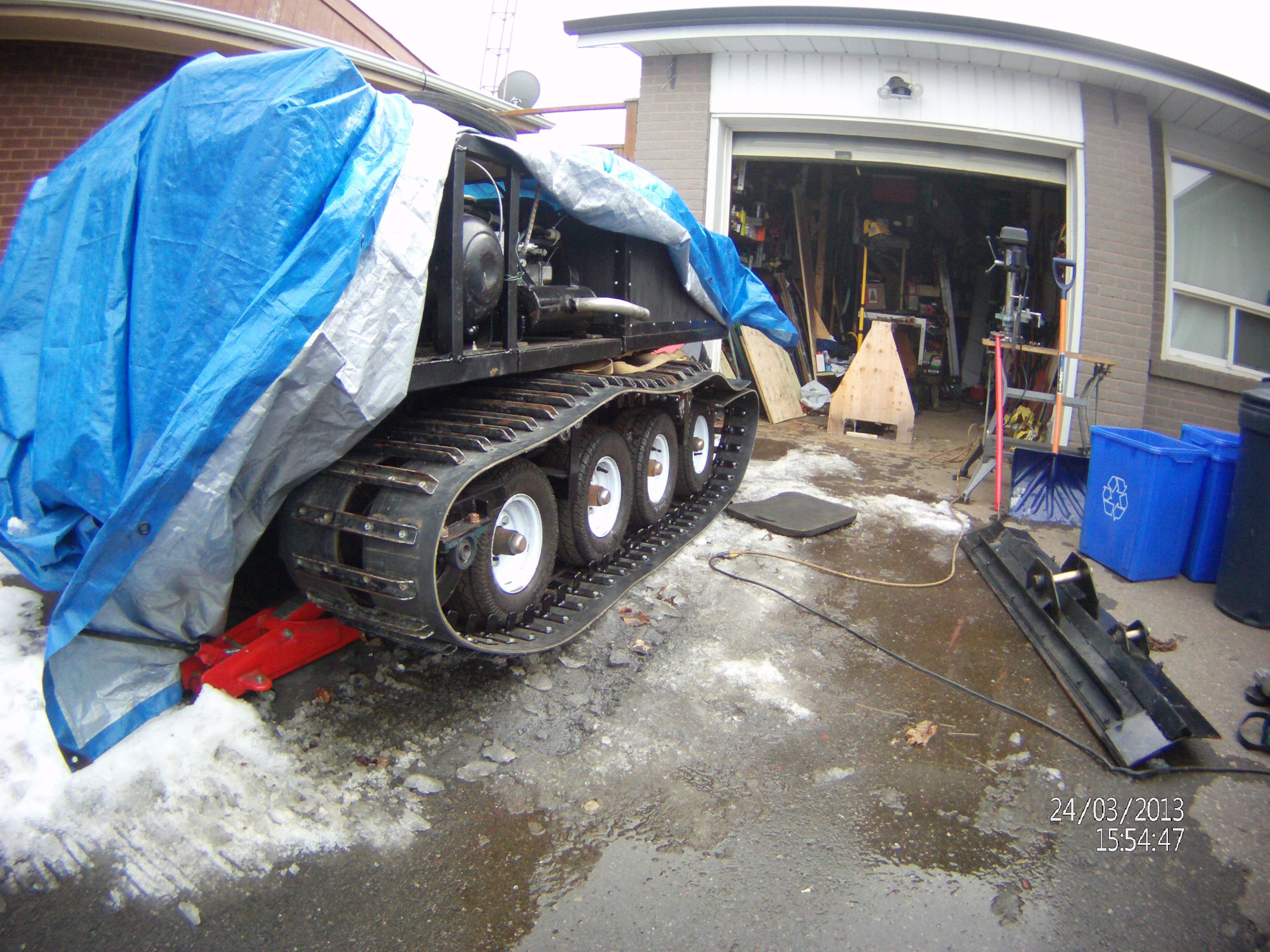

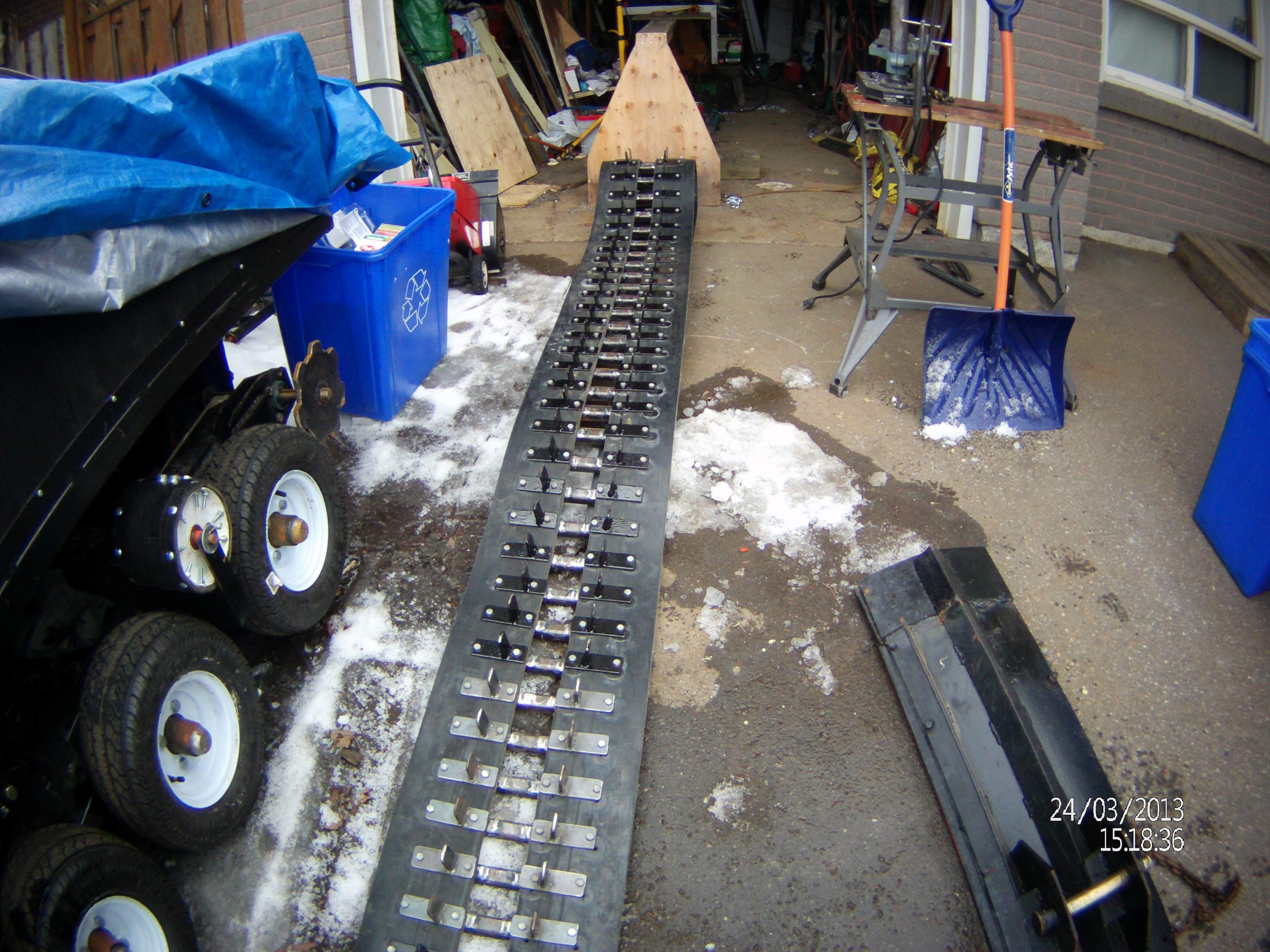

   / Scale Cat Twenty Two Dozer Ride On For My Son #150
Great project, but hopefully its big enough to fit you to cause you will want to use it unless you have a real dozer. The amount of time and money I have into my second incarnation of a set of tracks, I could have purchased premade tracks and sprockets. Oh well one track is finally done and if it passes the test phase I will be investing another 100 hours into a second track.
