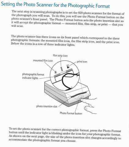

Bird, with a flatbed scanner, you need a source of light behind the slide or you will not see much of an image (very, very dark). Many scanners come with special light attachments just for slides or transparencies. If you have one of these, your results should be good. Without one, it's an exercise in frustration. /forums/images/graemlins/frown.gif
My HP scanjet 6200C came with this little attachment that is supposed to reflect the light from the scanners internal light so it transmits through the slide. I was never able to do anything with this attachment except waste a lot of time. /forums/images/graemlins/tongue.gif I bought an HP PhotoSmart scanner (see attachment) and that has worked out well.
