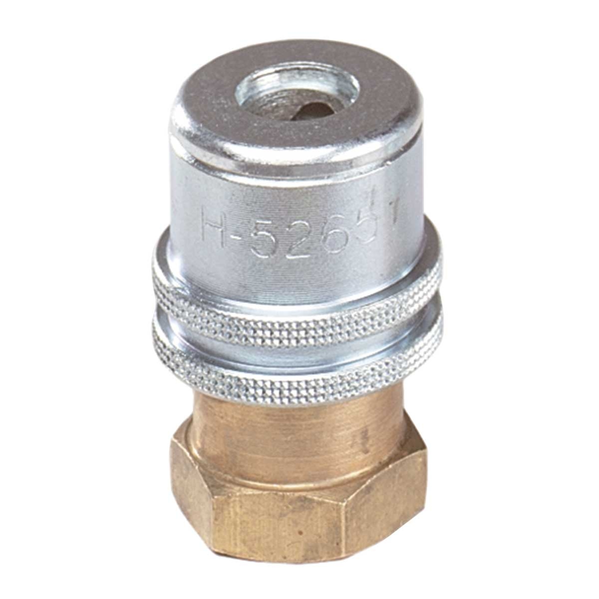

Definitely need to pull the core out! Thx for the link to Gemplers.
I think this is the item I need. As far as I can tell, it has no internal shutoff, requires a valve upstream,
so I'm assuming it's purpose is full-flow. I'll run a larger hose out of the ball valve, then reduced down
at the air chuck.
That's an interesting fitting which I have not seen before.
But there is an easier way, if I understand what you are doing: just take a QA fitting
and tap the pipe-thread end to the Shrader valve thread. This is an unusual thread
size, 5/16-32, so you will have to order it. About $7.
Now you can remove the valve in your stem, thread this new fitting onto the stem,
connect up your hose to the fitting, and let-er rip.
I do this without a quick-dump tank like you have. I just open the ball valve at
my compressor, which allows me to stand way back from the tire I am filling.
I do ATV tires, and it can be dramatic, requiring quite a bit of flow and pressure
to get these tough tires to fully seat.

The reason I am doing this is that working on my property I've had several tires come off the rim, for mainly ATV, and ATV trailer. I would like to have a lightweight quick-dump tank thats easy to carry to where the tire problem is and set the bead right there. And then I use my little 12v compressor to get the pressure I need. Other times for changing a tubeless motorcycle tire, it's often someplace away from my shop air. Other times it's a rescue mission where I have to carry the tank to help someone. This is a low cost test; to see how small a tank can "do it".
Interesting idea tapping to schrader thread, thx for that note (5/16-32). But seems like you'd have to drill (or "have") a fairly accurate (9/32) hole to tap a 32 thread.
I actually don't think threads are necessary, just a rubber squeeze clamping force is probably sufficient. Kinda prefer NOT to screw on, because it can be too slow and leaky coming off. Sometimes you can remove the filler hose, and quickly insert a valve core and catch quite a few psi remaining.
Just solder a metal valve cap to a piece of common size fitting or pipe nipple.
Bruce
   / Schrader fitting, for setting tubeless tires (small & motorcycle etc) #16
Yeah, portability is good for your application.
The QA air fittings are almost the right size to be tapped without drilling. I used the right drill size first,
tapped it, then I was ready to go in about 10-15 minutes. Works great.
A rubber clamp style schrader hose would work if it did not have the obstruction inside that pushes on
the valve. I have a few of those from 12v compressors. I wanted maximum flow.
I also considered attaching a pipe nipple and some fittings to a metal valve cap. That seemed more work than
just the tapping of one hole.
