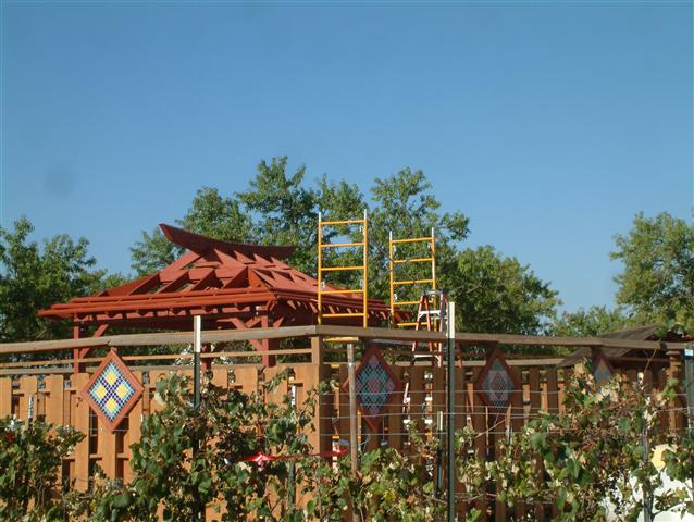

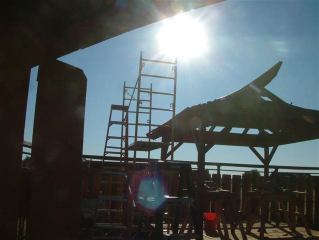

Here the scaffolding I got from SM to build a Japanese pergola last year.
Bakers Type Scaffold Ladder, Scaffold Frame - from ScaffoldMart
I only had to go up 10 ft. I'd use one of their other packages to handle your height requirement.
http://www.scaffoldmart.com/scaffold-tower-packages/26-scaffolding-tower.html
If I were you, I'd stretch my budget a little, get the scaffolding and be safe!!!!
