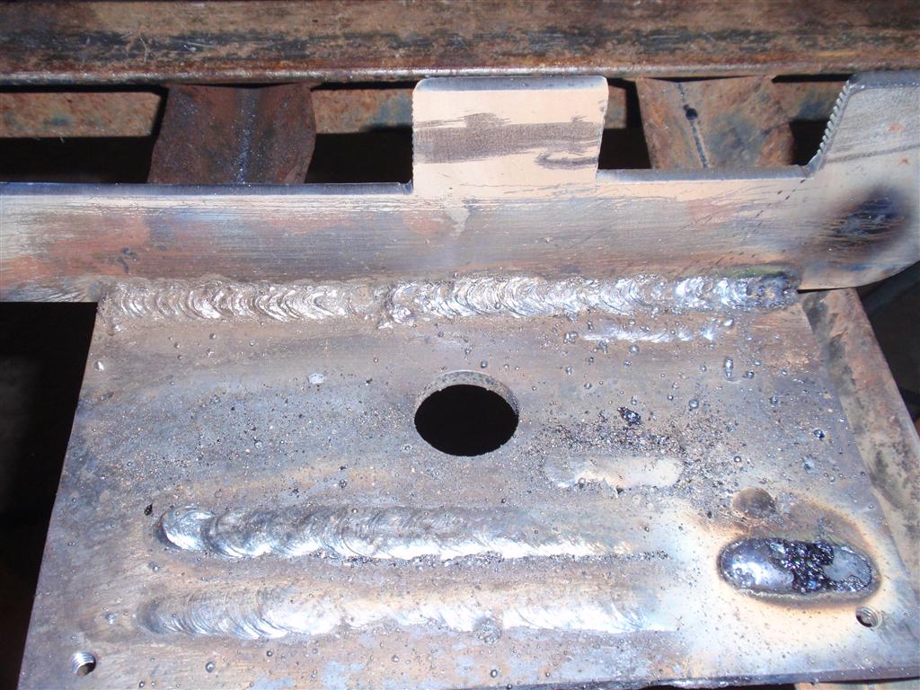

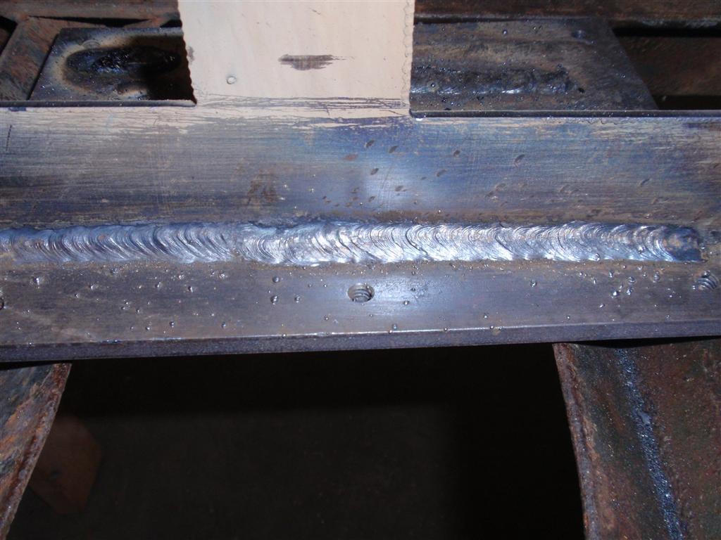

OK, OK here ya go: It welds. I need to work on the adjustments a bit as I was having sticking problems, but I'll figure it out. Did simple F2 Tee welds. First the pretty one: 1/8" 6013 (105A, DC+)...
attachment.php
Then the not so pretty one 5/32" 6011 (130A, DC+). I was having problems getting a good arc established with this one until it heated up a bit. Need to play with the settings more I guess. I kept turning it up, so I was probably a bit cold. The restart with a new stick a third/halfway through was ugly:
attachment.php
