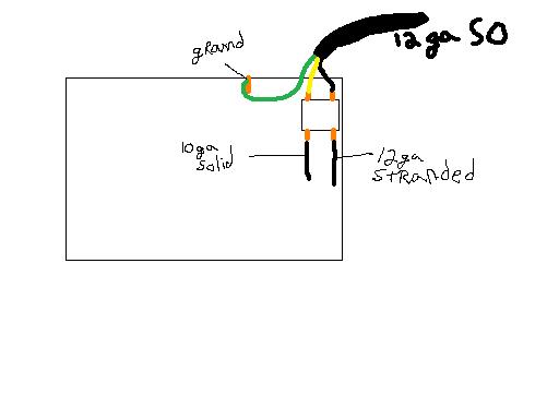

I am not worried about starting a fire. I don't know if I was clear or not, but the 12ga wire that I am talking about is the powercord for the welder. I used it because it is hat I had avaliable. The guy I purchased the welder from had about a 4ft 10ga SO cord on it. I used it to tie into the breaker with the receptical. The 25-30ft of 12ga SO that I had, I put on the welder itself.
None of this wiring is behind walls. It's just strung across the concrete floor. The only part of the wiring that I can't see is the 6-8" that is behind the breaker box cover. I think my odds are much greater to start a fire with the weld spatter than the 12ga cord lying on a concrete floor.
But like I said, I am not worried at all about myself. My questions are to wiring in general, and how the NEC comes up with it's limitations. What formulas (voltage drop, wattage, etc)
PS back to the welders, I pulled the cover off my welder to see the internal wiring. My 12ga SO cord hooks into the top a box (looks about like a motor starter, without the contacts, maybe fuses???)and then there are two power wires directally below where mine hook in. Interestingly enough, the thwo wires are different. One is a stranded 12ga wire and the other is a 10ga solid.
Not if one has been replaced or what but all the other wires inside are stranded, so I am guessing the solid was replaced. See diagram.
So basically, my power cord is hooking to 12ga wires inside the welder.
Maybe I don't even need a 40a Breaker, it's just what I had, and have always ran welders off of. Maybe I will try a 30A breaker to appease some of the code nuts. (I know it's still wouldn't be to code, but it would be closer)
Again, thanks to all who replied with informative info/links/formulas. I have learned a lot and would like to continue to learn more
