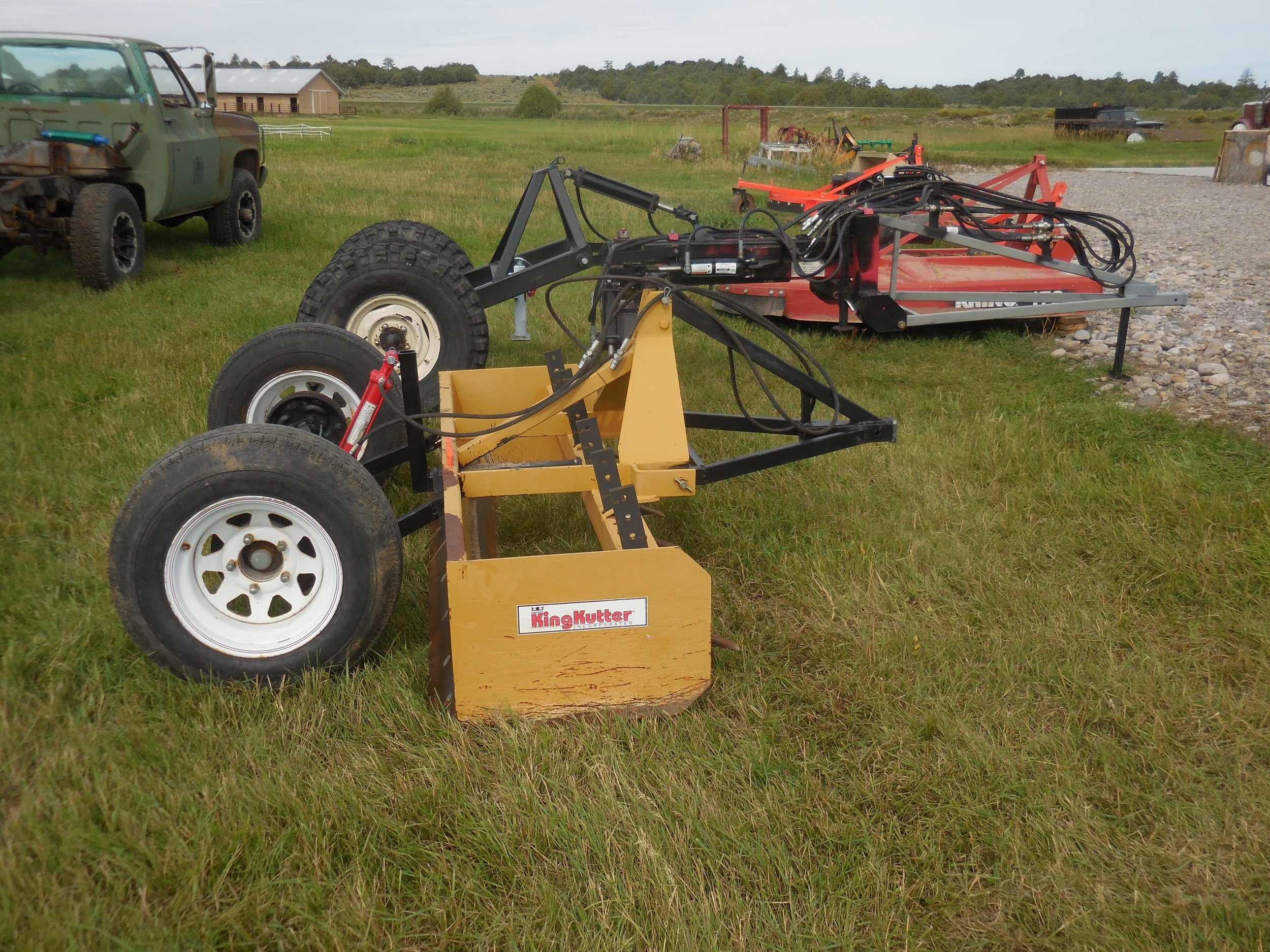

Somewhat performing the same function, I converted a leftover box blade to smooth out/move dirt with.
Used an old trailer axle and bought a cheap cylinder for lifting the rear. Fine tuning with the 3-point allows surprising precision. Using a 5' 2-inch square tube extension makes it more accurate yet.
Everything is pinned in place, so the box blade can be used in normal fashion, too.

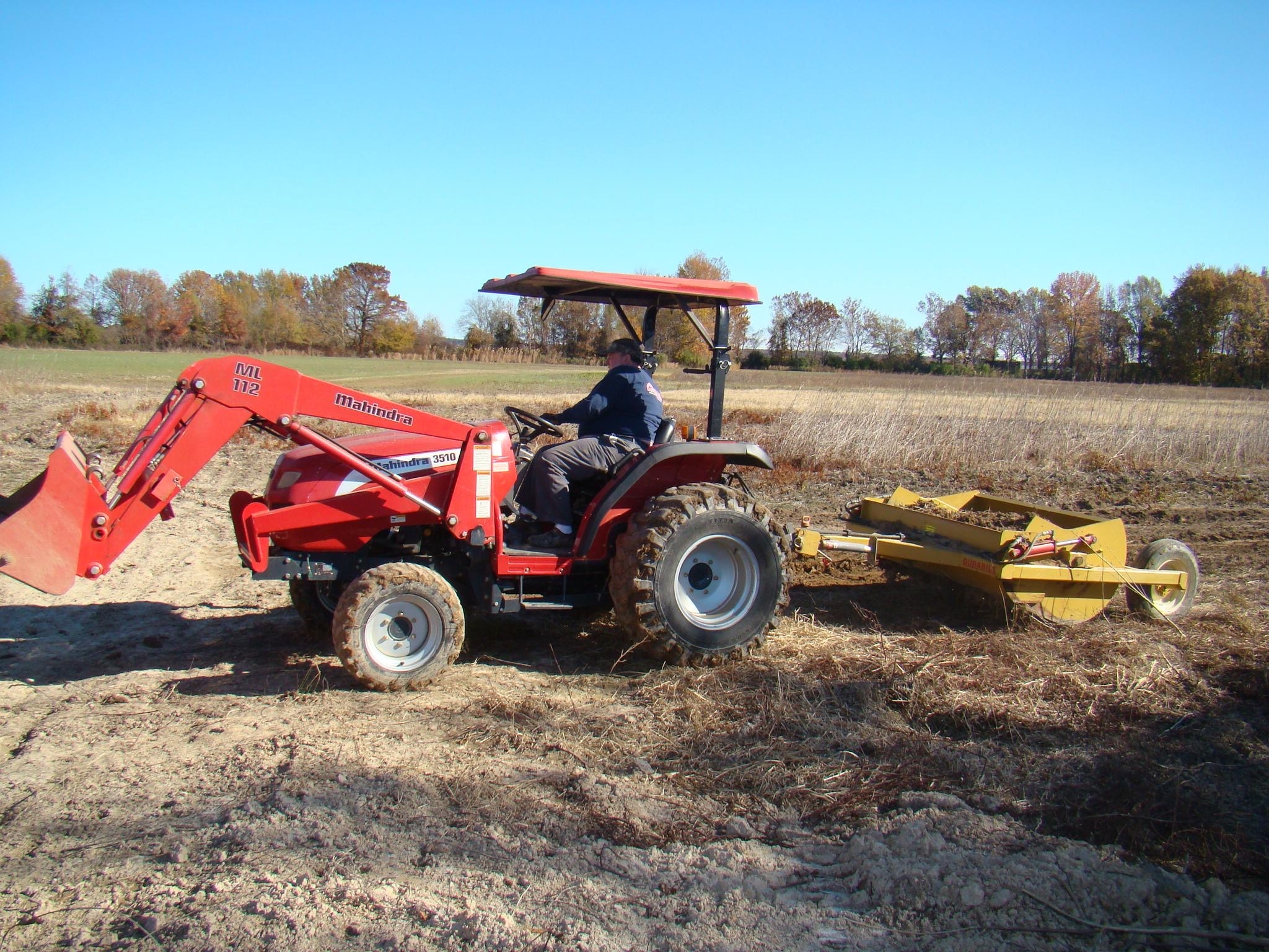

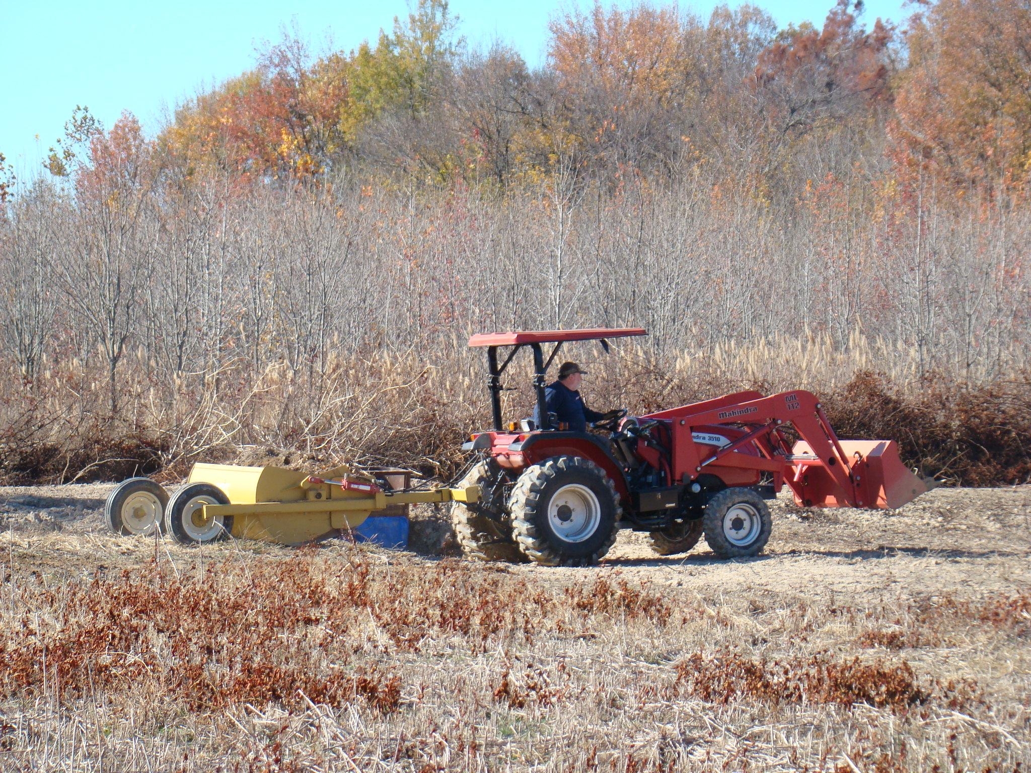

I have a DP60 pan. Still using to maintain levees around the duck holes and in process of building a dividing levee for rice production.
The Mahindra 3510 will pull it fine but it does struggle for traction in dry hard ground.
The 8560 will scrape a bucket full while filling the pan to overflow.
Most of the soil comes from a small dried up pond that will one day soon be a small lake.
Able to build a lake and levee at the same time. I have to catch the conditions right to use the pan for scraping as hard ground is tough to slice off. It tends to want to come up in chunks. My next idea is to load pan and dig out the lake with the backhoe on 3510 rather than scraping an inch off, dig several feet out at a time. Maybe I can get some help to run the AC 8560??
I would like to have a DB84 but unless I could trade, good with this one for now.
