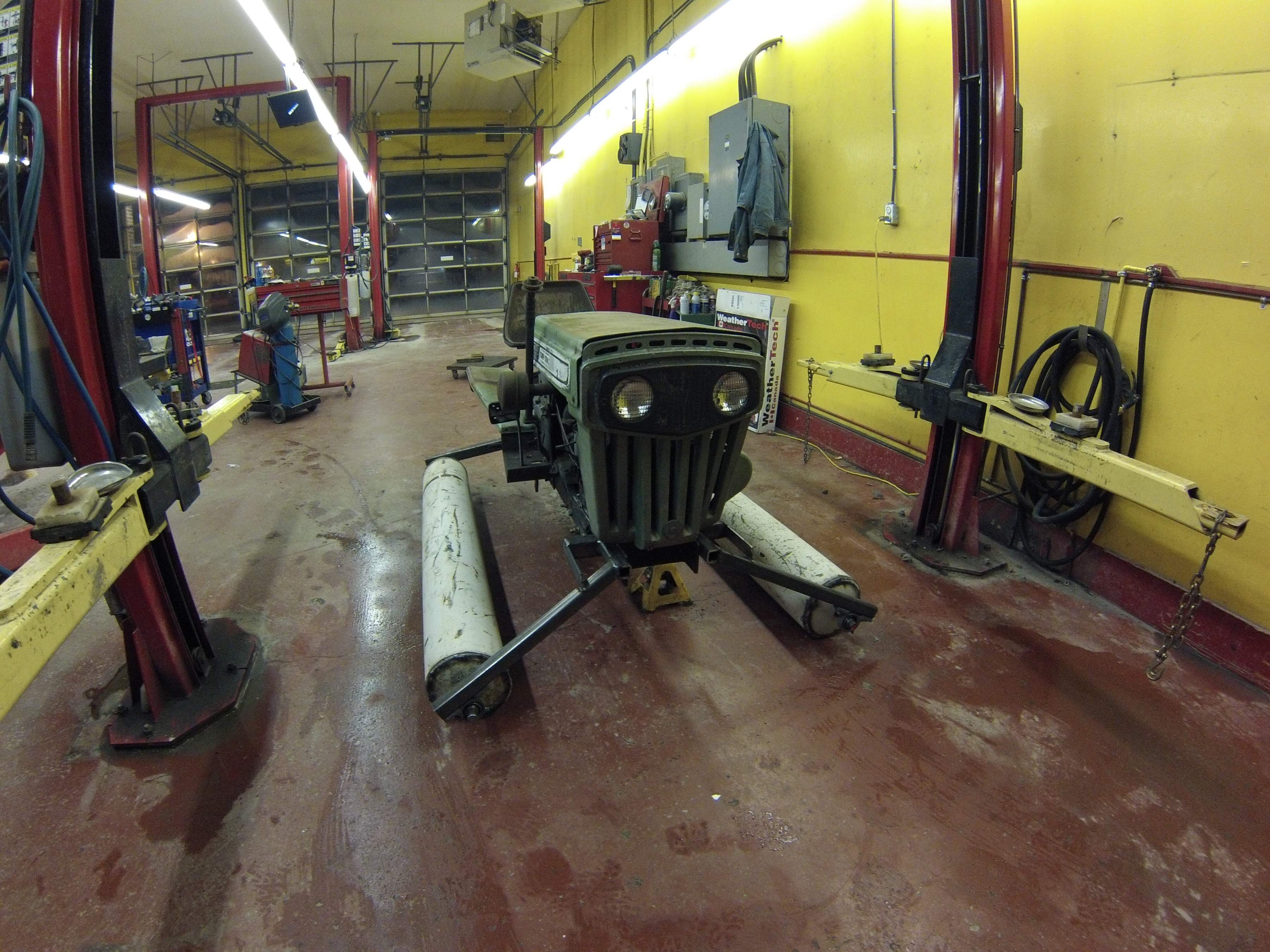

thanks, I think that's what I wanted to hear. still new to hydraulics so i appreciate the help!
   / screw drive vehicle skid steer ideas #12
Aren't you just trying to make a zero turn mower with screw drives in place of the wheels? Am I missing something? Seems like you could start with a parts manual for a zero turn mower and order up what you need - or equivilent equipment.
#13
hah, yeah that would be too easy wouldn't it? no of course i'm doing in the stupid way..
   / screw drive vehicle skid steer ideas #14
Zero turn mower pumps/motors are pretty pricey though. The only decent deal I have ever seen was at Surplus Center had the pump motor combo units for like $250 per side. Not sure if they are still there though. Otherwise you are talking 1,000's.
