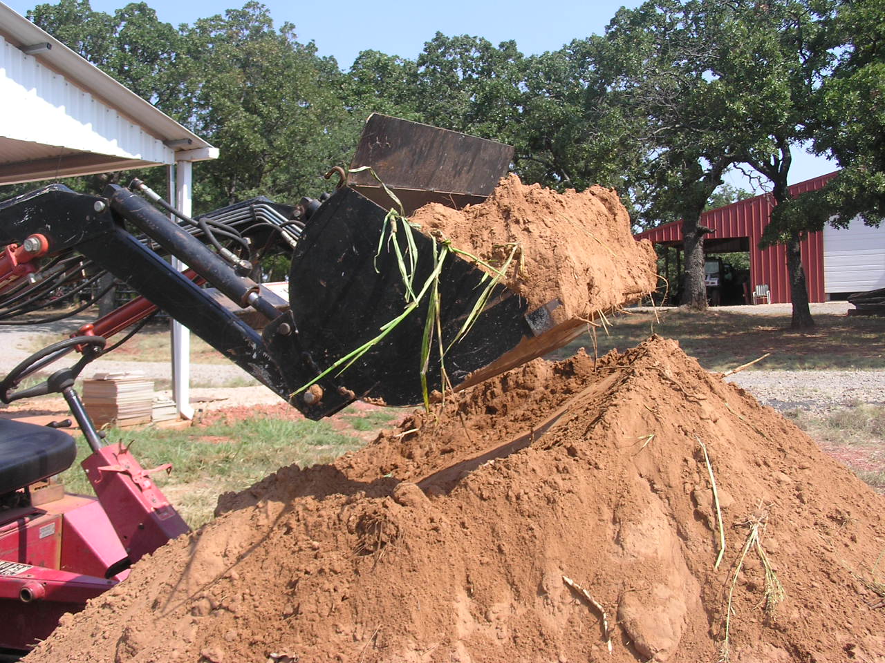

What it will lift depends on the diameter of the cylinders and the pressure on them.
The limiting factor is the load rating of the front axle.

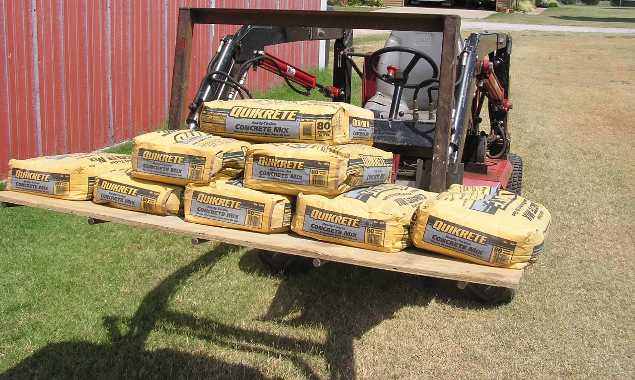

My Kwik-Way loader bucket is 42" wide, TORO front axle rating is 1800 pounds.
No problem lifting dry dirt:
640 ponds of concrete mix on the brush fork:
