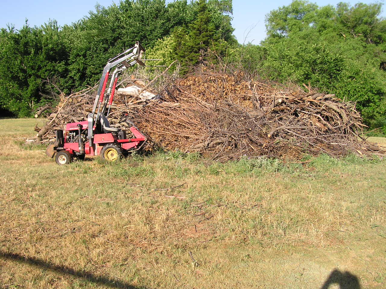

XFAXMAN: I enjoy your pictures of that thing, even if looking makes me temporarily cross-eyed. Reminds me tractors are a big world and to keep an open mind.
Thanks.
It has worked out better than I expected. Put it together in 2005. Here is a brush pile from June 2006, piled a little at a time, with the 2' long forks.
And the fireplace rake on the forks.
