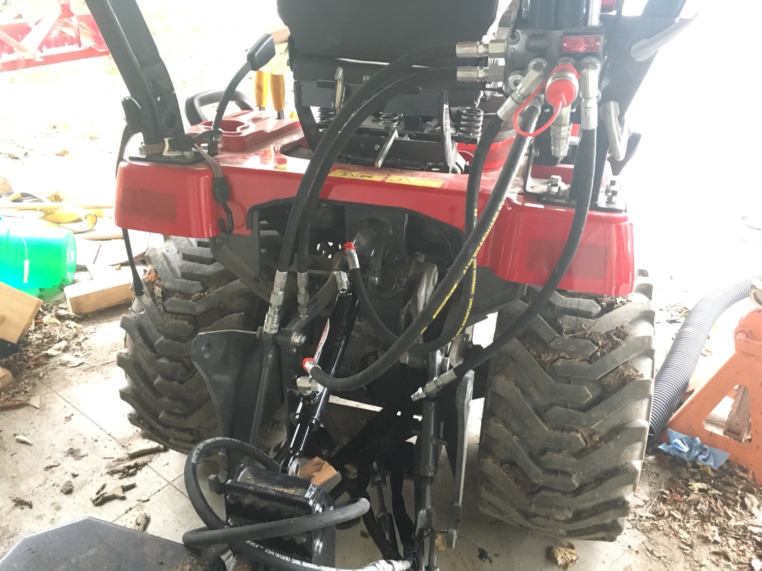

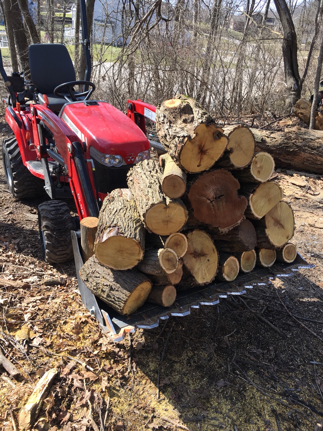

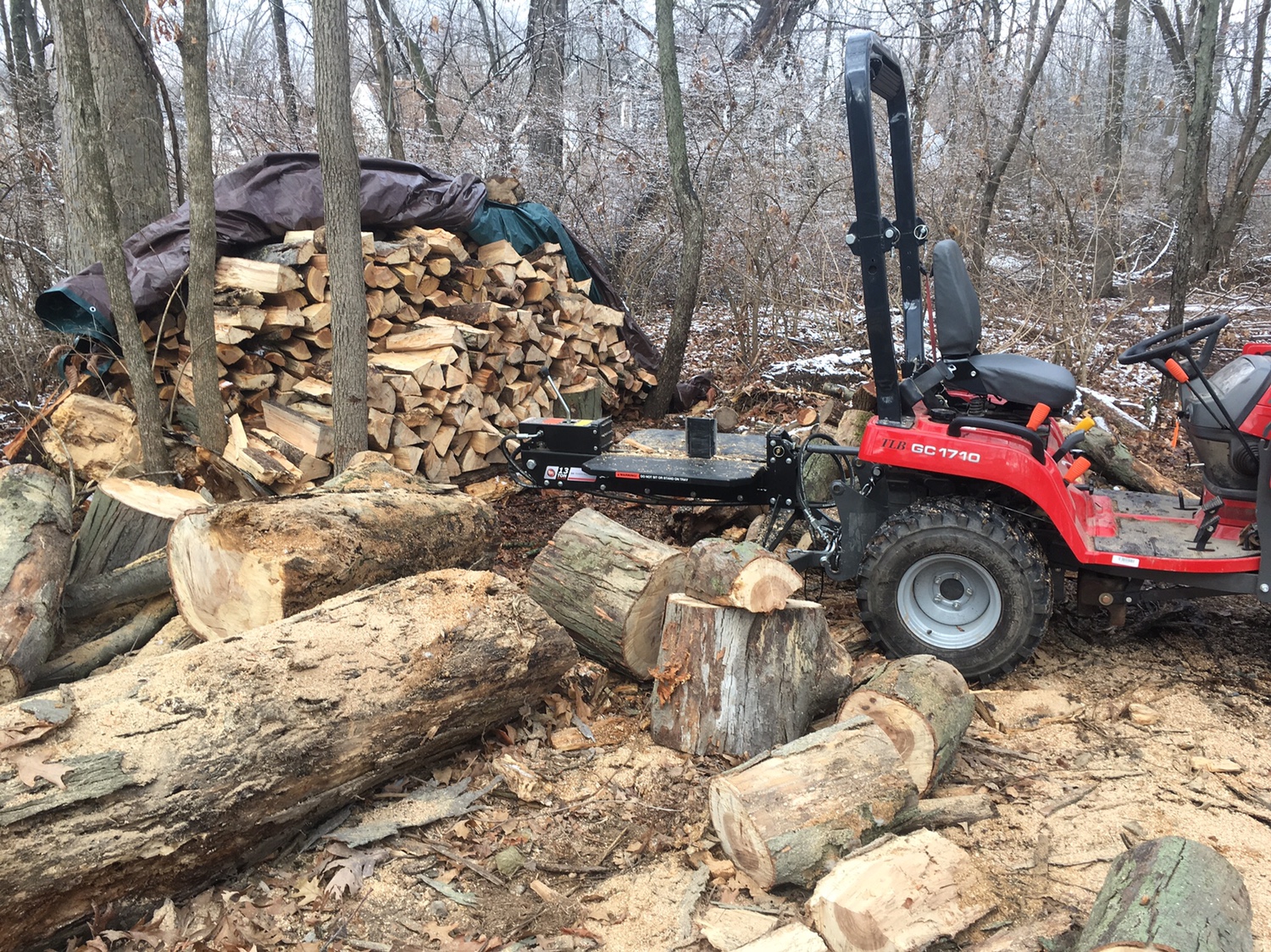

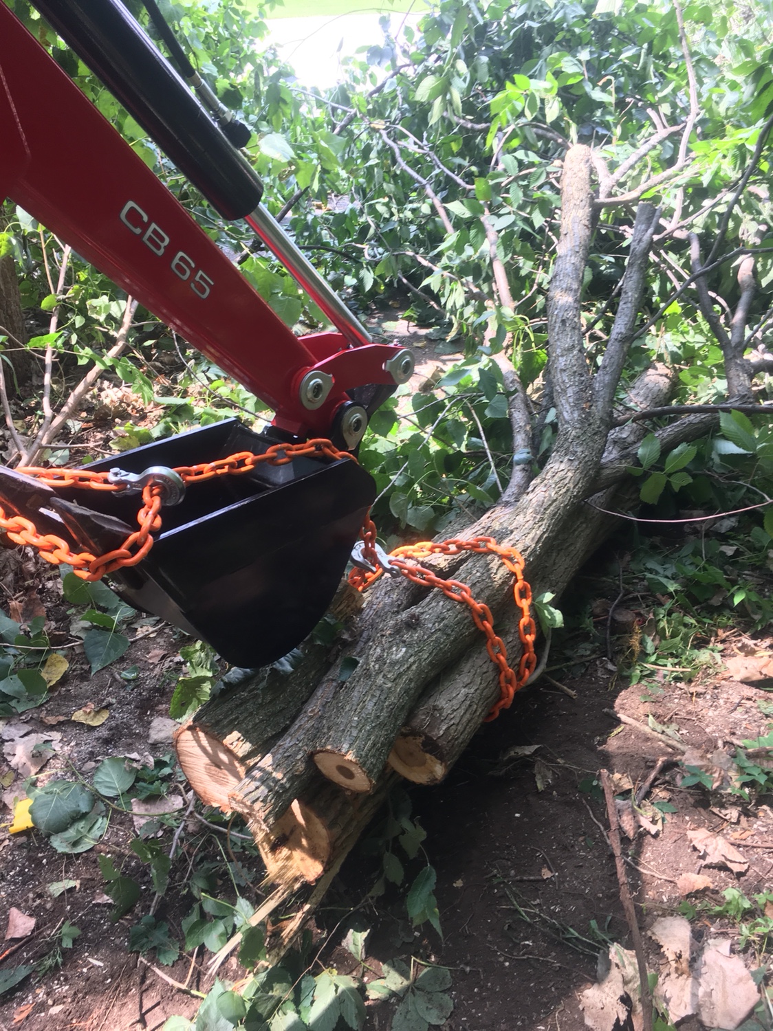

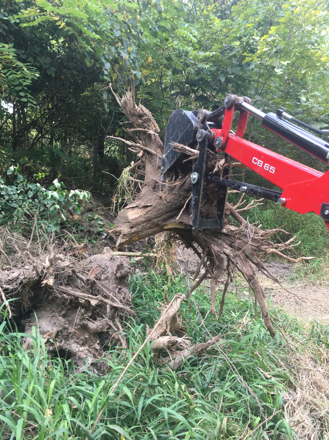

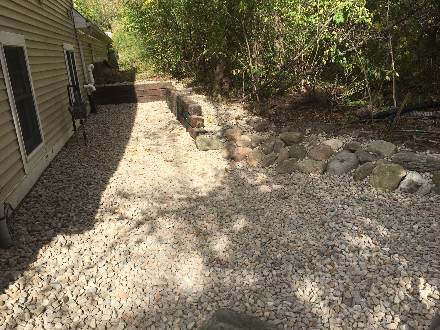

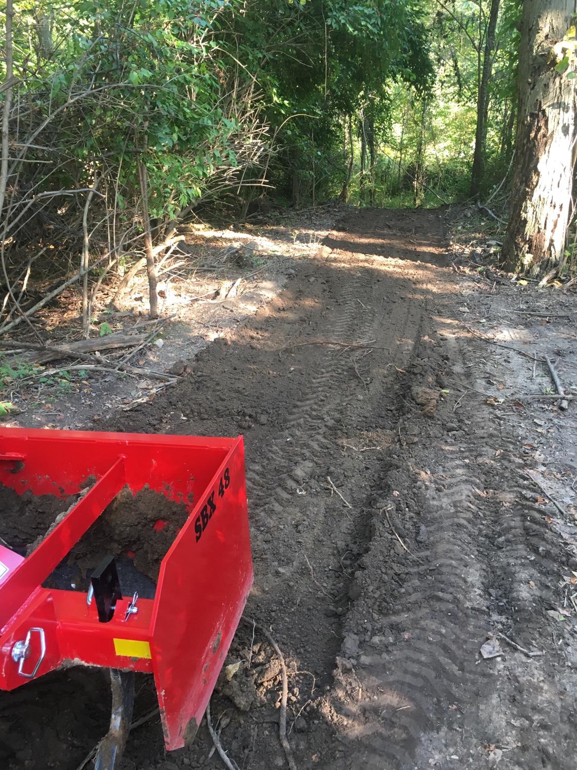

Well I love my SCUT and it does so much more than a garden tractor could dream....however if you are “thinking of a CUT” then you’ve probably already made your decision. For me $17k for a TLB was a done deal plus room for attachments!....have done so much on my 2 acre property. Bought new in August now has 140 hours. Moved 30,000lb of stone, split a ton of firewood, moved snow, dug trenches, installed railroad ties....I have the tires filled and a custom 135lb tractor weight on the mower deck arms. This thing thinks it’s a tank...
IMG_4027.JPGIMG_3601.JPGIMG_3941.JPGIMG_3369.JPGIMG_3174.JPGIMG_2825.JPGIMG_3151.JPGIMG_2501.JPGIMG_2918.JPGIMG_2916.JPG
GC1710 with new DR dual action 3 point log splitter part 1 - YouTube

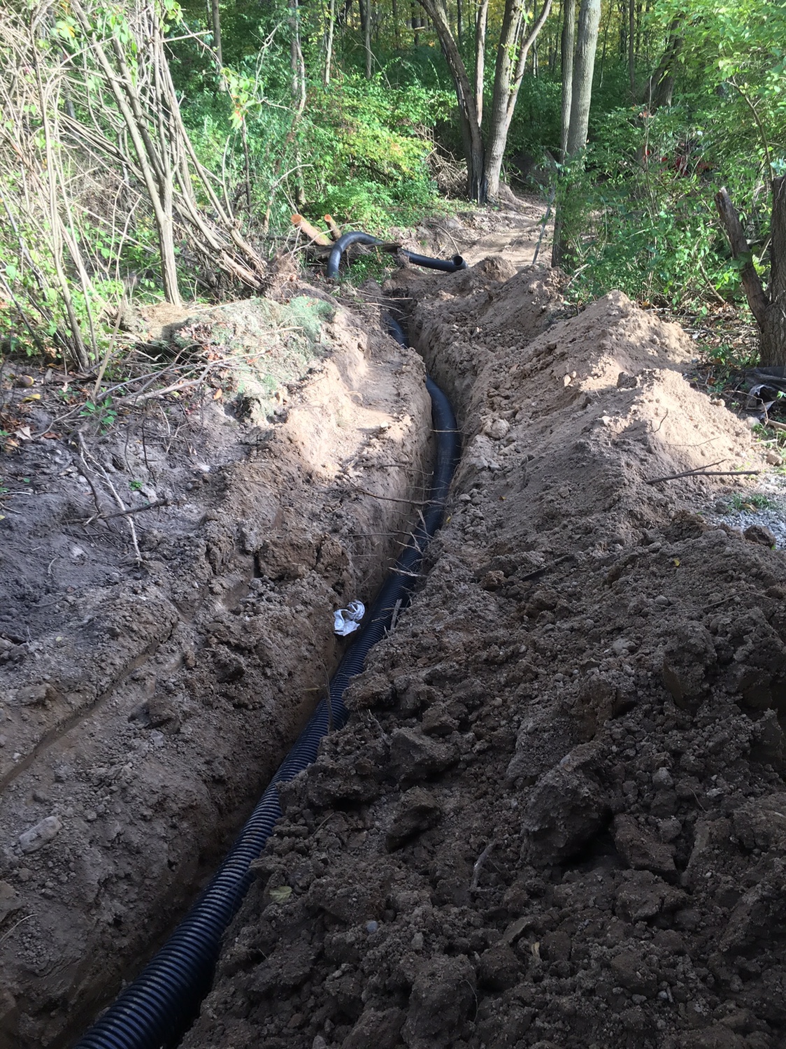

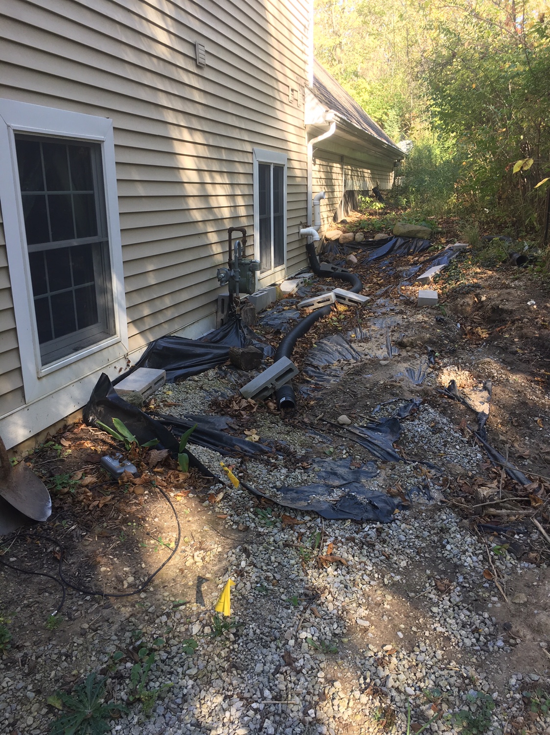

I have subdivided my property and am in process of building a small house on the adjoining property. So far I have trenches 350' for power service, installed a septic system (2 leach trenches 2' wide, 5' deep, 110' long, plus the hole for the tank: 6' x 6' x 12'), moved 200 tons of stone for the septic, and dug another 300' trench for water lines. Graded and leveled the building site. Will be putting in a 400' driveway (grading away topsoil and placing stone). This little tractor can do what I need it to do. I also have a 6' finish mower and a 54" heavy box blade.
