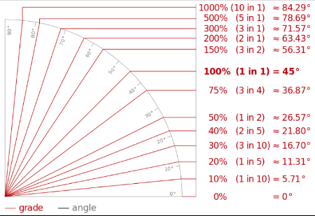

As far as slopes, the OP mentions a 25-degree slope. Are you sure you don't mean a 25-percent slope? See chart below.

Based on that graphic, I'd say mine is 20 degrees, so the OP may be correct.
I drop about 20 feet over about 60 feet or so.
