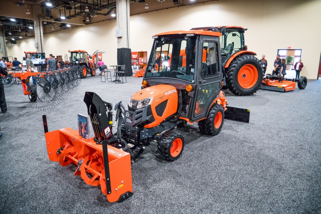

Just noticed pics of new BX factory cab model in Muhammad's thread about Kub Dealer Meeting.
Here is the pic from the Kubota dealer meeting from the TBN homepage article....Looks nice!
