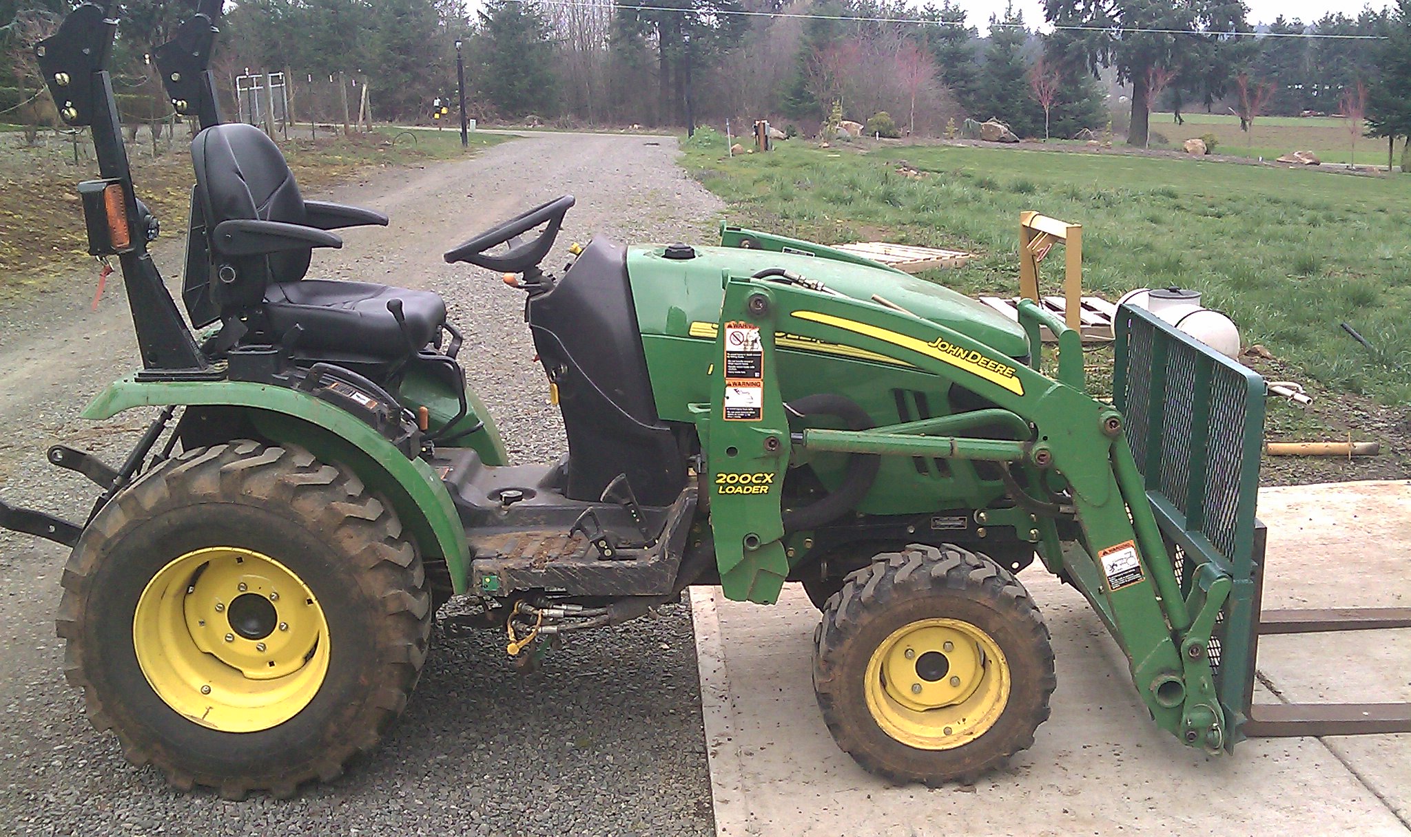

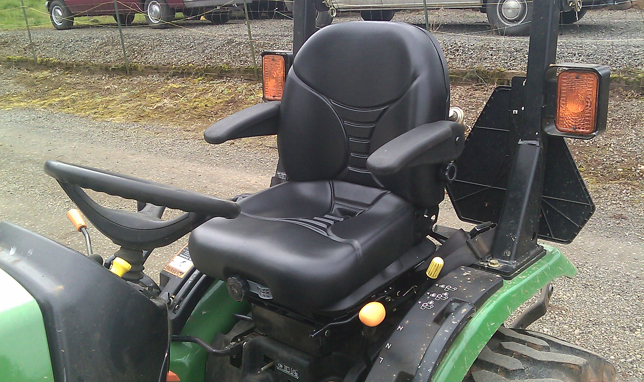

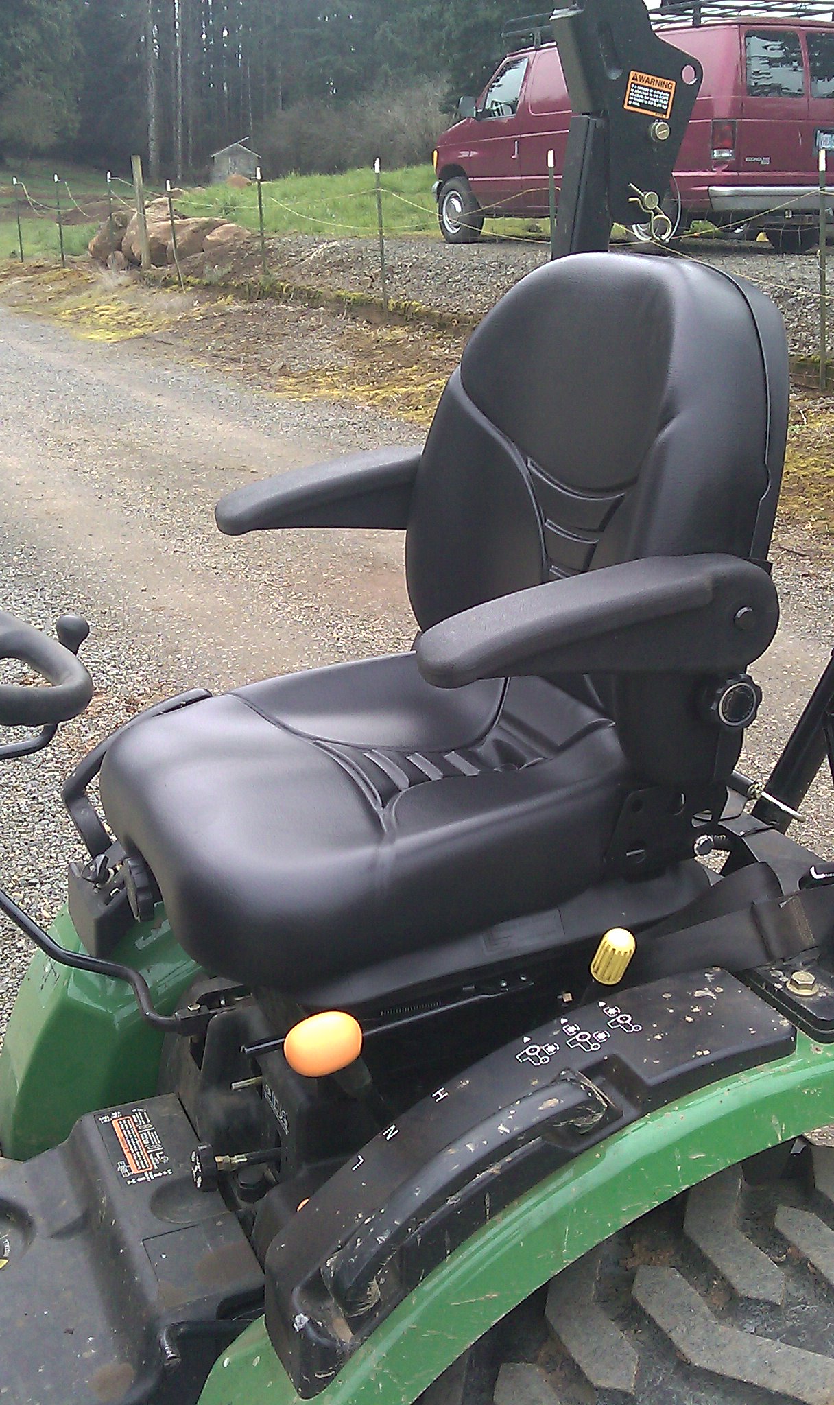

I got some good seat time in it now.. I may removed some more of the orignal seat frame, and fab a spacer up. It almost seems like the seat is tillted a little far forward.
Still over all, its a way better ride.. I don't know why Deere doesn't offer it on these tractors.

ORCM, Great mod! I see your problem and it can be easily fixed. Remove the rubber shocks in the back of seat and cut them down to your fit. I actually did a mod where I had to buy 2 additional rubber shocks and they are around 12.00, so dont worry if you think you are going to screw up something.;)
Also if you look up thread "2520 Suspension Seat" another member removed the rubber shocks and weilded a peice of tube steel and it looks real nice.

Very nice job ORCM. As BIGWES stated,you could cut the rubbers down to give you a more level seat:thumbsup:
I couldn't believe how much comfort this seat offers. The most seat time for me so far has been plowing our two foot snowfall three weeks ago. I think I was in the seat almost seven hours with a twenty minute break. I didn't have that "just spent a whole day on a tractor seat" feeling.:)
Why JD won't offer this as an option on the 2000 series is......well, a mystery to say the least:confused:
Greg

Yeah, if I decide to change it I will just remove the rubber isolators (Save them in case the next owner wants the old seat back on.), and install some ~2" tubing. The seat is a bit tippy side to side, so putting a piece of tubing under there instead would fix it..

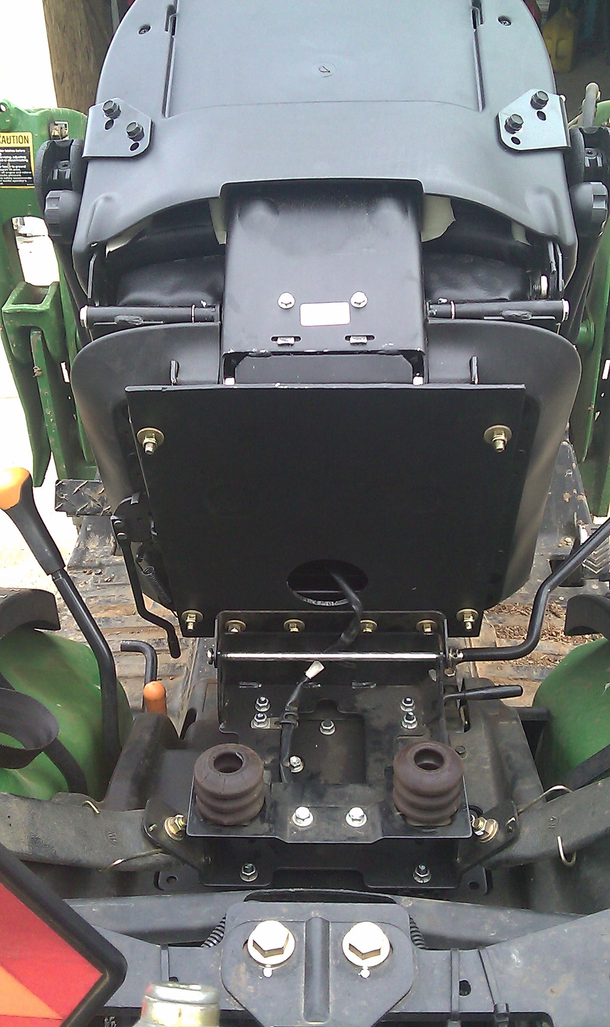

I have finally had the chance to install this seat and have had to do it different. I do not have a metal cutting band saw (yet) so I had to grind forever but the results satisfy me. I have not posted pics before but will try. I still need to tweak a few things and disassemble and put back together and will post additional picks,
Well this is driving me nuts. windows xp and I can not copy and past the pics and the file does not say open. Work with me and I will get this working. I have tried the manage attachments but have no options when I copy pics yet.
Sorry but the seat does work well.
Perseverance, like grinding will get this figured out.
Bob

I am still trying so here goes.
   / SE SEAT FOR MY 2520 #29
that seemed to work so I will try the others,
   / SE SEAT FOR MY 2520 #30
I tried to post other pics and was informed that it seamed to be duplicate. The pic does not show material removed so will try again later and hopefully get this right. I need a break.
Bob
