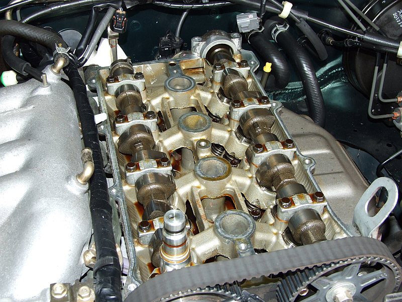

Where in today's world do you find an engine like that pictured? There was a time 50-60 yrs ago something like that was not all that uncommon but for the oils we have today, how is it possible other than not changing the oil all together.
Here's a pic I've posted before. Car had something like 135k miles on it and has seen nothing but run of the mill dino oil. I've just got back from a 4600 mi trip and no oil added and still reading full on the dip stick. Also oil is no darker than that pictured. I typ change oil about every 7k miles.
