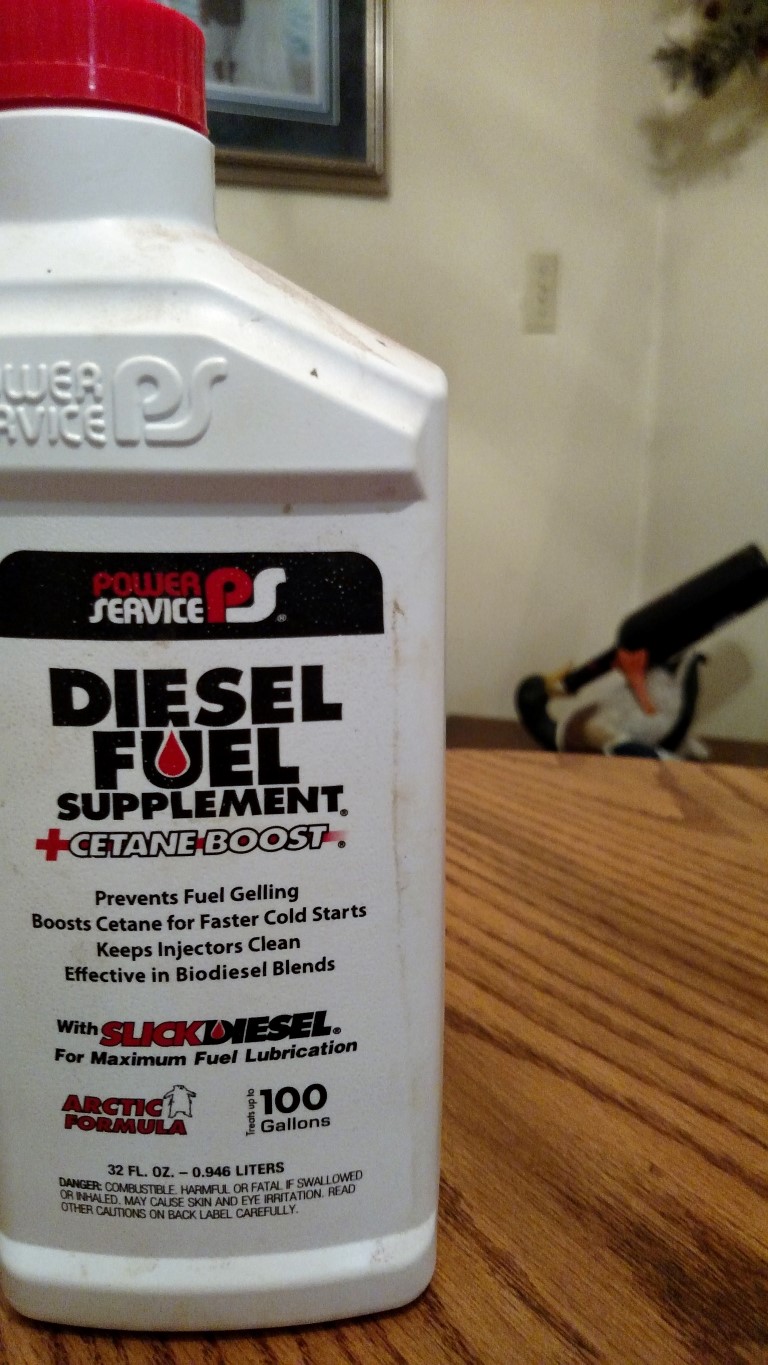

I use Sea Foam in the (non-ethanol) gas for all my small engines and swear by it. Here is what I use in my diesel fuel ...
