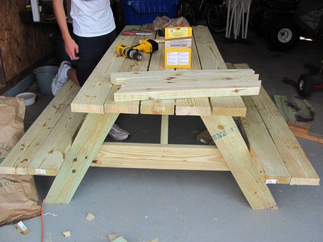

Originally was going to use pressure treated, but since tables will not be in direct weather, thought I'd use either pine or fir. Making 10 or 12 of them next weekend. The prototype was made using pressure treated, that stuff twisted pretty bad since I bought the lumber a few weeks before I made it. I'm changing the design to a single 2x10 for the seats, maybe 3 2x10's for the top, instead of the 2x6's used to prototype.

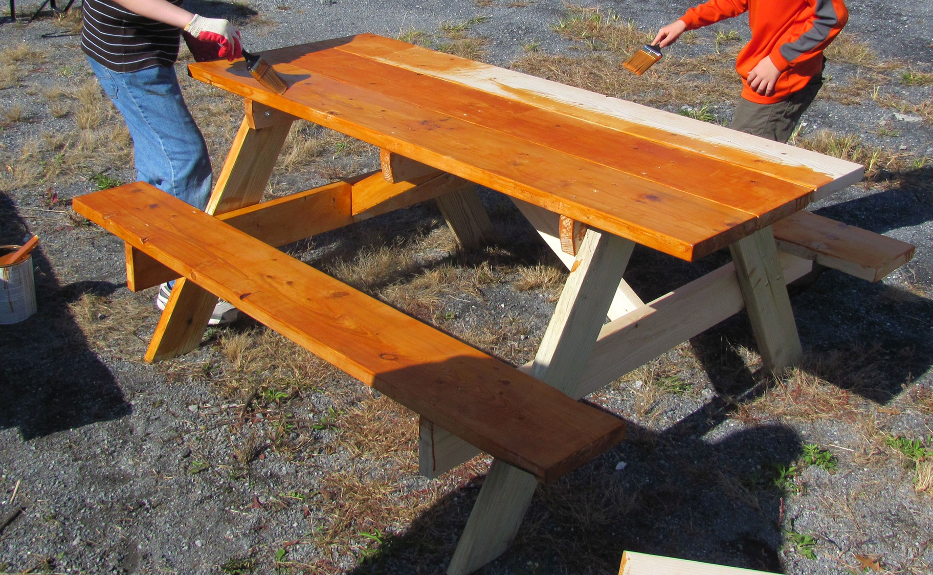

Dejavu,
Most were stained, a couple still bare. They are kept indoors usually.
   / Seal or paint a picnic table?
#16
Here is one being stained.
