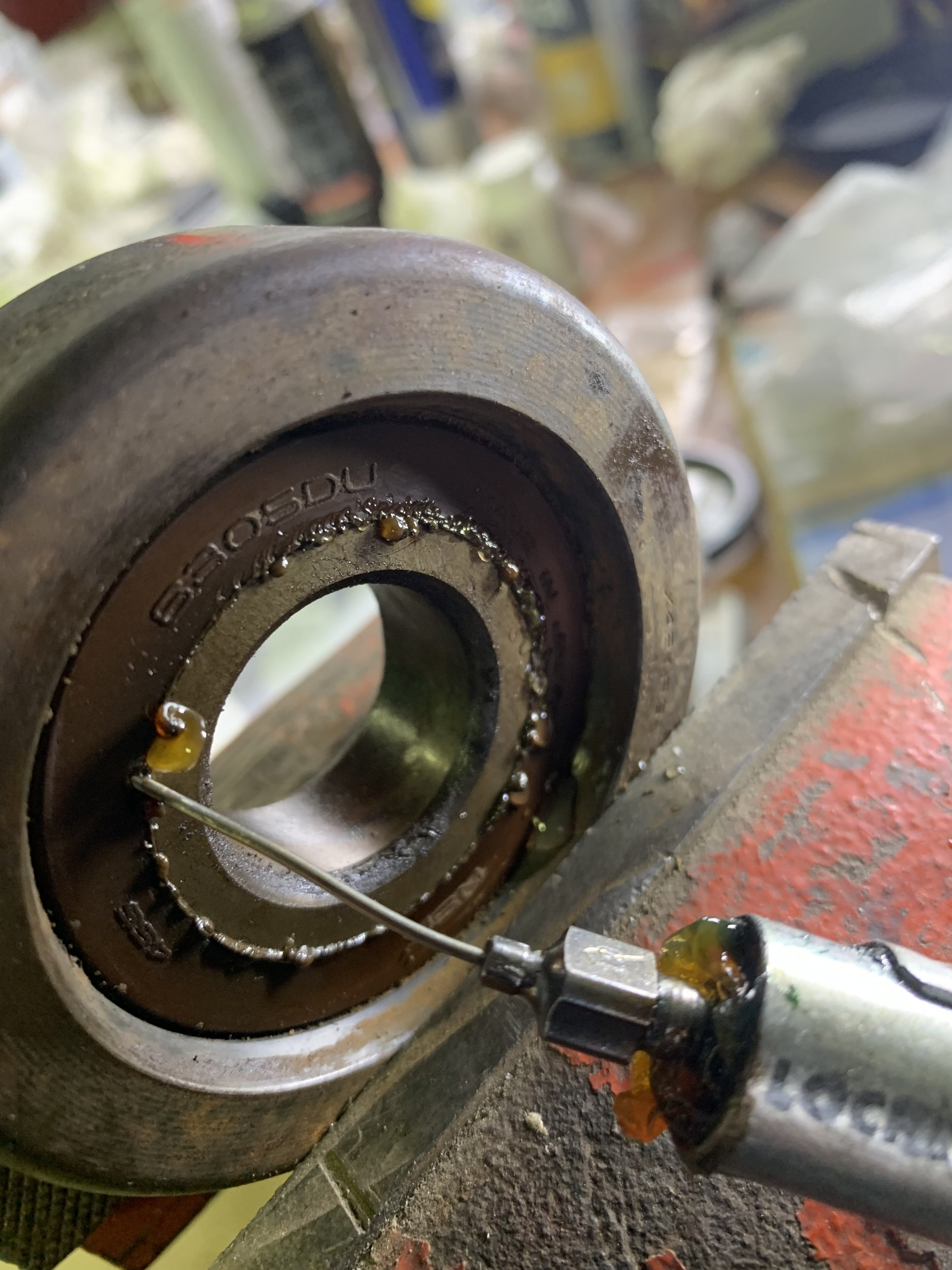

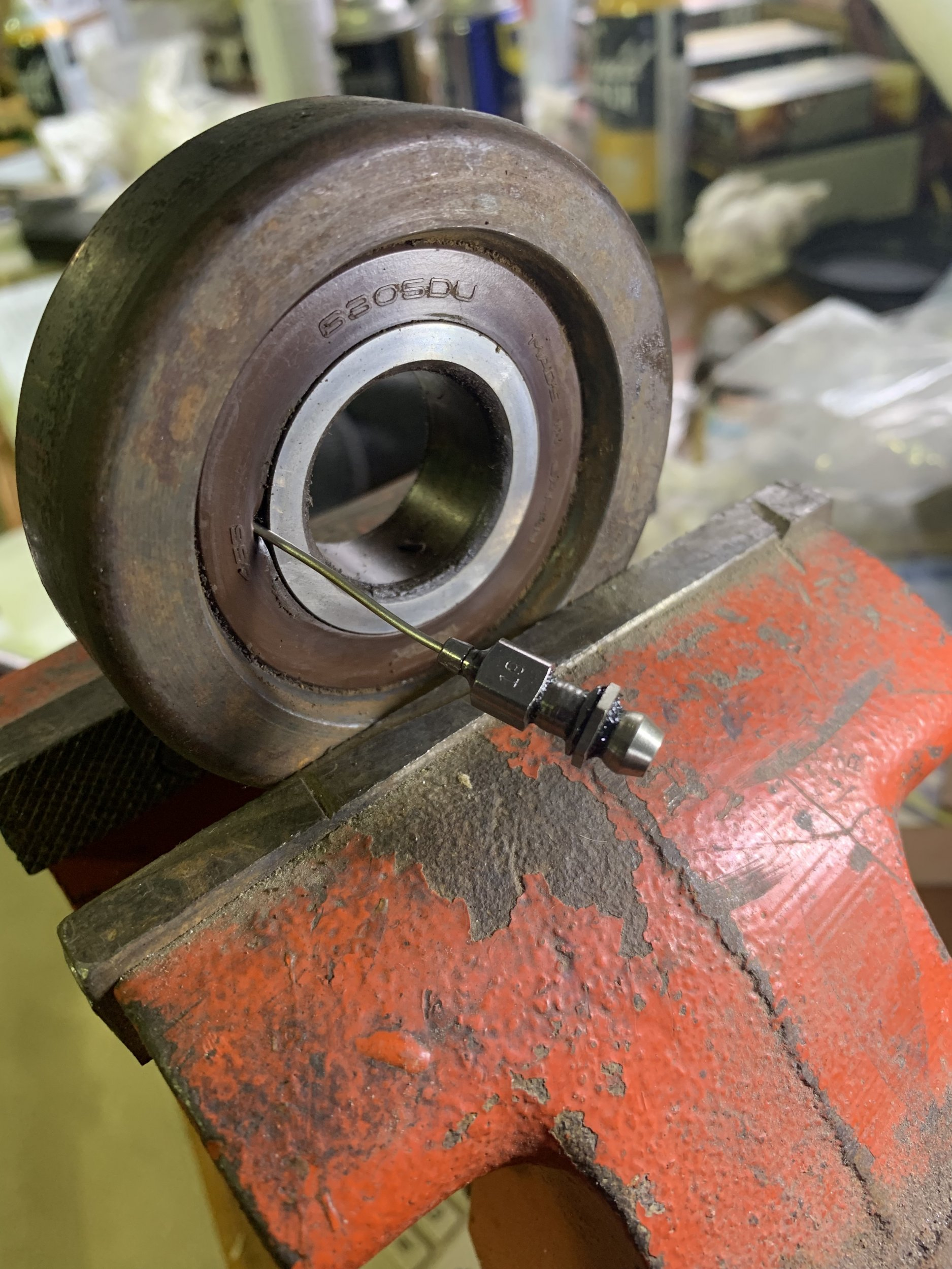

I’ve very very seldom had to replace a greaseable bearing over the years , sealed I’ve replaced many. If I can get to a sealed bearing I grease them on the machine with a needle, here’s one off a fork lift mast i greased, first thing that pushed out was tiny water droplets

I've greased metal sided bearings by drilling a needle sized hole in the side and then sealing it off with a dab of silicone.
One thing I have not experimented with is removing the metal side and replacing it with a rubber one from an old bearing.

I think the if you clean off the zerk before you grease you prolong the life of a bearing by greasing it. A good example is the water being pushed out in the above pictures.
