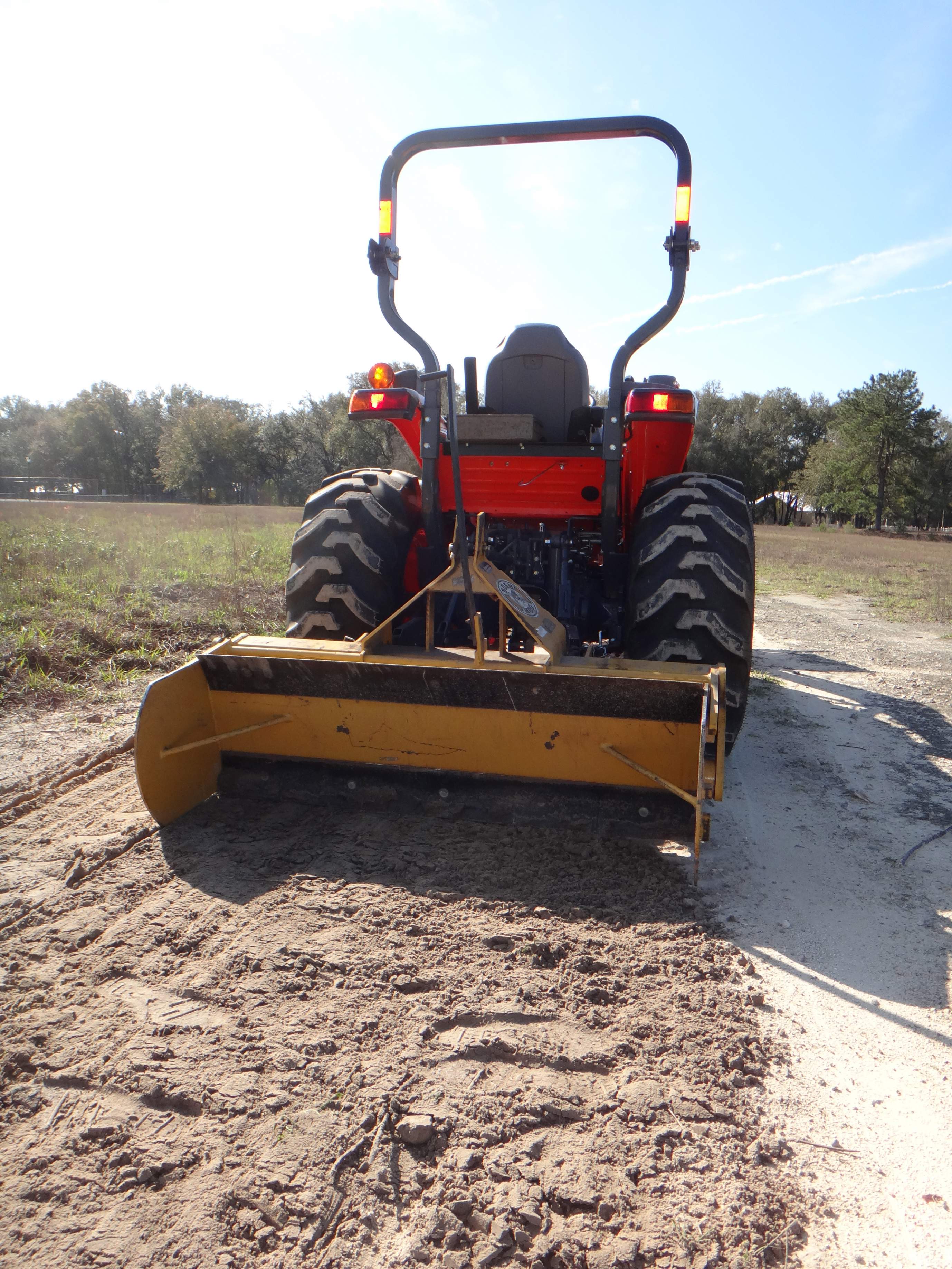

Turnbuckle Lower Link stabilizers provide tension support only when tractor is operating forward.
Operating in reverse, slack turnbuckle Lower Link stabilizers will bend, ending the turnbuckle stabilizer's ability to tension evenly when tractor operates forward.
Rigid Lower Link stabilizers can be PRUDENTLY applied to push.
The rigid, heavy Lower Links and pin-adjustable rigid stabilizers on my L3560 can be used with a Rollover Box Blade to push a pile of fill dirt with the tractor operating in reverse.
Here is position of Rollover Box Blade before it pushes dirt.

I'd try it both forward and backward.
That is why they are reversable.
I'd think that scooping up backward would be stronger than draggin forward.
My box blade seems to really dig in and bulldoze harder when pushed in reverse.

Tractors & the 3pt especially are made to pull, not push. The 3pt linkages are MUCH stronger in tension than compression. Get a straw & try to pull it appart... Not gonna happen. But try & crush it, it will crumple easily.
I'll push a bit with my box blade, but not much as I don't want to be replacing 3pt linkage parts.
