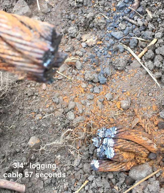

OK it was 57 seconds to cut a 3/4" logging cable. Can't tell you how many times but probably 10-20 cables per battery.
I figger if this is something Bruce doesn't know then TBN has a dire need to know! :laughing: Better jump on this it'll be another five years before I can find something to teach Bruce. So I started a new thread with that specific searchable subject.

The photo of all the sparks in the smoking grass didn't come through. And what happen when you need 37 cuts? :laughing:

Bruce if I had to cut 37 cables I'd go find a more interesting project. :D
I have a $25 400w inverter hardwired to my pickup. I use it mostly for charging DeWalt batteries. It can't run a two-battery 240w DeWalt charger with 2 batteries in it. Will charge one though. I wish it had a true 400w but it was only $25! Problem with bigger inverters is they suck more power, you have to choose your battles.

Thanks for the test.
I know the last time I had to cut a cable off it was about 10-12 cuts to completely free the rotor. If it was 37 cuts to free it I would be in a world of hurt. If your estimates are correct then I could expect to get one battery to one tangle-up. As I originally posted my experience with cordless is limited. I had not realized there were cigarette lighter/accessory plug chargers for the battery packs. That is an idea. As long as I don't tangle more often/frequently than the charger can recharge the battery pack then 10 cuts might just make it.(until a really good tangle requires more cuts than that then SOL)
