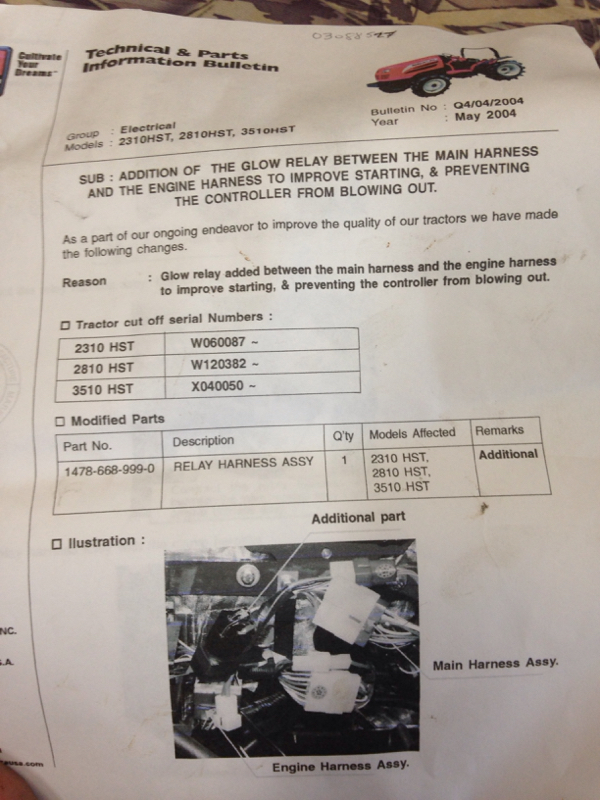

I need to find the add-on 2810 HST relay pigtail that was discussed at length in this old post http://www.tractorbynet.com/forums/mahindra-owning-operating/74223-2810hst-modification.html . It doesn't show up in the wiring diagrams at the dealer and Mahindra doesn't seem to be able to find it. This is all I need to get up and running again. Mine is burned beyond recognition. Does anyone have the part number for this pigtail or know where I might be able to get one?

The flasher relay is on the other side of the firewall under the dash. This doesn't have anything to do with the flasher from what I can tell. It's a add-on fix provided by the manufacturer that splices in between the fuse box, main and engine wiring harnesses to stop an electrical issue that was frying the controller box and solenoids.
   / Searching for 2810 HST relay pigtail #6
Ok that's what I was needing. Its a second glow plug relay.
There is a part # for the Relay Harness Assbly 14786689990

No problem. you wont be able to find it in the new style parts look up. Just tell your dealer to plug it into their shopping cart and it will pop up.

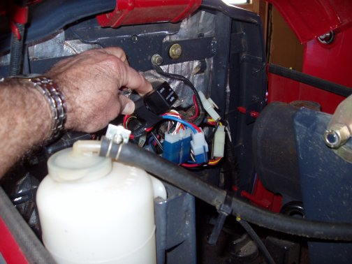

Charles Huff sent me one a few years ago. They were about $100, if I remember correctly. This is what you are looking for.....
