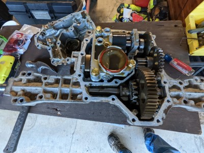

Mine started slipping and I got a transaxle servicing kit (seals & fluid).
View attachment 1611762View attachment 1611763

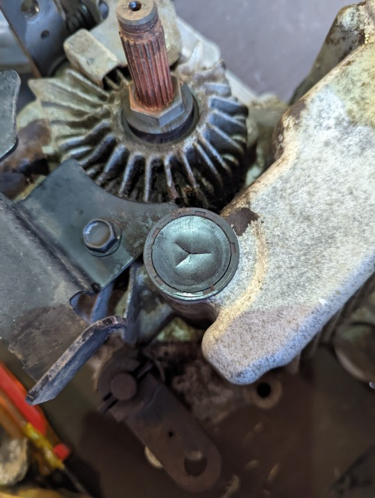

Problem was likely that this cap was cracked and had admitted water.
When I first opened it up (not pictured) there was basically mayonnaise inside.

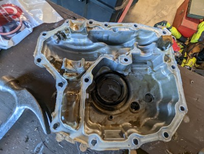

Cleaned it all up; everthing was in great condition inside.
View attachment 1611765View attachment 1611766
and put it back together.
I used something approximately like https://www.amazon.com/1a646099141-Transmission-Replaces-1A646099140-product_by/dp/B01M97WH3T/

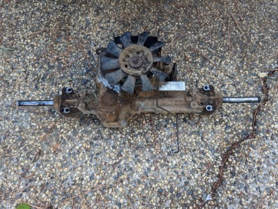

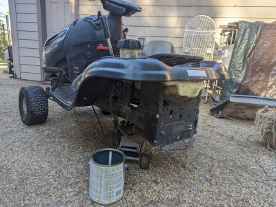

I really appreciate the info but, the entire deck is done, rear tires go flat, battery dead and this transaxle issue. I will pull the motor for my Gt3000, but we switched to robot mowers this year, and my mother who owned this machine will never go back to cutting the grass.
