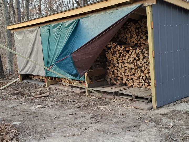

Using a moisture meter is definitely a good idea to know for sure (especially if you are buying your firewood). They are not that expensive (think Harbor Freight) and well worth it. I like to periodically check how dry my firewood is ( I harvest and process all our firewood). My goal is to keep it under 15% before burning. The stuff I am burning now is about 10-11% and has aged 2 yrs. Historically, most of what I burn is a year old.
As far as storage to dry, I got tired of tarps and pallets. Both would deteriorate over time and I always needed to remove snow off the top and some of the wood would end up getting wet anyway. Decided to build a shed a couple years ago and it has worked out great. Only wish I did it sooner. The sides and floor are spaced to allow air venting and really seems to make a difference.

Nice shed!! (y)(y)
I still go with the pallets-and-tarp method. Actually there's a layer of plastic under the tarp. Tarps seem to be somewhat porous, and the plastic deteriorates fairly fast from the UV so the combination works out for me.
My woodshed will only hold a little more than a year's worth, and I try to keep at least 2 years ahead, so the rest is stacked a couple hundred yards away where it's out of the way. I'll just fill up the woodshed in the fall (it's handy storage in the summer). Not really room for a larger woodshed near the house, or at least one that would be acceptable to the chief aesthetics officer. :ROFLMAO:

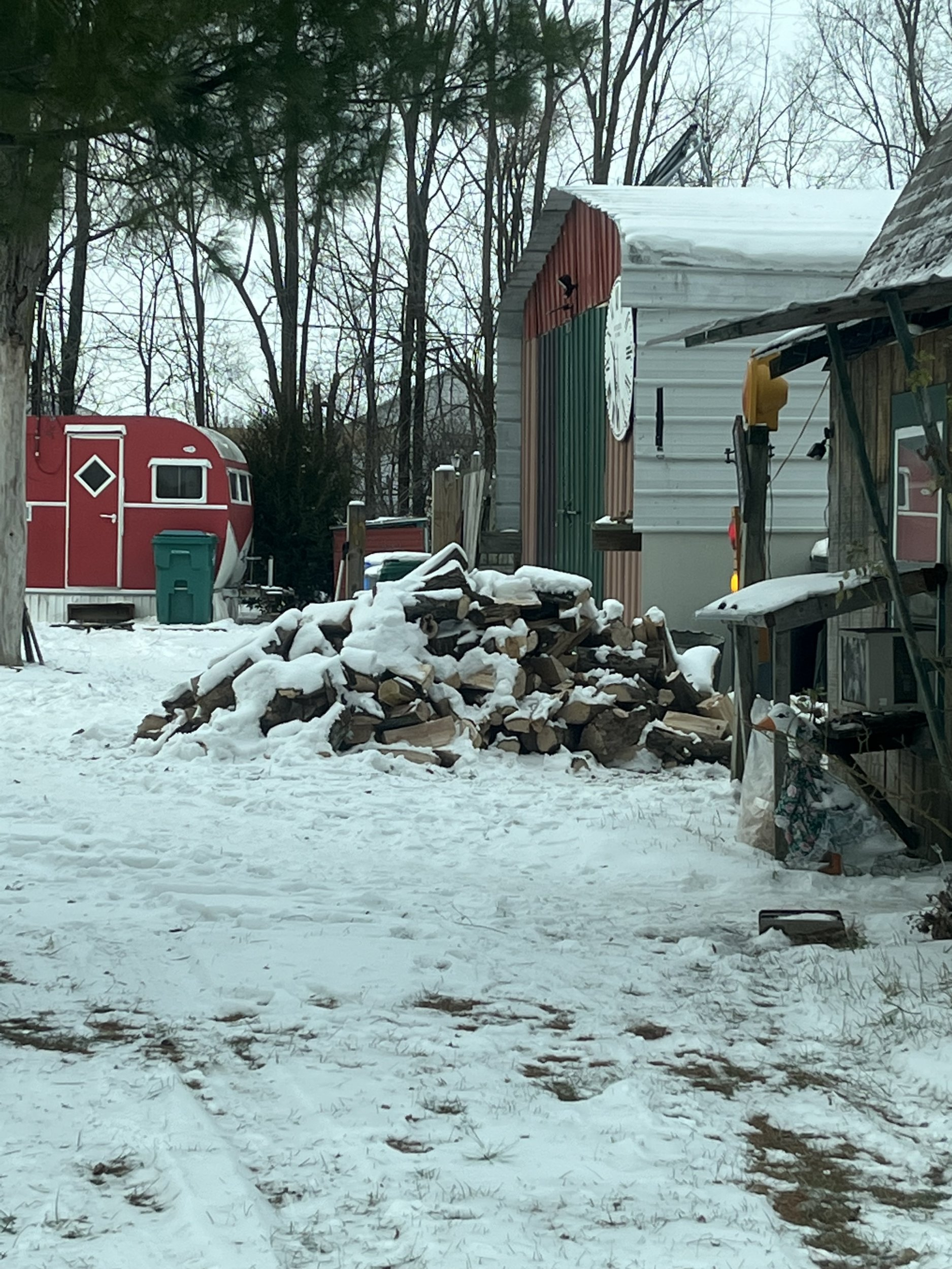

My wood sits out for 1 summer. Not covered or in a shed. It is split and stacked by May to be started burning by mid October. It is pine and I do about 10-12 cords a year.

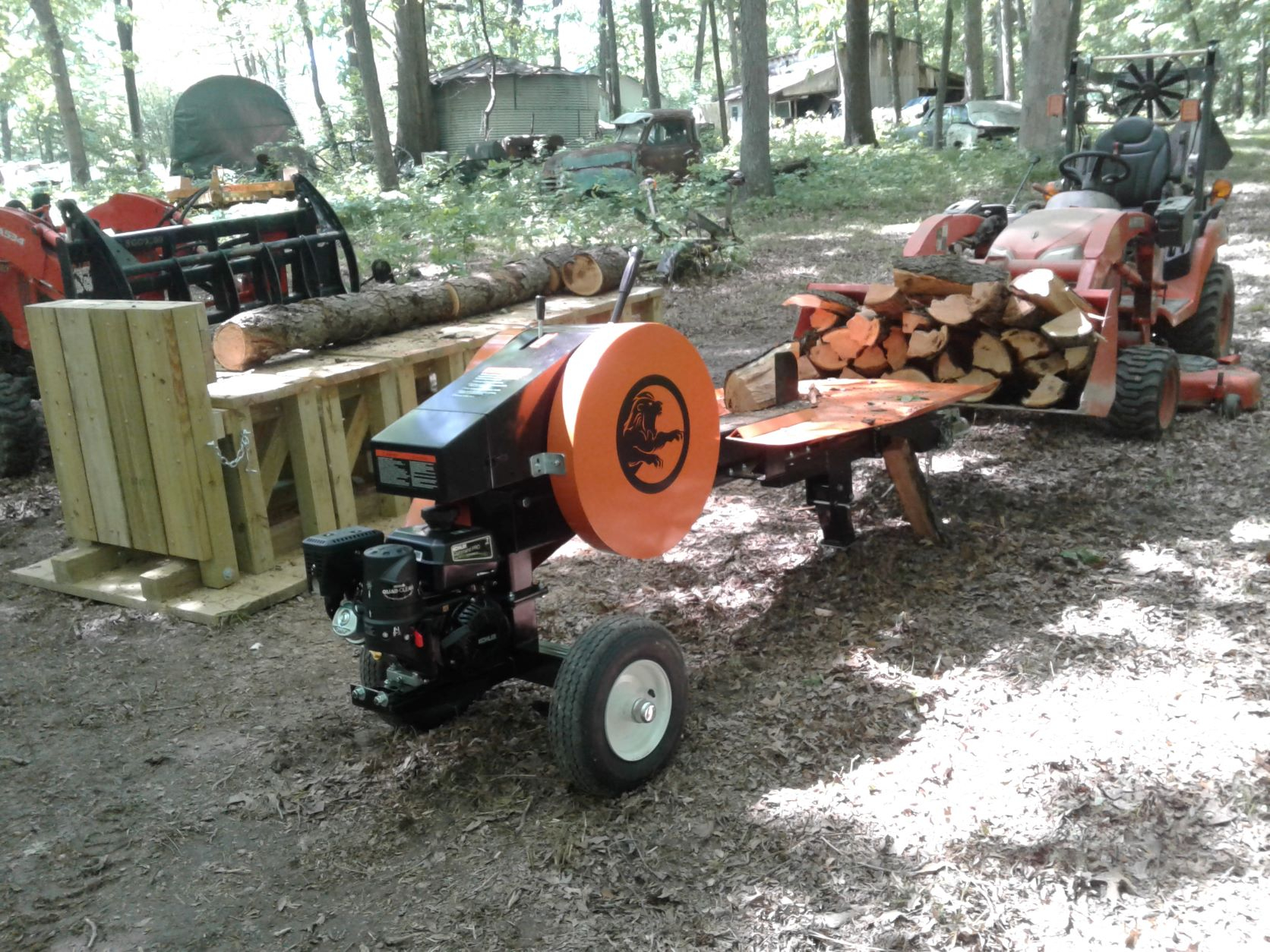

I build half cord boxes; I put the splits into them right off the end of my splitter and move the boxes with my tractor.
A few weeks before I use one, I cover it with a tarp so the surface dries out, and then the box gets moved to the house where the splits will be thrown threw a basement window to near the stove.
It's not too much work to pick a few off the basement floor to feed the woodstove.

One thing I dislike about my wood storage shed is that it is "last in, first out" rather than "first in, first out". In my perfect world I would have a storage shed that had roll up doors on opposite sides so I can keep putting wood in without covering up last year's carry over wood.
