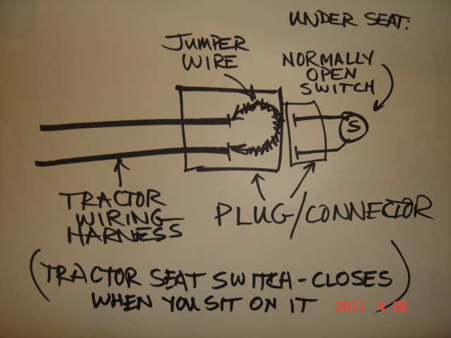

Again, a very crude drawing....

I just wired the plastic lever in the 'down' position...........that way I can 'undo it' in a second if the need arises.
   / Seat Switch #13
I stuffed a folded pc of cardboard between the seat and switch, now the engine doesn't die when I get off, That was a PITA, or I would have to engage the parking brake, on a hydra tranny machine :confused2:
Also when mowing, If I moved in the seat or hit a bump and took to much weight of it, it would kill the pto.
