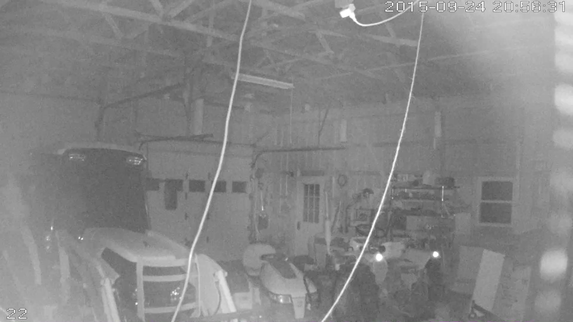

If you have power in the barn, run internet to the barn from the house and put the entire 4-8 camera system in the barn. It will simplify things greatly. Only one wire to run to the house (or you could go wireless internet to the house. 100' is not that far with directional antennas, but wired is always on with no interruptions). Then have they system send pictures/videos over the internet to a gmail account. Also, you can log into the barn system from a computer in the house to check up on things from the house.
What he said. With POI (Power Over Internet) camera systems it's easy to set up.
   / Security Camera Confusion #39
I'm kinda doubting the techo spy thief wants my 70 year old tractor or bags of feed. or yours either.. :)
I'm envisioning this mission impossible team zip lining in, then using sprays to look for lasers trip lines, using doppler laser microphones aimed at windows, 4 pt harnes rigs to lower into my barn, grab a bag of layer pellets, then high tail it to the back of the pasture where a black helicopter dusts off picking up their delta force chicken feed liberation team. ;)
   / Security Camera Confusion #40
I can see in my barn from my house, on my computer or on my phone. There are no lights on in the barn. Using ethernet over power with an IP camera, running across a 100' extension cord. NVR is in the house.
