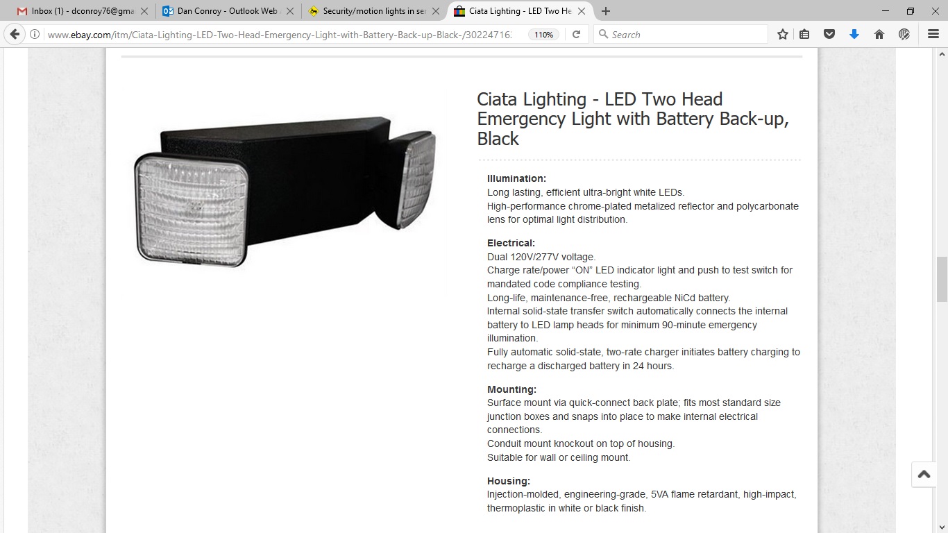

/ Security/motion lights in series #6
Is this what you are looking for. What purpose do you have for these lights? These are $24.99 on ebay.
Something like that would work. They are just for outside my shop. Just want them to come on when they detect motion. Definitely need to be waterproof but nothing fancy.

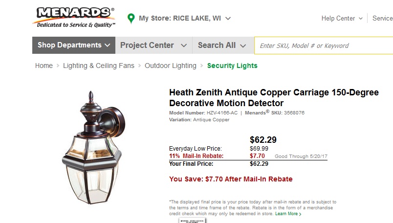

/ Security/motion lights in series #14
Now I get that they are for outside. I actually put a 2 floodlight motion light on the inside shining up to give basic illumination until I find the light switch. On the outside, I have 3 motion detecting coach lights on either side of my garage doors, They are dusk to dawn, meaning they are on 50% power for 2-4-6 hours after dusk, and illuminate at full power when motion is detected. I have 75 watt equivalent dimmable LED bulbs in them (100w was too bright). They are nice looking when dim, and illuminate very well when bright. I did not wire them to come on all at once, but there was really no need as they are all on at 50% and trigger well when you are anywhere in the vicinity (just ask the deer!).
