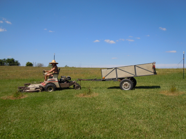

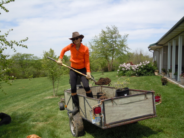

here is my trailer after about 20 years of abuse. The axle is Renault Fuego (Trailng arms sprung by torsion bars). The front and rear gates can be opened and removed. My guess is that it weights about 200 lb. I can just about lift it.
It cost about $500 (1990 dollars) including an Hobbart arc welder and angle grinder. The axle was $50 including wheels and tires at local junkyard, the most expensive part was the cupling and the lights.

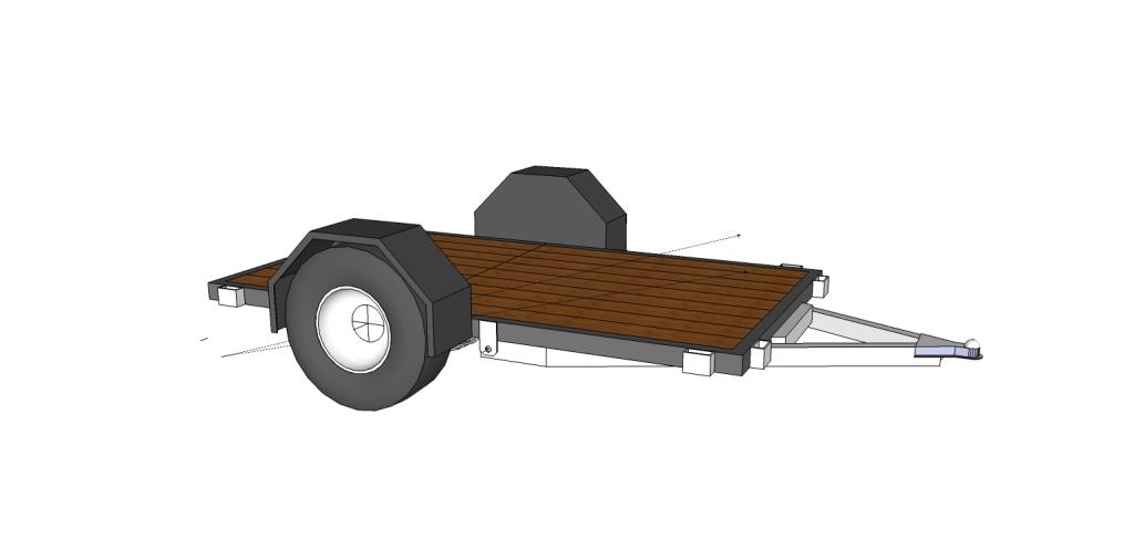

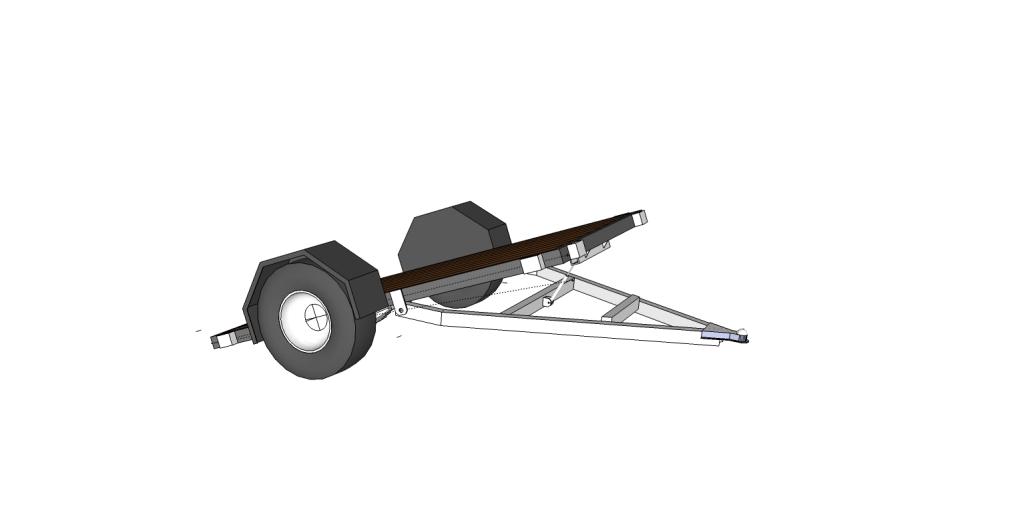

Here is the current plan. I'm still debating about a different suspension vs. the leaf springs. Notice that I drew in a gas spring between the tongue and the deck. This is my way of staying close to a 60/40 split for the axle while still letting the deck tilt without a helper standing on the tail. The way it's drawn, the trailer will stay flat until I start the tilt manually. After I start it, the gas spring will kick in and then hold the tilt until weight is put on the front of the trailer again. If it works on this little trailer, I'll do something similar with my car hauler size trailer.
