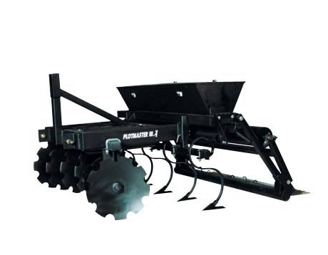

is this it?
   / seeder box on a disc? #8
is this it?
That's not the one I saw at the NFMS, but it would work! What I saw was a standard 3-point hitch tandem disc w/a Herd rotary seeder on top, and a tine bar (very similar) to what you show attached to the rear of the disc.
