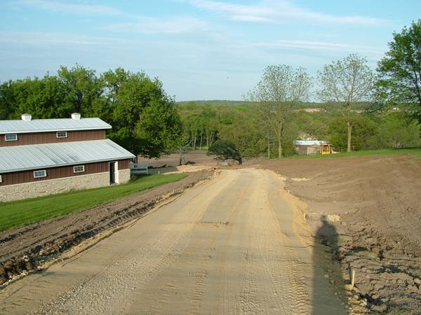

New Kubota bx2230 in the barn.

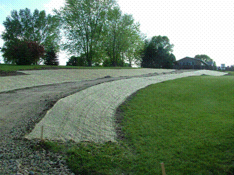

My grass 4 weekes after I started.

Doug,
Thanks. That grass and slope looks great. I'd be in heaven if by August my grass looks that good!

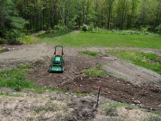

Here's nearly done smoothing out new topsoil yesterday.

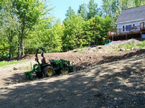

Another view of the smoothing process. BTW, that's just a 6' x 8' piece of chainlink fence ($2 at junk yard) with a 2' chain threaded along the far end, pulled forward to attach to another one threaded through the near edge and then wrapped on my "I-Match" so I could raise and lower it a bit.

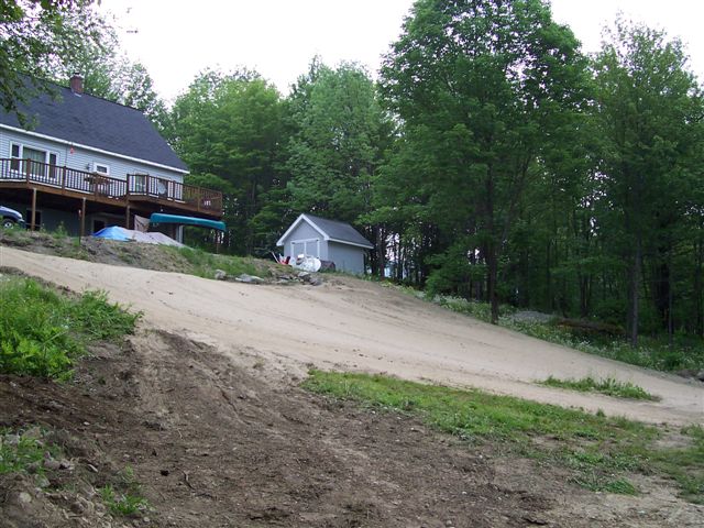

And then the RAINS CAME /forums/images/graemlins/frown.gif. Saw it rolling in so my wife and I pulled out every tarp we had and protected the steepest area. Fortunately, it didn't last long and we lost no soil. However, it did put off the seeding and straw rolls 'til today. Good weather forecast so, I'd better get to it. Cheers!
