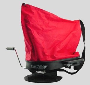

I plant a lot of clover and use a bag seeder and yes it is very fine. Try and get the seed with the innoculant already on. Here is a picture of the seeder I use:

We use a broadcaster like Dave's. There's a number of different clovers, annual and perennial. One we've had good comments about, is crimson clover thickly sown it make a brilliant crimson field, it's an annual but will somewhat reseed and eventually get replaced. Like bcjmmac says, mix in some perennial clover and it will take over where the crimson doesn't come back. Your still going to have some blackberry maintenance because those pesky birds insist on eating them and spreading the seed from over head. Around here it works best if sown in fall to take advantage of the moisture and mild winter temps, come spring, your field will have a good start and come up pretty lush.
