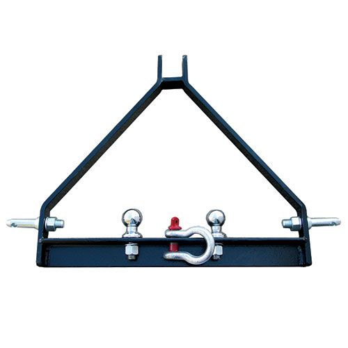

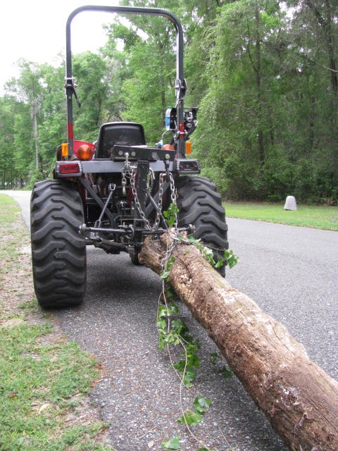

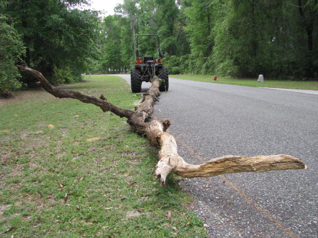

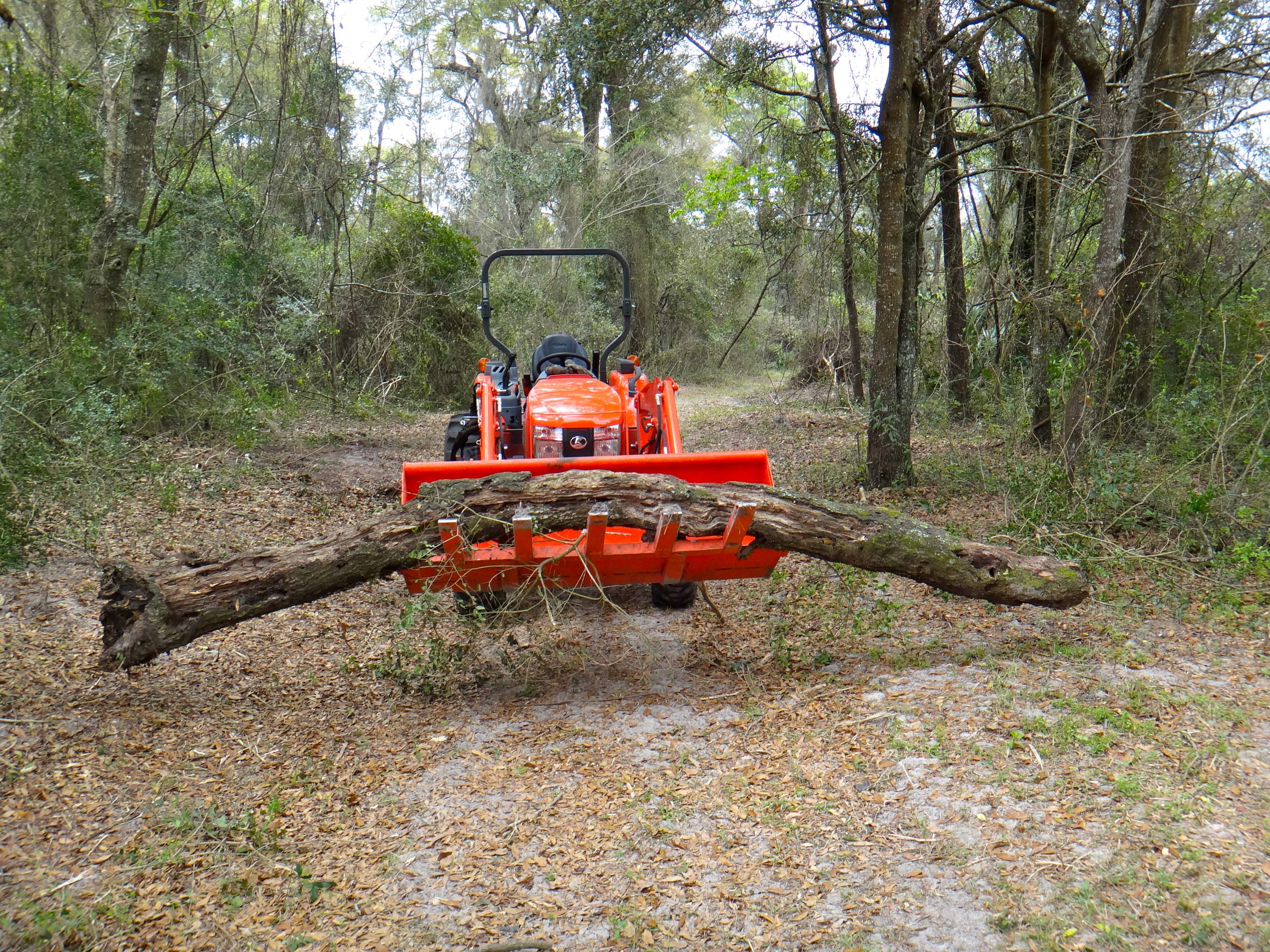

I guessed this soggy Water Oak trunk weighed 1,400 pounds.
My tractor-loader weighs 5,500 pounds.
Had I not had 600 pounds ballast cantilevered on the Three Point Hitch, the tractor might have teeter-tottered on the small, narrow, front wheels, lifting both rear wheels in the air, with the possibility of a rollover.
Be very careful when you begin operating.
