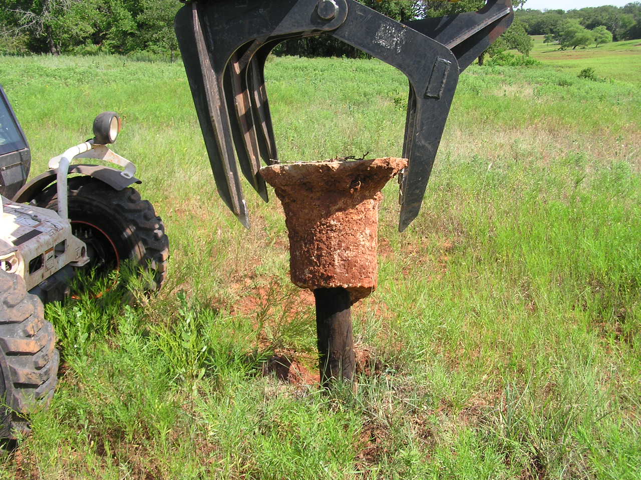

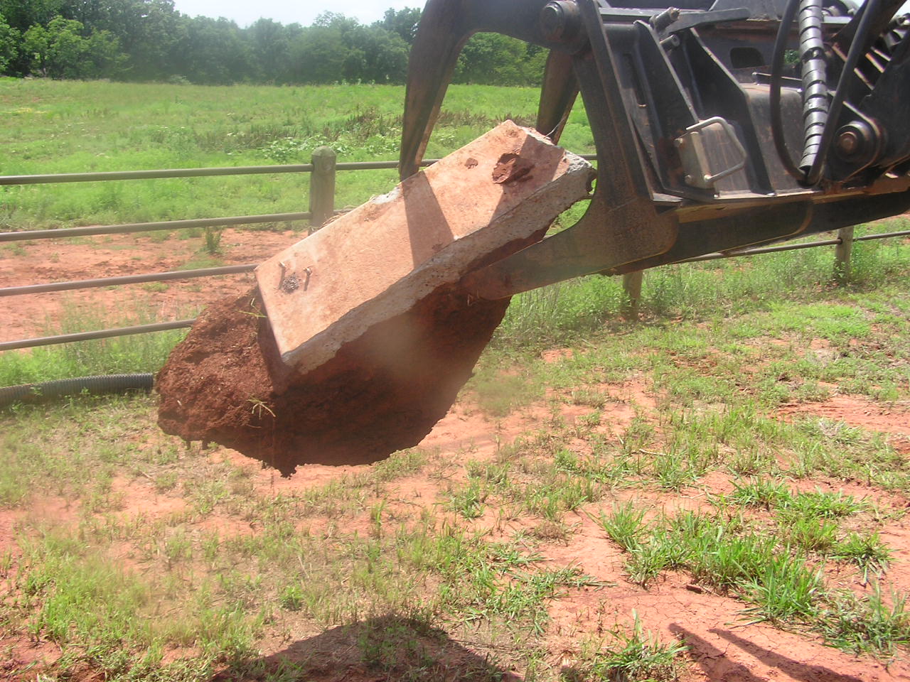

Have a small project of putting a single layer of sandstone blocks before a steep drop, about 25 stones. It will use either of these blocks. I 'm going to dig a shallow trench 8 inches deep fill with sand for a couple to make leveling easier.
16x16x40 inches 815 lb (400x400x1000mm 370 kg)
20x20x40 1278 lb (500x500x1000mm 580 kg)
I have a jd tlb 110 with 4 in bucket and thumb on the backhoe.
I'm a little concerned if I use the 4 in one bucket to grab stone with I will damage the edges.
I have some $$ in the kitty for tools maybe a grapple bucket. I think the backhoe will lift the smaller block but will struggle with the larger ones.
My better half of course likes the bigger blocks, and I am sure if this project is a success more blocks will turn up for other projects around the property
Thanks
Roy

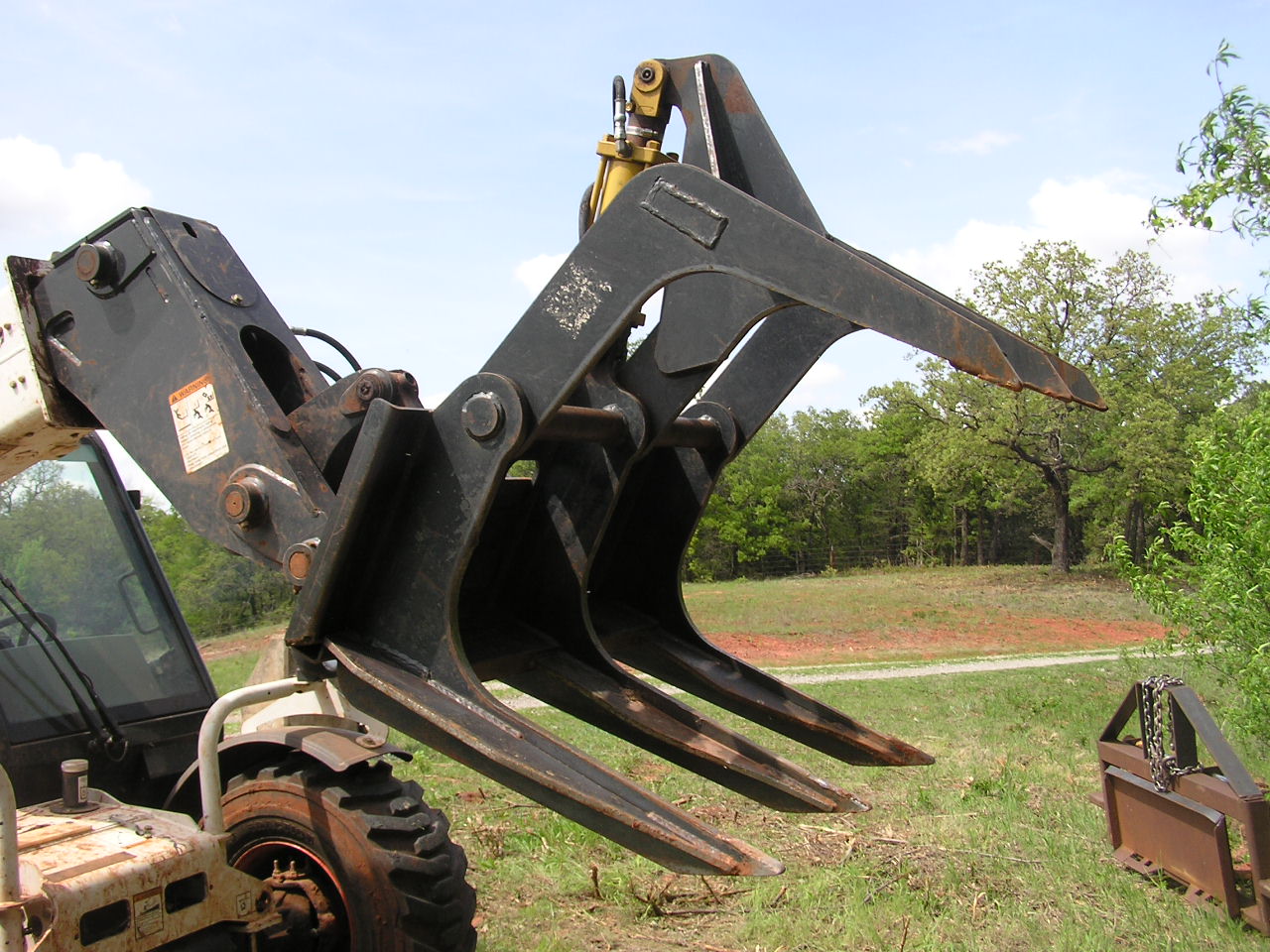

I vote for a grapple. The Rake Shop can make what you need: www.TheRakeShop.com / Root Rakes Grapples Attachments & Skid Steers
Mine is a heavy Gorilla Grapple, but they have one that is similar or could copy this design.
Could also put rubber pads on the tines to protect the rock.
