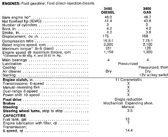

Only comment that I differ on with you @Sportsman762 is that I believe it has a 6FX4R manual shuttle transmission. It still requires clutching, but not as clunky as an 8Fx2R transmission.
I do agree with OP needs to be mechanically inclined. This machine is a very mechanic friendly machine. The lighter loader and smaller backhoe would be a good choice for the price vs any more recent machine.
Good catch on the transmission. The decal that Messicks lists for the 3400 with 6x4 transmission sure looks like what is on the tractor. Sure is an odd transmission. I am use to having a separate lever for the reverser. Looks like a bit of a pain to use but much less than the 8x2 transmission I thought it had.
Here is a snip of the sales flier I have.
