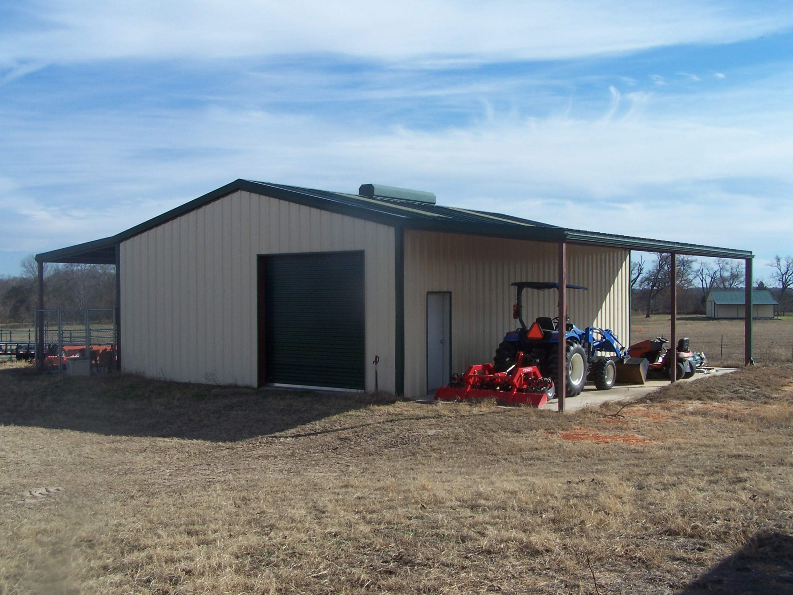

Here's the 30x50 Carolina Carport we put up last year. It's a gravel floor but the large doors are really a must have for tractors, campers etc. good luck!
Nice! Love the color choices!

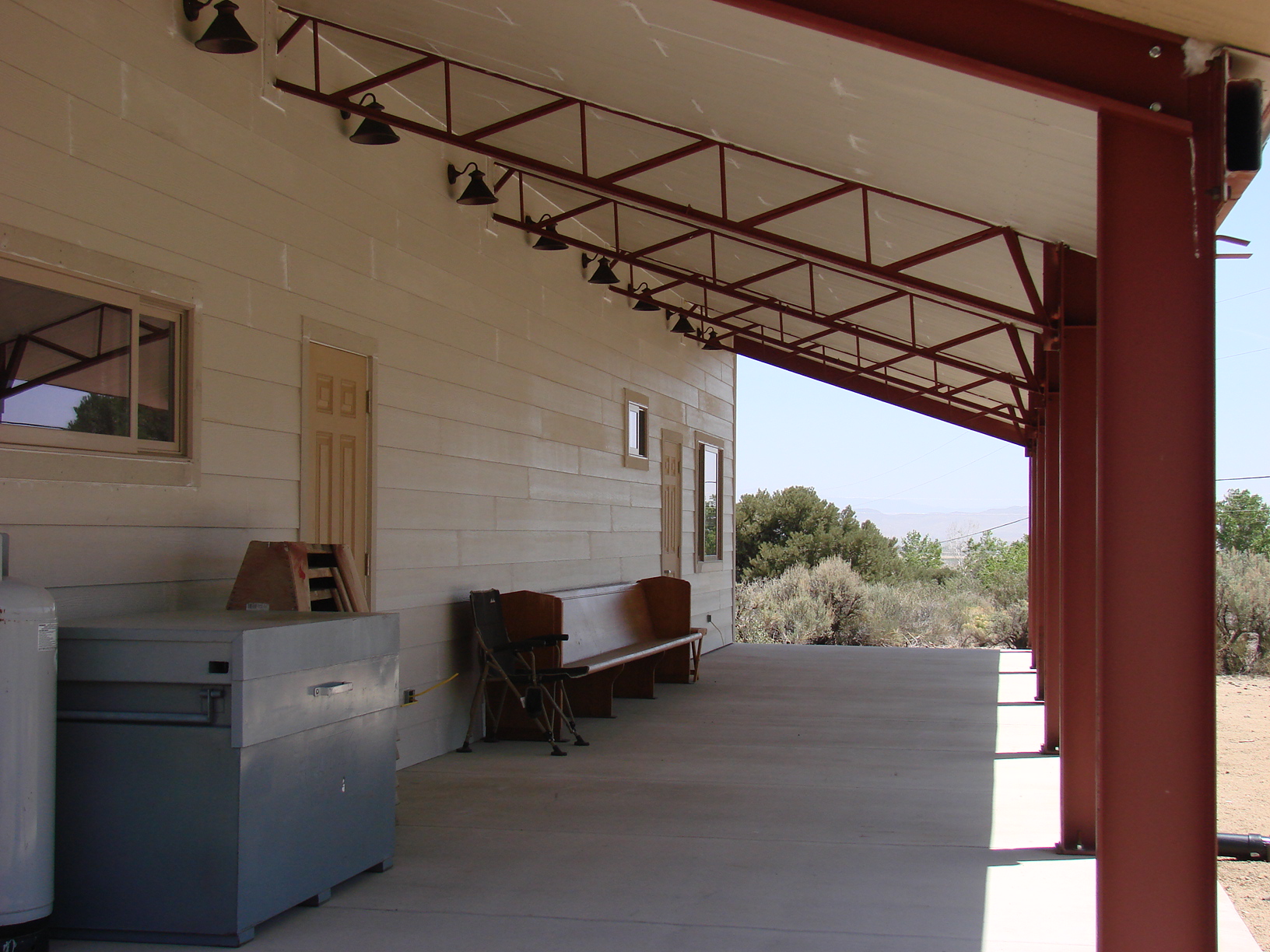

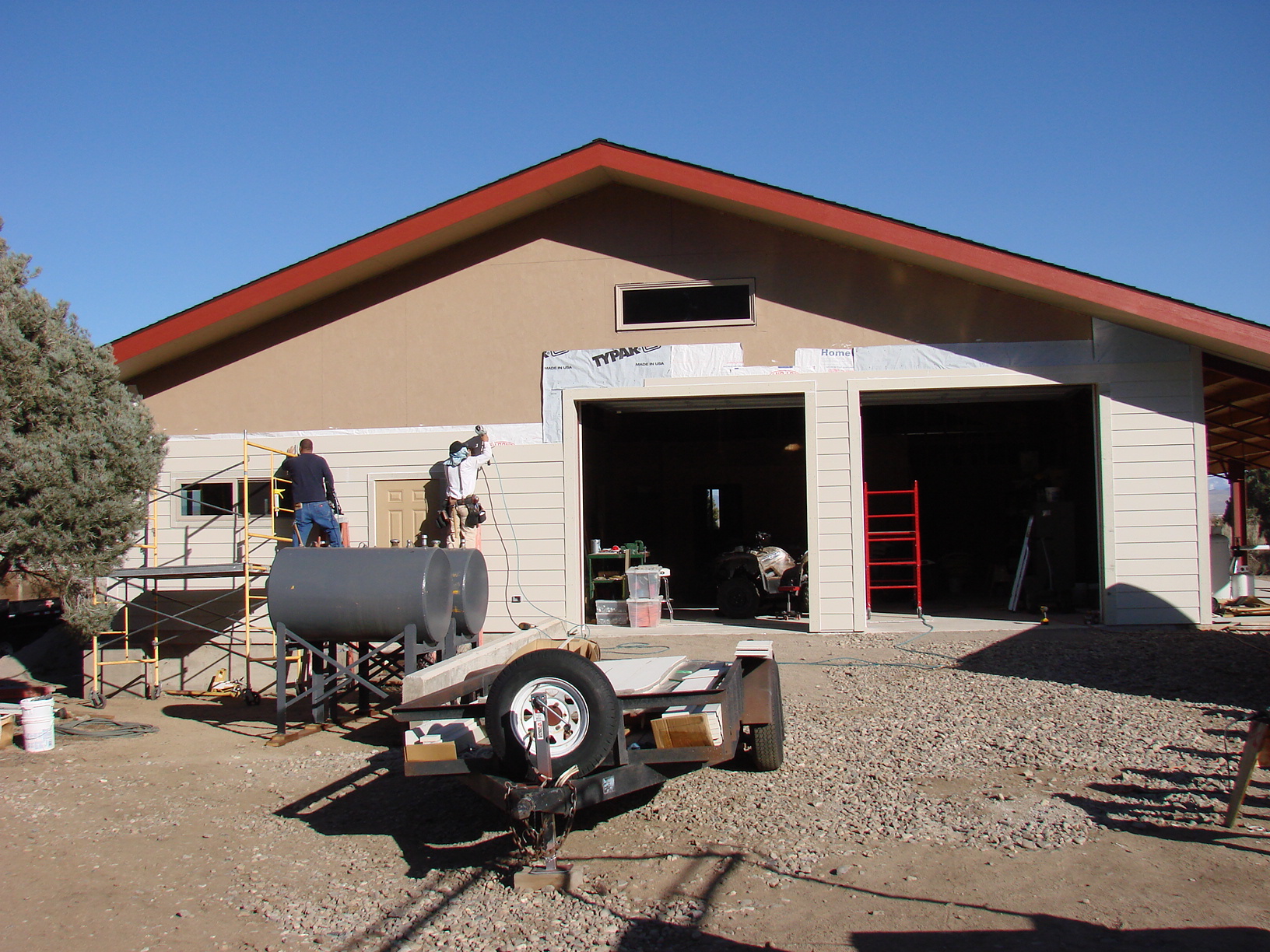

Aaron,
Big doors are nice. I went with two 10' X 10'. They are a bit tight to get through with equipment, but I couldn't get 12' doors in with my floor plan and I wanted two doors.
The large porch is a very nice thing! You'll enjoy yours too.

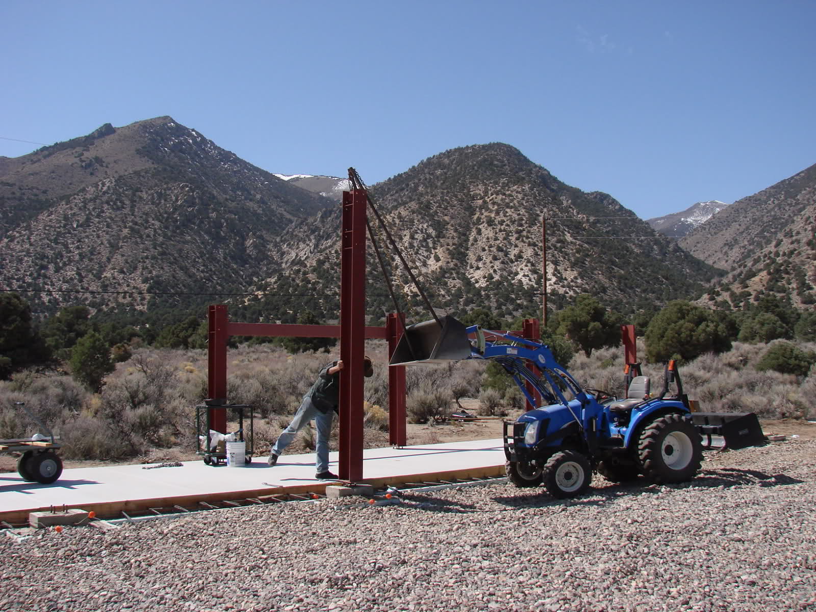

I also included a picture of me using my "bucket boom" to set the steel. Might work for you too.

   / Seeking Tips and Advice on Metal Building #19
Aaron,
Very nice setup.
