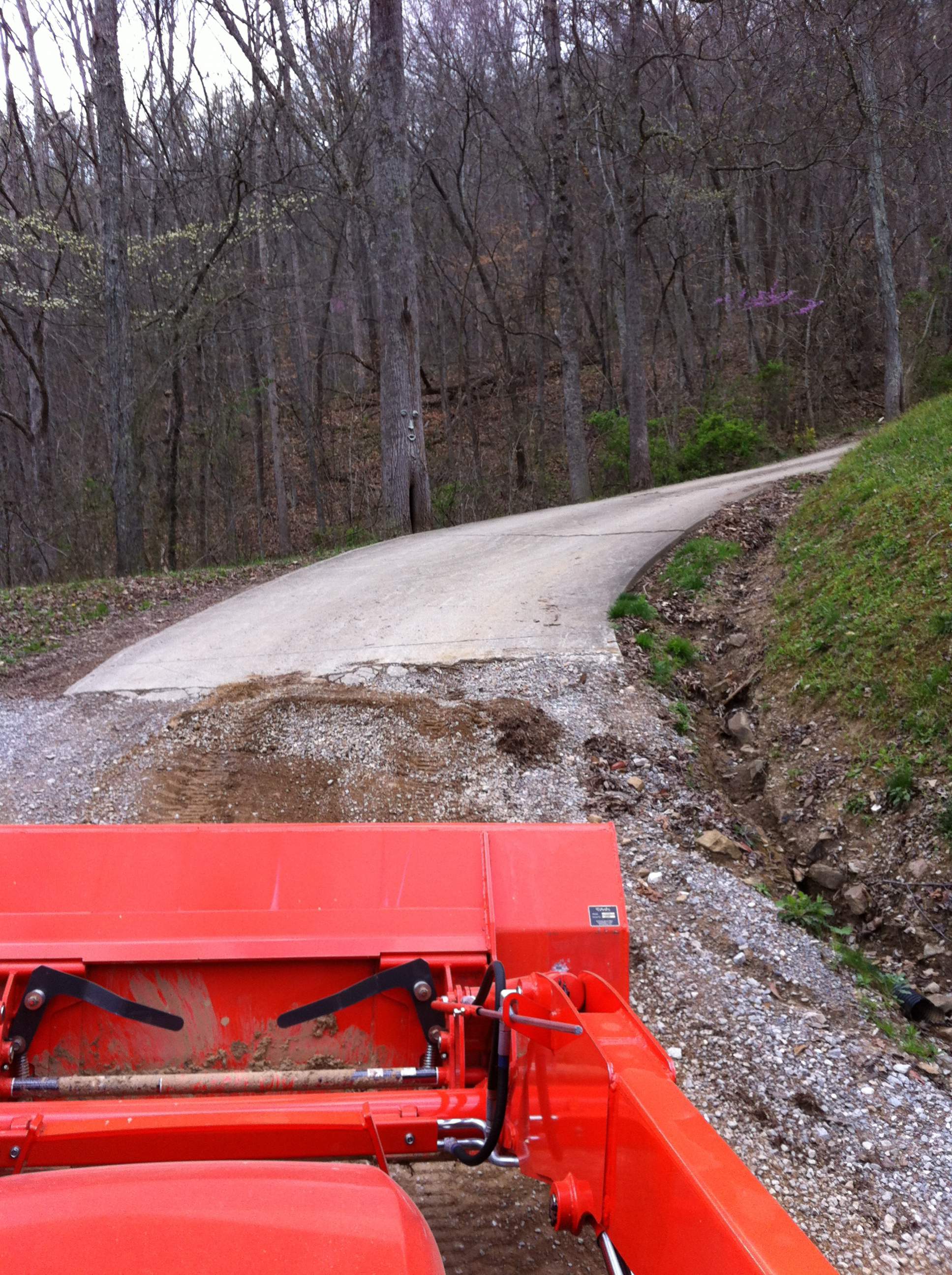

I have the opportunity to "upgrade" my L39 to an L45 at a rather attractive offer. My L39 has 680 hours and the L45 has 205. Both are equipped similarly, but my L39 has 3rd function hydraulics and a soft cab w/ heat.
I'm seeking advice and words of wisdom from those who may have made the same "upgrade" from the L39 to the L45.
My initial concerns:
1. Lose my 3rd function (just means I have to spend the $800 again and do the install)
2. Lose my soft cab ($1300 to replace)
3. The HST. While everyone seems to swear these things are the cat's meow, I live on a hilly property. I have the luxury of having both machines at my house right now. I was disappointed when I had to stop, shift to L and then continue to make it up one of my hills with the machine unloaded. Nothing in the bucket, no brush hog running, nothing. Then at the top of the hill I had to stop again to shift back to M to resume a reasonable ground speed. With my GST I would have just flicked the gear lever down at the bottom of the hill (if even necessary) and then back up at the top. No stopping, no waiting. I need to go out and move some pallets with the L45. I think the fine adjustment without having to use the clutch will be nice with the HST.

I have the L45 and LIVE on a hill. It goes up the driveway which is a steep hill no problem in med range and in low on the steering colloum shifter. The auto throttle is on all the time, unless i am using the pto. Very happy with my L45. Although i can't compare to the l39 because I have never used that model.

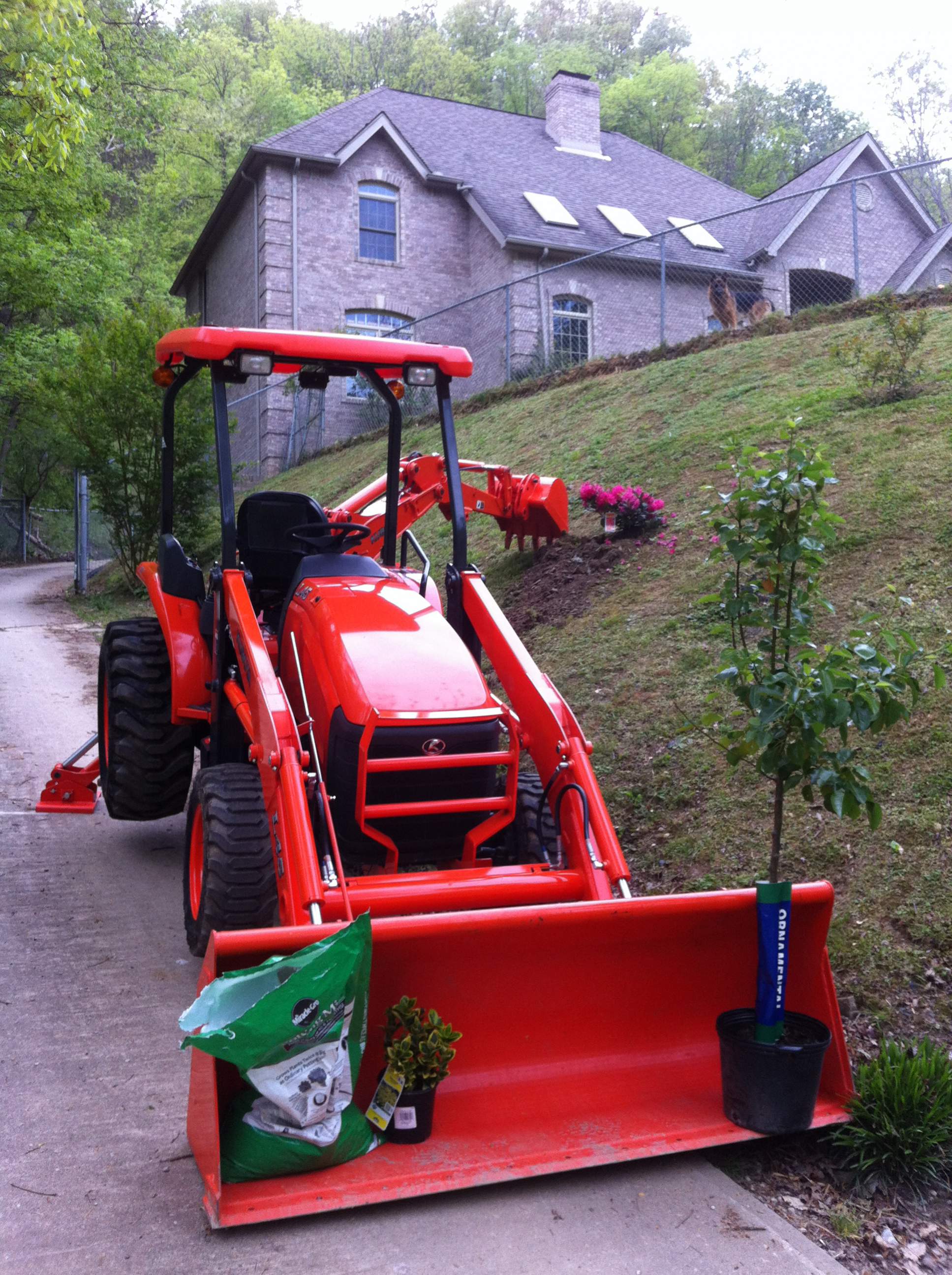

As an HST B21 owner who upgraded to an HST B26 and then this year to an L45 I would like to point out that the L45 does not have HST. The L45 has Kubota's HST+ with features that are not available on HST tractors I have driven:
1) HST+ has a feature called Auto-Down Shift. You need to press the HST mode button until Auto DS light up on the side panel to turn this feature on. When engaged, if you start up a hill in M range and the transmission senses too much load it will automatically (without you stopping or pressing the clutch) shift to a lower range and climb the hill and when you reach the crest it will also shift automatically back into high range. It sounds to me like AC does not have this turned on because I have gone up many steep hills on my porperty in M and Auto DS has never failed me. Check the side panel of the tractor - if the green light for Auto DS is not lit, than press the HST mode button until it is. I have left it on for months and never had a problem. Note that Auto DS works in all three ranges so you have Low-Low, Med-Low, High-Low and Low-High, Med-High and High-High. I think of it as being similar to the transfer case on full size pickups - but you have to stop and shift into neutral to switch ranges on a pickup - Kubota HST+ does it without any operator intervention. If you don't want to leave Auto-DS on, there is an orange (why that colour?:)) lever on the left side of the steering column. As you are driving, if you push this spring loaded lever down, the L45 will immediately shift into low range (the turtle will light up on the side panel) and if you then flick the lever up the L45 will shift back to high and the rabbit will light up on the side panel.
2) HST+ includes auto throttle advance which means when you are doing loader work the HST+ pedal operates like the accelerator on your car. Press forward and the engine revs up and away you go - press harder and the engine goes faster and so do you! You only need to use the manual throttle when you are operating the backhoe.
3) HST+ also features a rotary knob that allows you to adjust the sensitivity of the HST+ when you change directions or come to a stop. If you dial it up to the most sensitive, as soon as you realease the pedal the tractor comes to an abrupt stop - too abrupt for me. Turn it all the way the other way and it stops much more slowly - I have left mine in the middle which works fine for me.
4) HST+ has a feature called Stall Guard which means if you push into a pile to fill the bucket rather than the engine stalling the transmission will reduce force. This is also enable by pushing the HST mode button. If you push it repeatedly you can eventually get Auto-DS and Stall Guard both lit up at the same time on the side panel.
There is a good YouTube video on Kubota HST+ which demonstrates all the features and how to activate them. The video also talks about Cruise Control which is on some HST+ Kubota tractors but that feature is not on the L45 so don't waste time trying to find it!
