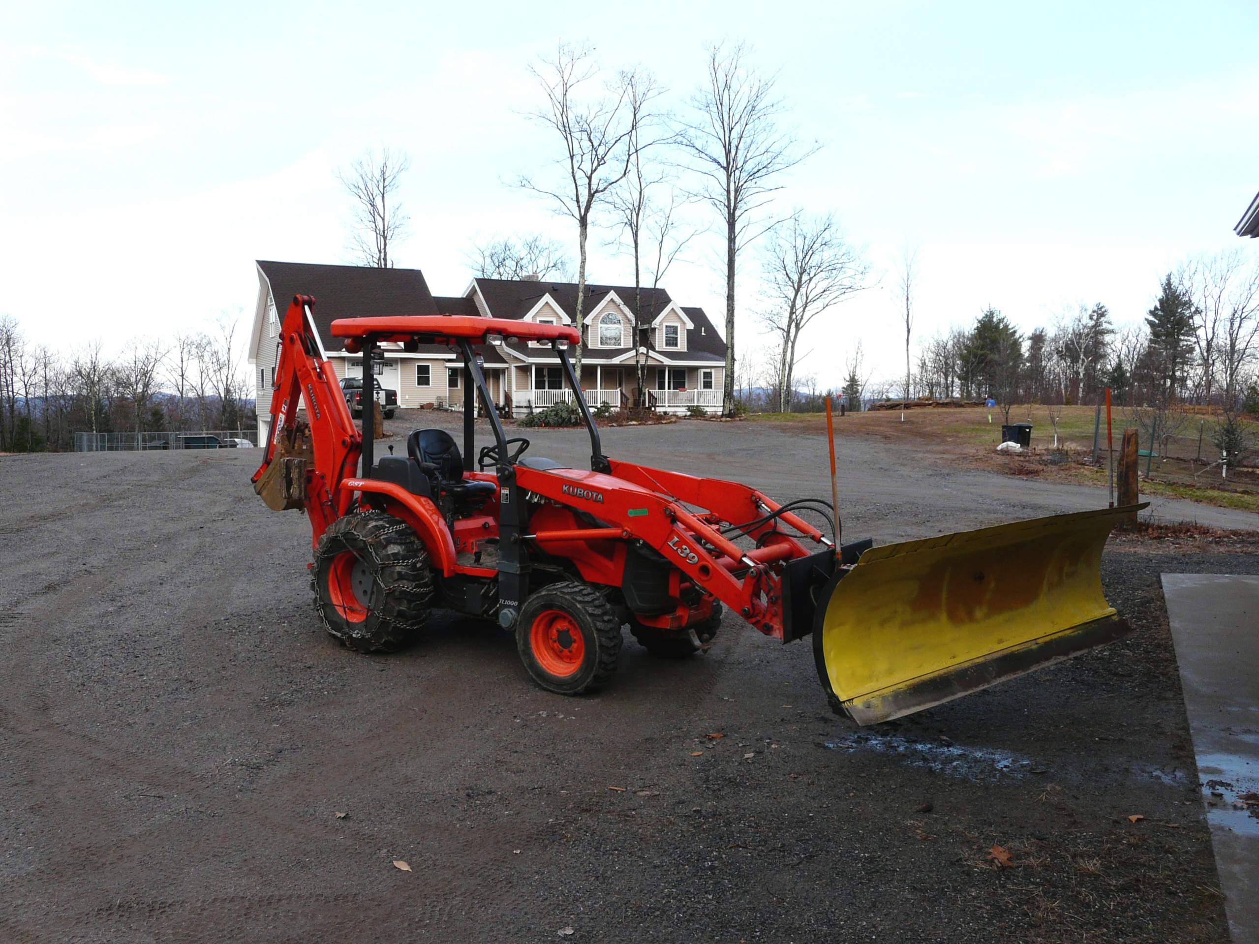

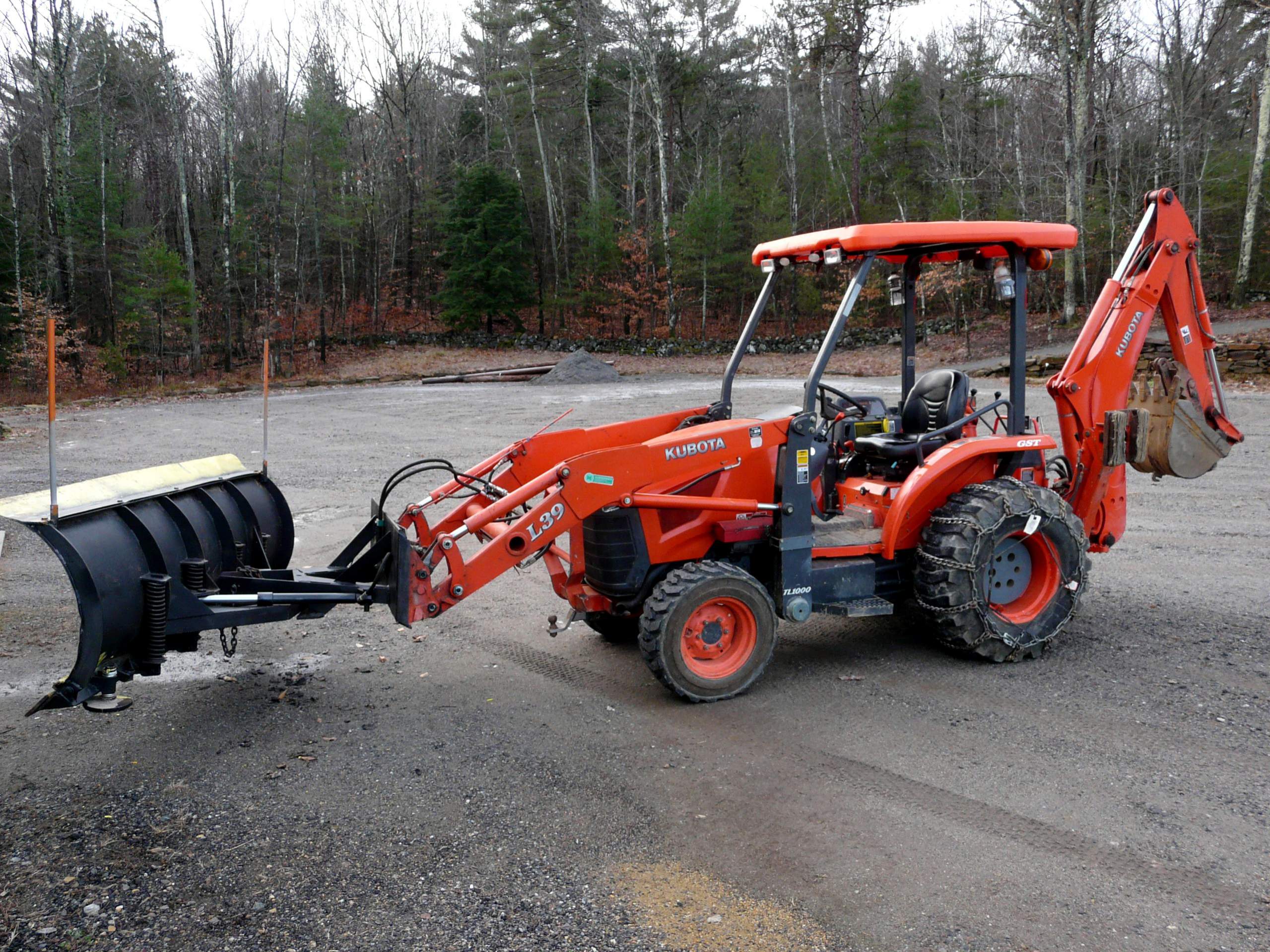

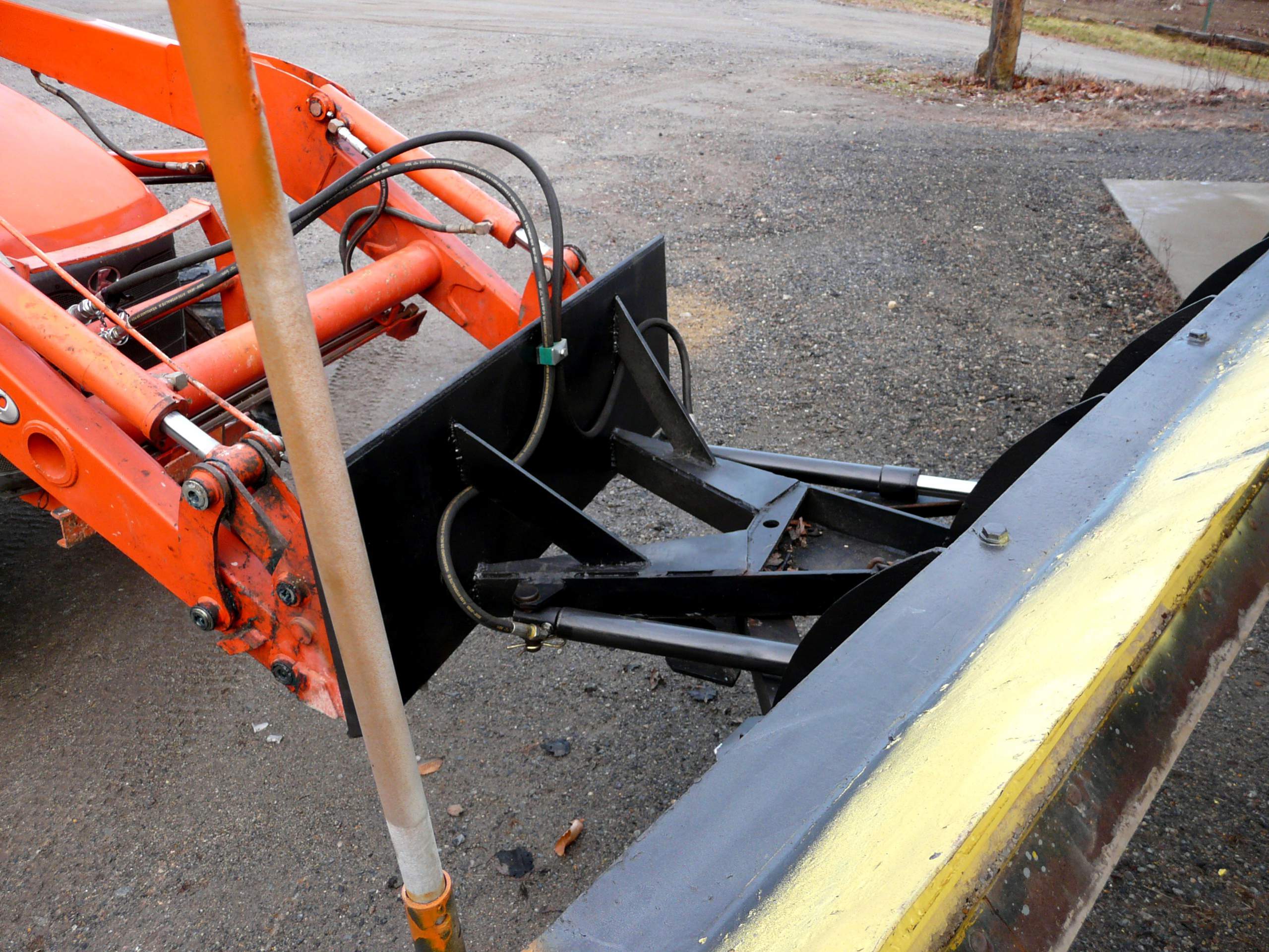

$600 and a lot of labor & I have a good plow
