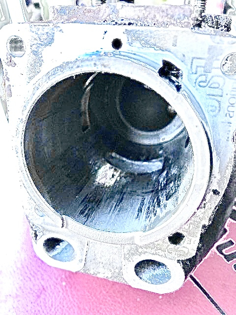

What made me think that the exhaust side is showing is the round hole at the top center above the cylinder skirt could be the hole leading to the carb for the fuel pump pulse.
The more I look at it, the more I think you're right. Those two ports are on the exhaust port side from the pictures of the 570 that I've seen. Would love to see the other side of the inside of the cylinder and the piston.

#106
I am assuming that is the exhaust port in the cylinder in the picture and not the intake port. The problem is either that is the intake port and the saw ingested a foreign object or the piston was installed backwards at the factory. That piston damage is were the anti-rotation pin would be located which should be installed toward the intake port and would set between the intake port and the transfer port in the cylinder.
This saw is 2011. Was used by professional cutter before i got it in 2016. Was working fine before this happened. Foreign object from where? Fuel line? New cylinder is on backorder... still waiting

Running the saw set to lean will over heat and seize it up also if the muffler is loose and it's sucking air into the cylinder.

Here's a pretty good video that shows several causes of scoring. The examples he shows all lean towards raw gas (no or not enough oil). Intake side is scored heavily. I'd like to see the other side of the piston.
Interestingly, around 11:00 he talks about the cold seizure we talked about earlier. Not warming the engine before going full throttle. Not the cause in this case, but a cause of piston scoring nonetheless.
A foreign object could be anything. Especially if it was ever started with the air filter off. Or a broken part. Tip of something. Unless you find it, it's all a guess.
Was the piston scored all the way around, or just on that one side?
If that is the exhaust port and that side of the cylinder scoring lines up with the side of the piston that is shown, the piston has been installed backwards which could cause the ring gap to snag on the exhaust port.
The foreign object is the ring anti-rotation pin that came loose from its location in the ring groove, opened up a area in the side of the piston and then jammed between the side of the piston, and the cylinder wall which is the reason for the deep gall mark down the side of the piston.

On mine the piston and cylinder were scored on the exhaust side, which was most likely from straight gas.
/ Seized chainsaw #114
For seizures caused by overheating, insufficient oil or detonation (which is most of them), the damage is always on the exhaust side. It's because that side of the piston is hottest. So the oil film fails there first, or the ring get stuck first and then overheats the piston and the oil film fails.
If the piston was installed backwards causing a ring to snag in a port it would have failed immediately. From the pics you can see the engine has been run a number of hours.

This is the result of running the saw less than 5 min. with a loose muffler. I knew better when the saw started racing as I'd had it come loose before only this time I never stopped to fix it. This is a 30 yr. old saw with hundreds maybe thousands of hrs. as it's bucked over 100 cords of firewood for my use and bucked logs on a landing 12 hrs a day for 3 winters when I was logging as well as fell and cut all the logs for my mill over the last 20 yrs. The ring seized right in line with the exhaust port and stopped the saw dead. I could have got away with just replacing the piston but for $65 the price of cylinder and piston I went for it. This can also be caused by running the saw to lean when when adjusting the carb to exceed the rpm the saw is rated for.
