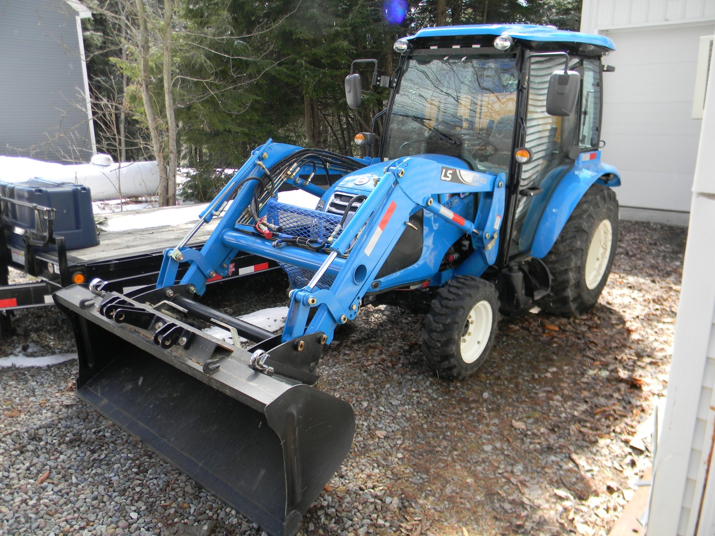

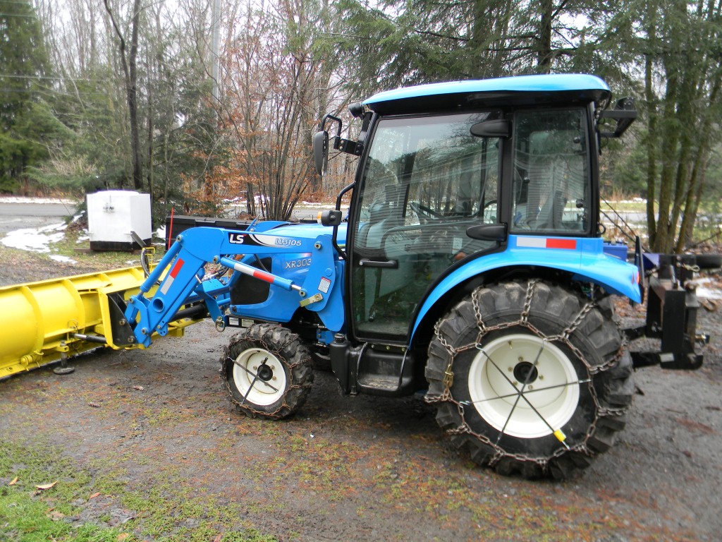

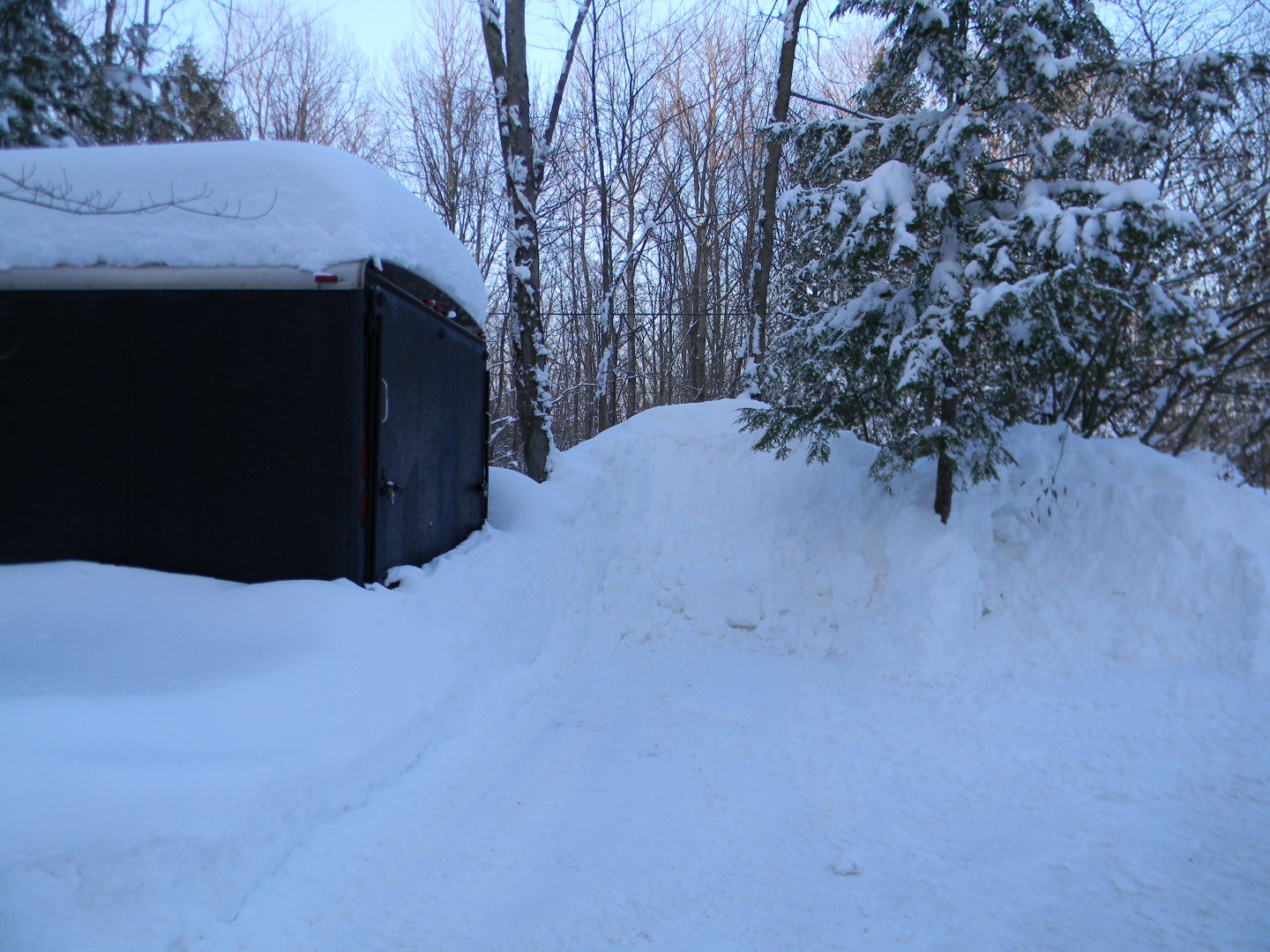

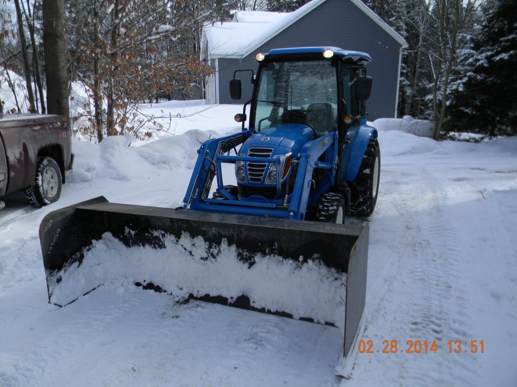

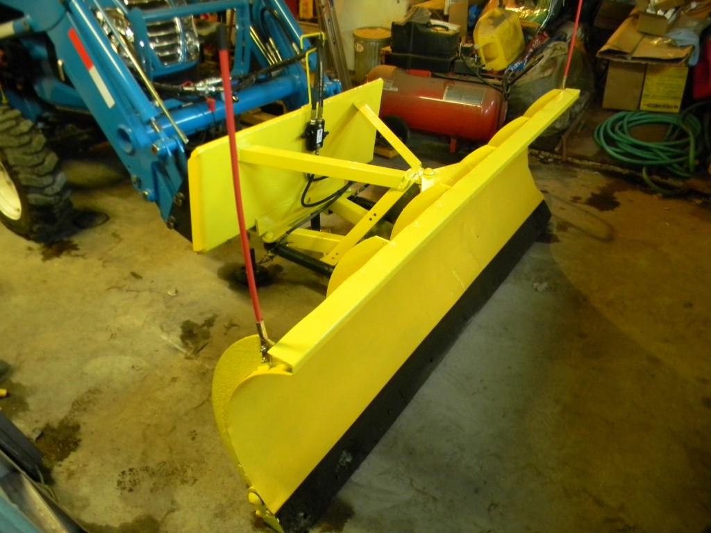

I'm in the snow belt just a little S.E. of Lake Ontario and snow plowing / moving is the main purpose for my tractor. The rest of the time the tractor does misc. chores like you do. My driveway is also gravel (runner crush). My tractor is the LS XR3037HC. I bought this last year to have a warm cab to plow with. I have a snow pusher blade, Made a quick attach 7'6" power angle plow from an old truck blade, and the 66" loader bucket for moving piles. I have loaded the rear tires with washer fluid, chains on tires for tractionon hard pack and ice and have rear ballast if needed.
48" would be way to small for me to plow with but if that's what you can afford that's what you use.

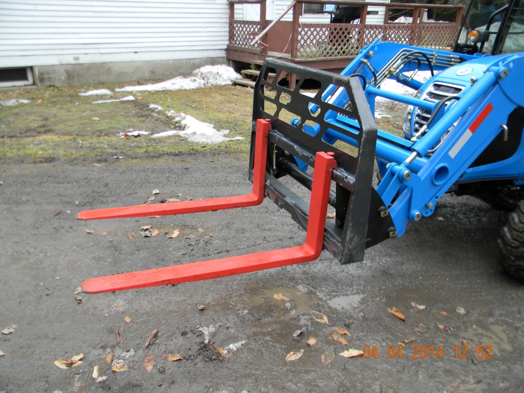

If you get the tractor and it has a quick attach bucket a set of forks is a very handy tool to get. Also, if you get half the snow I do you'll soon out grow that tractor but its a good place to start. As mentioned, I'd look around for a larger used tractor with a verifiable service record that's been taken care of.
My neighbor has a small MF GC2300 with a small loader (I think its 48") for his driveway. It takes him a while but he can peck at it all day being retired.
