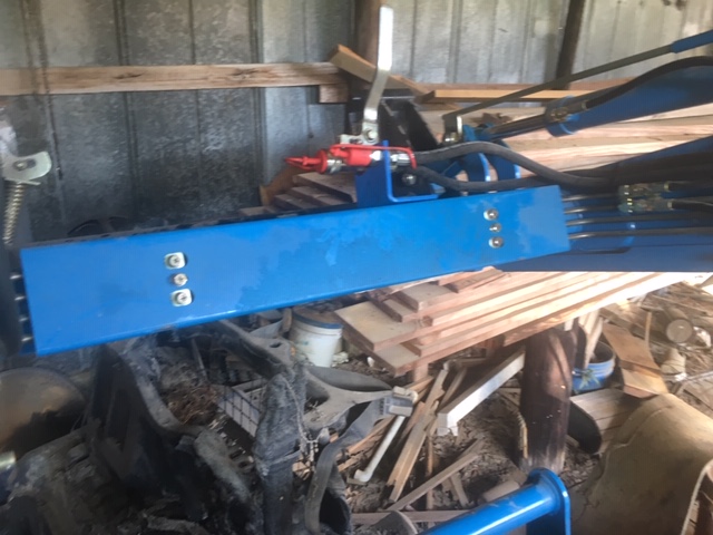

   / Self installing 3rd function? #13

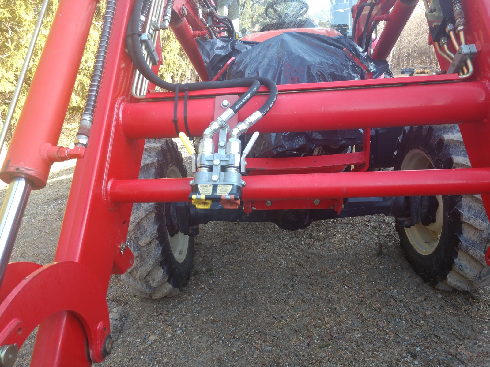

This is the hook up after i made a bracket to hold quick connections, i considered using the WR Long 3rd function and doing the installation but decided to try the rear remote first, I'm definitely pleased with the rear remote hook up and no plans for a 3rd function valve just don't need it.

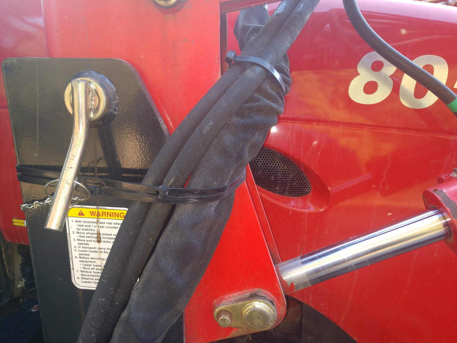

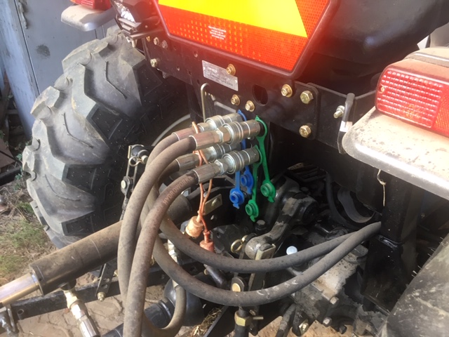

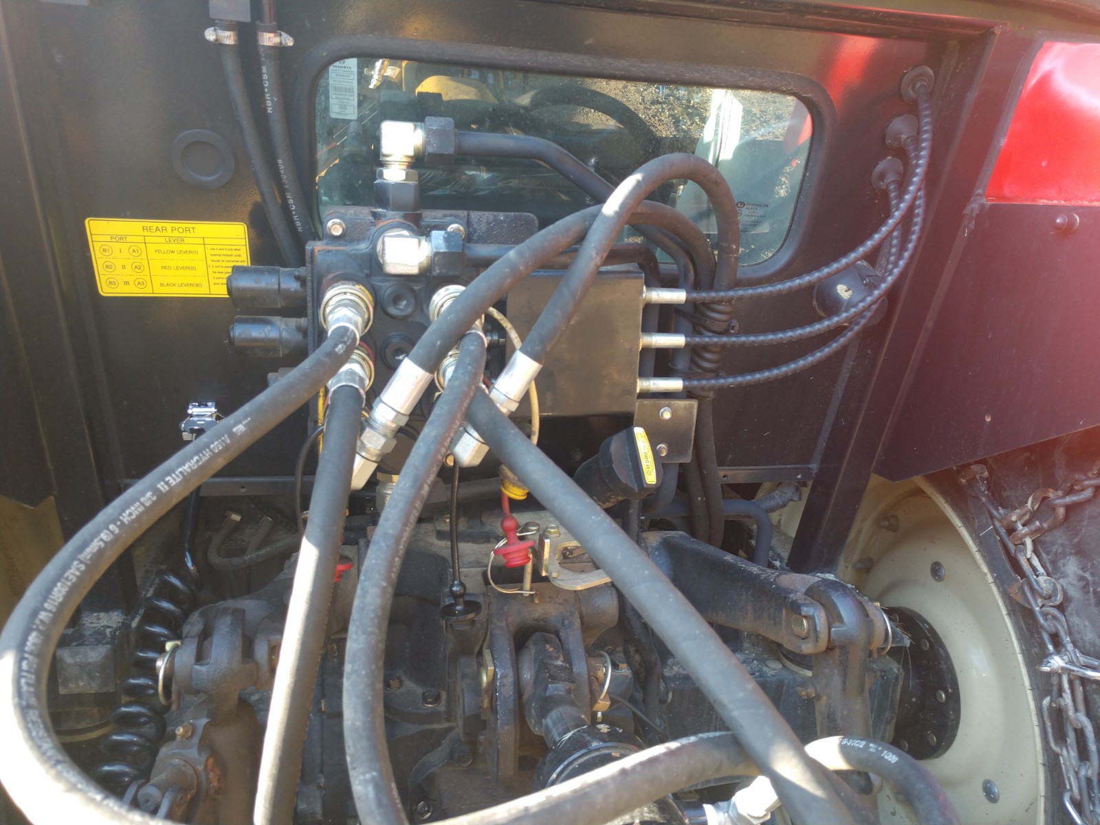

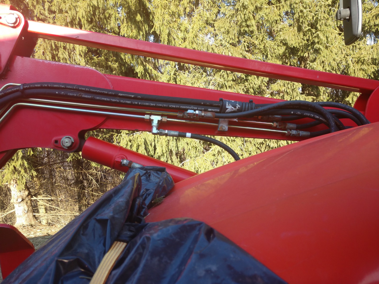

   / Self installing 3rd function? #14
I also ran lines up from a rear remote for my grapple, it works good and isn't too bad to use.
If I was doing it again and I have been contemplating doing it any way I think I would go with a diverter on my curl function with a switch mounted on my loader joystick.
in this picture the lines with the elbows in the bottom remote are going to the front;
in this one coming up along the loader frame;
then along the loader arms to the front;
then the higher priced part of my rigging, a connect under pressure quick connector set;
I don't recall what I gave for the quick connector, it was a find on ebay quite a while back,
the hoses and fittings came from surplus center, the male quick connects from one of the farm supply stores around.
