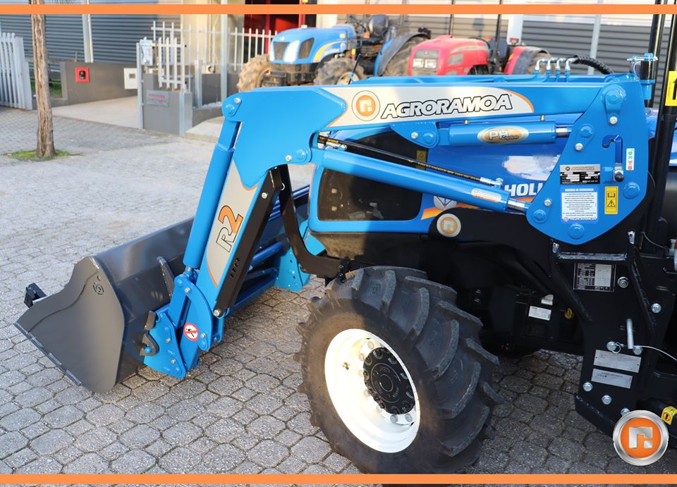

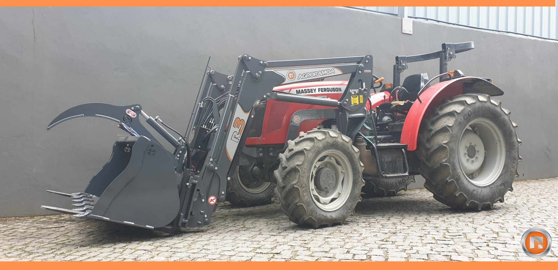

Here is a few examples of different styles.
Non self leveling:
Hydraulic self leveling, note the smaller cylinders over the lift cylinders:
Mechanical self leveling:
