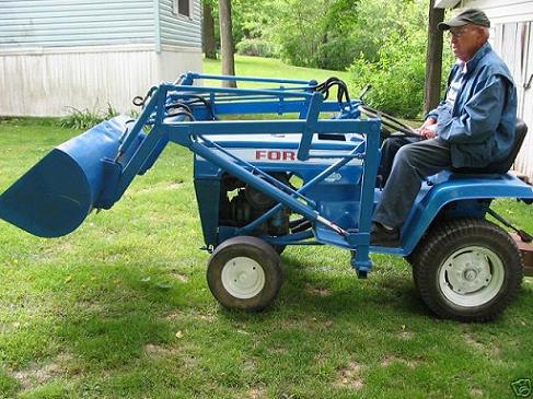

Self leveling loaders refers to a mechanism, either mechanical linkage or hydraulic, whereby the bucket maintains its relative angle to the ground throughout the loader lift range. I have not seen a hydraulic system on smaller tractors, but I have seen several examples of mechanical linkage designs. I thought some pictures would help the discussion.
The pictures will be in order 1) theory of mechanical linkage, 2) small Yanmar, 3) small Ford, and 4) a commercially available (Trima) self leveling loader.
5-6) In my opinion the coolest loader is a high lift version from Frey--They make the linkage type and conventional also. The High lift version is a linkage type with a twist in that the loader arm straighten through the lift range moving the load more forward and higher than what conventional loader arms would be capable.
When I find it again I will post a link for the hydraulic leveling system.
