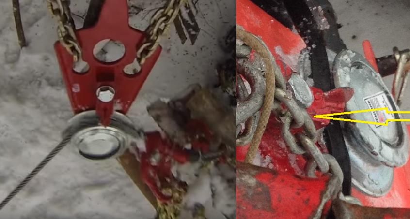

Looking at this pic ^^^ now on a desktop computer, it sure does appear that those sliders are for a much bigger mainline cable than on our 3 pt winches use. Could there be enough "slop" with a small cable in this big slider that the slider is hitting the body of the snatch block, stoping it there instead of releasing the guide in another in or so of travel?
It's hard to judge the size from a photo, but that scenario seems like a possibility. There's a pic on the above link to 3 rivers forestry of the 2 sizes of sliders that they offer illustrating the size difference.

I am sure you are rigging like this ????
In looking at the Ingland block picture I see here: https://www.ebay.com/i/113734223555...xauu0T7LEe3GsNQSXzvc-d9zzYuOkyVBoCs68QAvD_BwE
I see what might be a problem. There has to be room enough for the slider to run around the sheave in the groove w/o binding on anything. If the slider hits a binding point before the trigger it will jam. To me it looks like that block/spacer that is under the trip lever does not leave enough room between it and the sheave for the slider to pass by. I would look at that closely and maybe find some smaller sliders, or make a small dummy slider thing you can put on your cable so it hits the snatch block first and can pass thru that space to trip the lever, or just grind back that spacer - I don't know why it is so long but there must be a reason I don't see so go a little at a time.

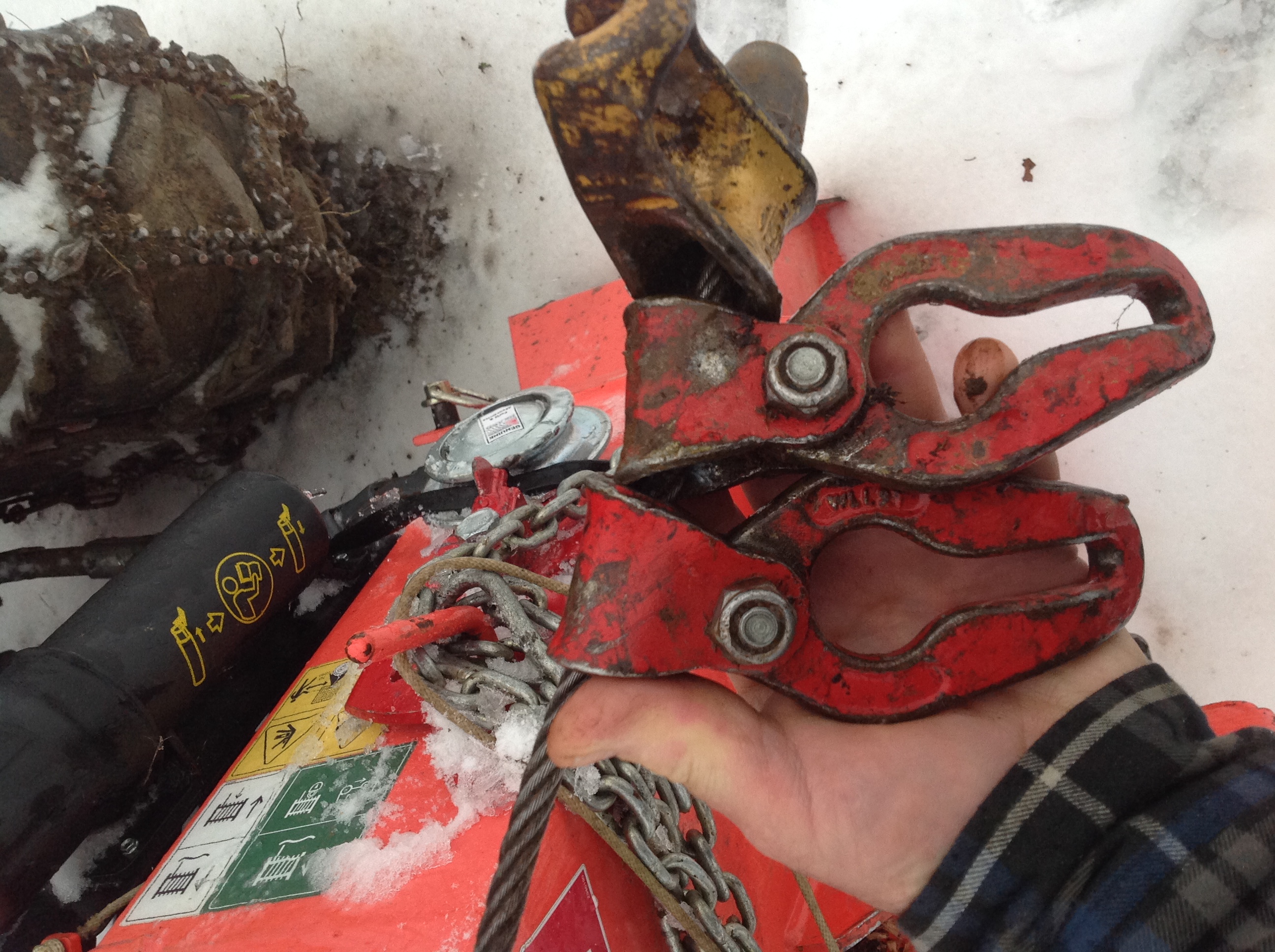

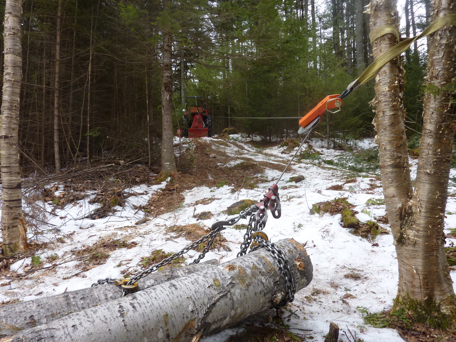

Problem solved. in looking at the picture from Gordon Gould of his hookup I saw the problem. His picture shows a hook on the end of the cable to attach a choker chain to. This gives the chance to hookup 2 or 3 feet from the log and the next chokers slide only as far as the hook. this gives a lead out front of the logs to work the snatch block. Looking at my picture of my cable end and chokers that came with the winch, the cable end has no hook and is actually a cable choker. there is no way to hookup with a lead. So the following 2 choker slides snug right up to the cable choker on the first log and get tangled up in the cluster of log but ends. Only with luck will they hit the snatch block just right to make it work.
So yesterday I put a grab hook on the end and hooked up like in Gordons picture. Everything works fine. Thanks to all who helped me here.

Glad you figured it out. That picture helped you in a way that I would't expect but glad it did !! I certainly can't take any credit. So you are saying that you use the end of your cable as a cable choker by circling the log and putting the knob end into the yellow cable choker slider. I was wondering why you had that on there. Then with the log face right there up tight the two chain choker sliders couldn't fold back the way they should and/or the log hits the snatch block before the sliders do. Must have been an "Ah-Ha moment". Who would of thunk it - as they say.

Yes that is exactly it. My new winch came that way. My old winch had a hook like yours.
Gordon is also using a gravity-assisted self-release snatch block. :)
