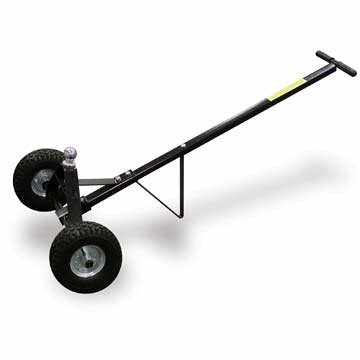

I have one of these and it works well to move from the shed to the woodpile. Might work for you if it's not hilly where you live.
