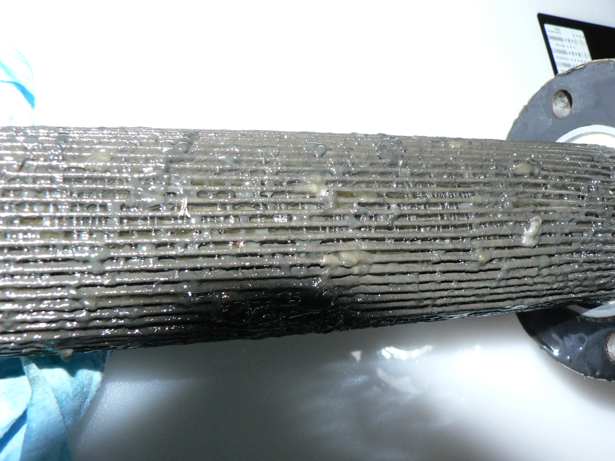

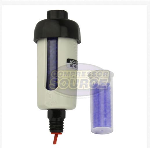

Funny thing is on mine the fluid does not turn milky. It forms some sort of congealed mess that ends up totally clogging the filter screen as shown in the photo. The fluid looks good when drained. I found this cheap, refillable inline filter for $16 with desiccant and I'm going to try and fit it inline with the transmission breather, which is quite small on this tractor at 1/4" NPT. What do I have to lose?
I searched the forum and have read the discussions of changing every 300 hours which I envy. Mine appears to clog based on time. There are no leaks to mention in the system, as I repair them when found. I last changed it 20 hours and 16 months ago and it seems like the hydraulic operation is delayed and jerky. I'm willing to bet when I drain it the filter will look the same. We'll see. I'll drain it after I install the desiccant filter, and see how it goes from there. At 6 gallons a pop and $50, it gets old, but at least it's not that hard to do. Thanks, Dean

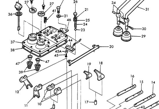

O.K. I've simply done a flush with a mixture of diesel and transmission fluid. Right or wrong, it was done. I have a oil extractor pump which would work well for this. So I assume you pulled the cover on top of the case, requiring you to remove the gear shift levers. If so:
A: How much of a bear is that? Is it pretty straight forward? I was not sure from the diagram how the shift levers attach to the components underneath. I'm guessing it's via a slot or the like in parts 11 & 12.
B: Did you have to replace the large gasket under the plate?
C: Should I order new seals number 47 or anything else in advance? Seems prudent to replace those.
Thanks for the advice, Dean
