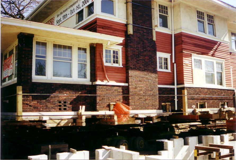

If you agree on a price for the house. The house must first be stripped of brick before it's moved. This lightens it quite a bit. If it has an attached garage, that will be moved separately. The house on the inside will suffer some drywall damage if it's not secured properly. They first strip the house of brick. All electrical and utilities are disconnected. two holes are broken out on each end lengthwise of the foundation . Steel beams are put thru then jacked up and the base area is cleared so the house support beams can be attached to wheel rigs on both ends. It's like building a mobile home frame under the house.

Houses can be moved with the brick still on.

Please share this info how one can pull the foundation out from under a brick wall and it doesn't crack the wall. Houses are sold to be moved in this area all the time. Buyer pays moving fees plus the cost of the dwelling.

Masonry construction buildings are moved all the time. You may choose not to agree.

Check out the link in Moss Road's post #18 to see a large brick building being moved.

Pops, the picture link posted by Moss Road is a building far far greater than 2200 square feet. Do you agree? It appears but inconclusive as to whether the brick walls are supported before moving. It also looks to be done by professionals.

The same company that moved that large brick building in that thread that I linked to also has moved many houses in our area, some with partial brick. I agree, though, that it takes a professional to do it.
