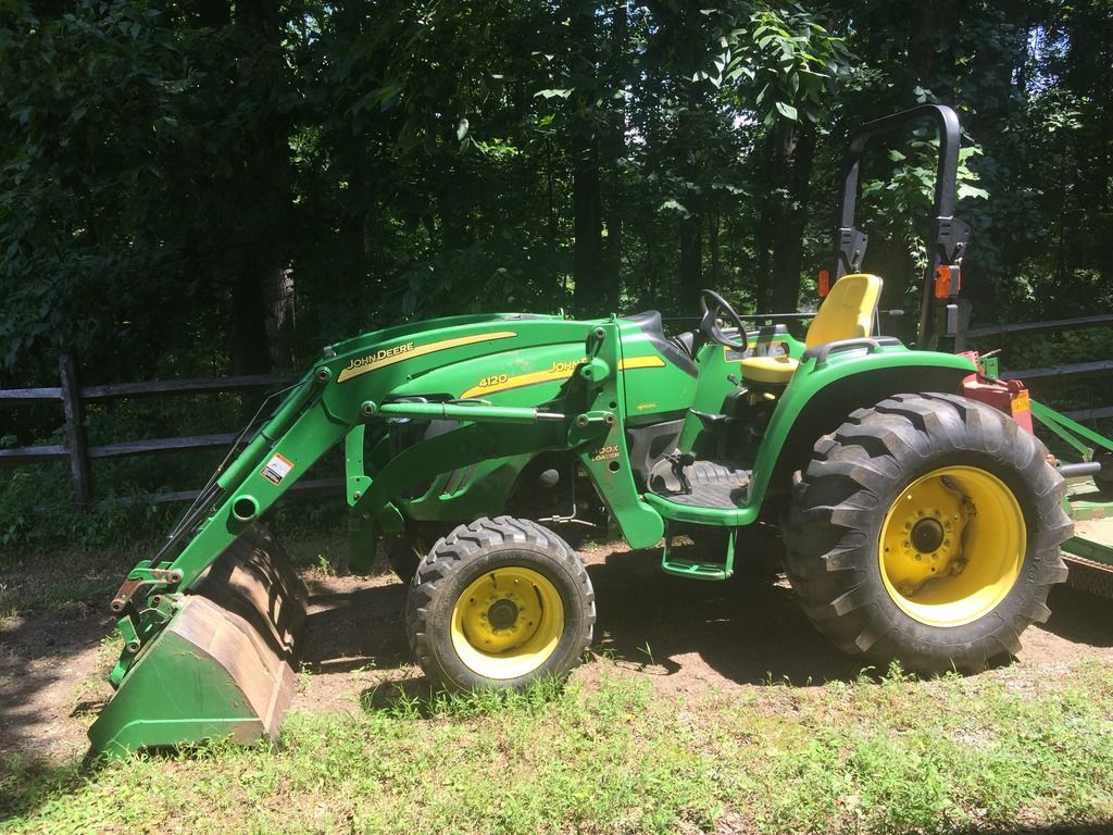

Hard to say a number, but I believe he sees the added value of an integrated package that has demonstrated suitability to the property. You could capitalize on that quite reasonably.
   / Selling the farm, buyer wants the tractor and all the attachments too, how to value? #3
looking at tractorhouse I would say something from 25K - 30K with your attachments

When you say runs hot do you mean runs in the red or does it stay in the green right close to red and stay there.
If it gets close to red and stays there then it is just like every other 4x20 series.
I think it goes into the red, I have seen a "TEMPHI" warning on the display.

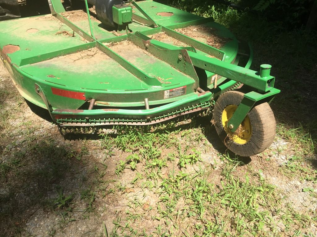

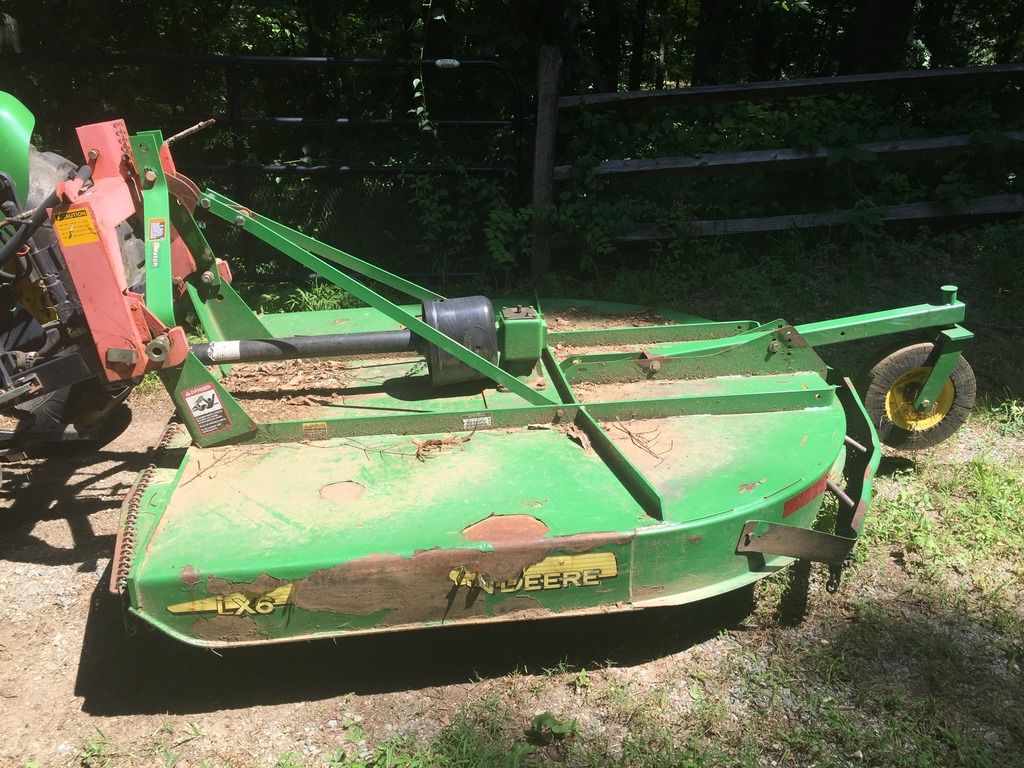

Tractor running hot: Try hosing off the radiator.
Mower slipping in the grass: I see you have a clutch on your mower. The owner's manual on mine states that clutch has to be tightened down as the clutch plates wear down.
Thanks! I figured there might be an adjustment somewhere. If only I could find that manual to get the procedure, lol.
I'll try washing off the radiator.
