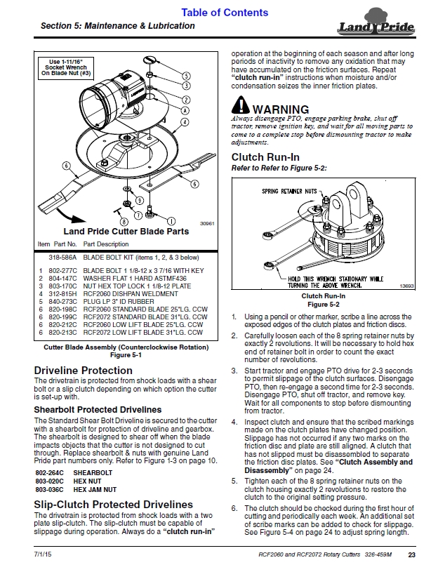

Here is the procedure my LandPride owner's manual shows:
attachment.php
The information in the part called Slip-Clutch Protected Drivelines should be universal to all mowers with slip clutches.
I was talking to the service guy when I was at my Kubota dealership once. He said they don't bother with the measurements, but simply count the threads showing on the bolts. If the clutch is slipping, they snug the bolts down so that 1 extra thread is showing. If it still slips, they do it again until it stops.
