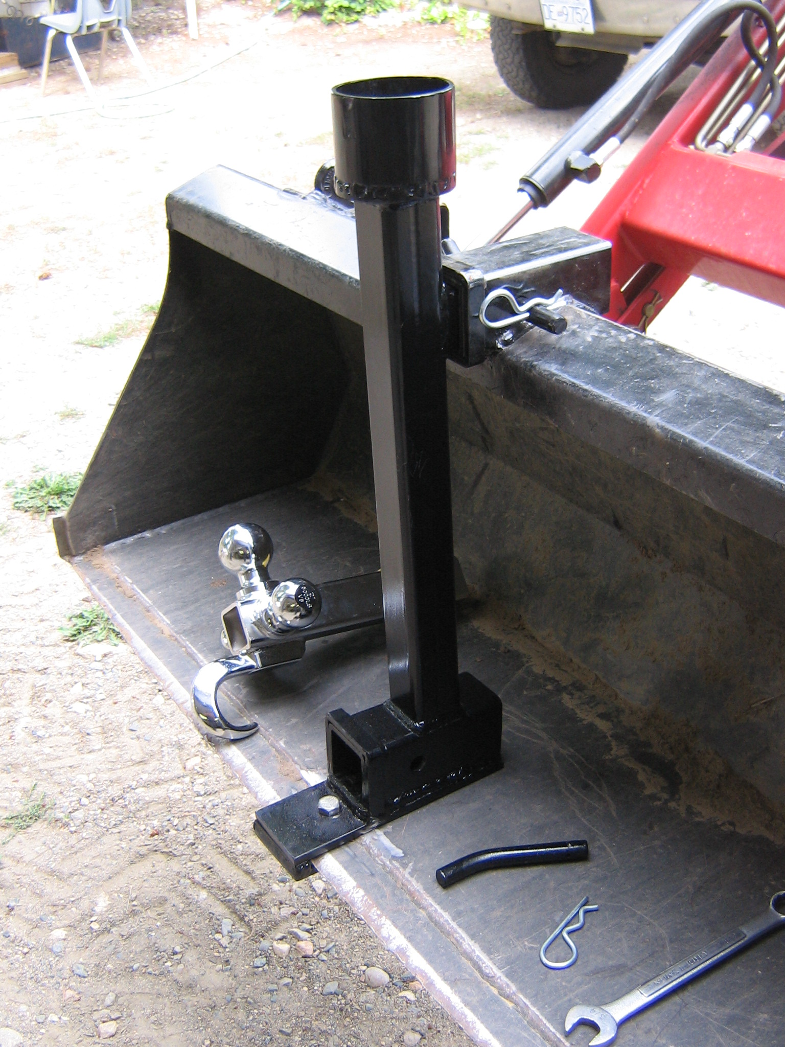

I want to build an attachment to hook on to my skid steer to move my semi trailer around with using my skid steer. My trailer is a 53' step deck. I have tried and my skid steer can pick up the front just fine with the bucket lip under the front edge of the trailer. I would like to be able to maneuver the trailer under a shed which would be virtually impossible to do with my road tractor.
My thoughts are to rig up a glad hand with a valve and a quick coupler so that I can supply air to the trailer and release the brakes. Connect the hose open the valve releasing the brakes and shut the valve and disconnect hose. That part should work.
I was then thinking of either buying a skid steer quick attach plate and starting from scratch or rigging up something that slips on to my pallet forks. Basically all I need is a plate with a hole in it for the king pin. It is as a flat as a pancake here and I don't plan on moving it at more than a walking speed. My only concern is the kingpin is set back a bit on the trailer so this attachment will be a bit in front of the the loader which increases leverage. Might make it a bit tippy. Anyone ever built anything like this?

Local semi-truck repair place here uses a dolly type device under the trailer (like you see under the front of the second trailer on a dual trailer setup) that has a pintle hitch on the front. They use a SSQA adapter they put a pintle hitch on and move trailers all over their lot. They have an air tank on the roof of the skidsteer, I assume to unlock the brakes.

Some ideas:
From:
http://www.tractorbynet.com/forums/...es-modifications-post2983537.html#post2983537
Bruce

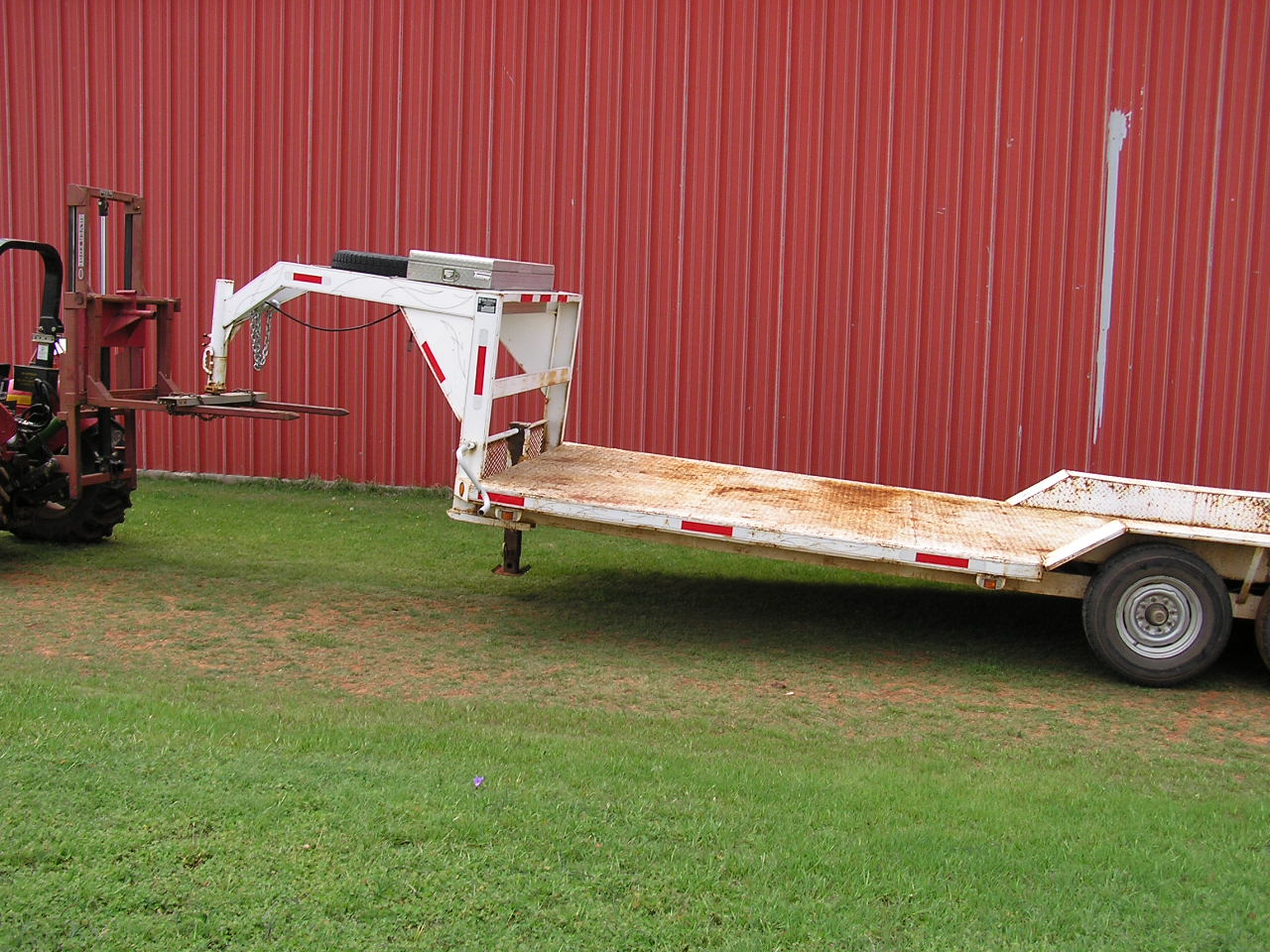

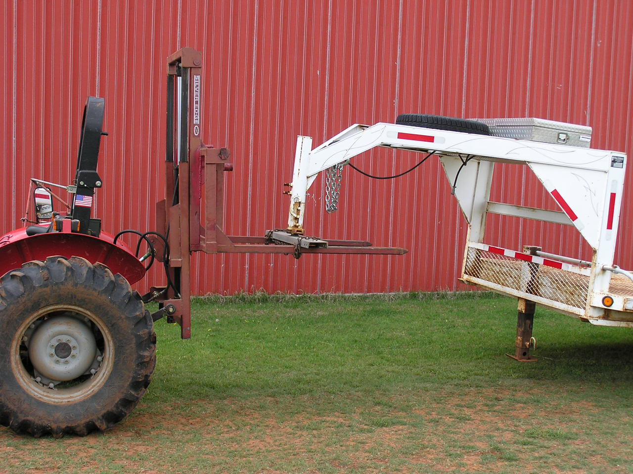

"Back in the day", I used a piece of channel iron on the fork lift attachment, to move the gooseneck trailer.
You should be able to do something similar for the king pin.
From April/2004:
/ Semi trailer mover #7
Do you have a set of pallet forks? I made a fairly simple piece similar to the one Xfaxman posted that goes on my forklift to move a gooseneck trailer. My forklift pushes a trailer around way more accurately than can be done with a vehicle.
